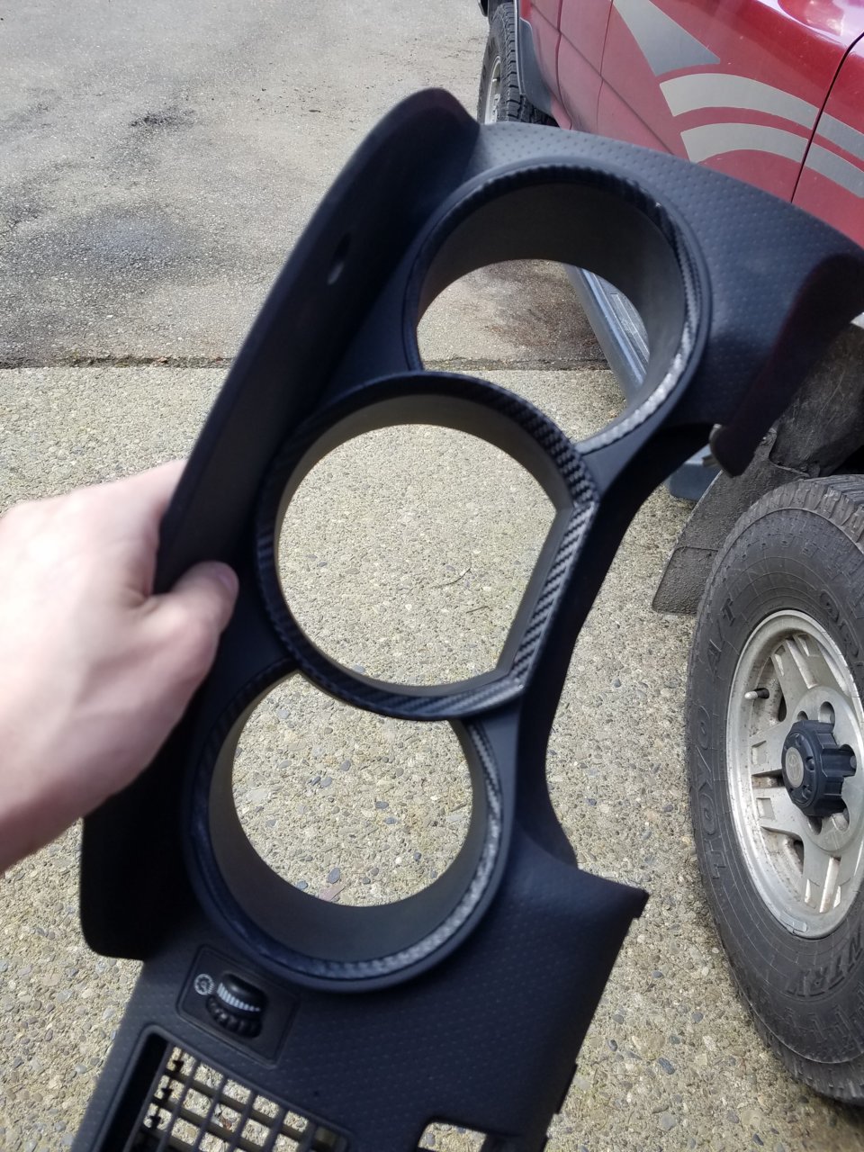

    I've used wrap. Wipe down with alcohol, slap it on, trim it, done. Looks better than paint, and it's easier to remove

    None of my center console but its wrapped in the same stuff as this is. Yes 3m, it's the best wrap imo
