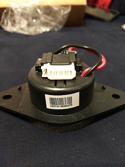

    I had the quest to find out if this can be done and yes it can. Easy to do.
    Parts:

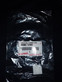

    Toyota connector 90980-12304 x2
    Toyota tweeter adapter harness. Purchase from ********* or anywhere you want. I bought mine from a harness supplier I use. I don't have a non JBL system to know if the harness I have will fit the non JBL systems. But it might. If someone can attach a pic of thiers, might can match it up.
    Female terminals: https://www.bmotorsports.com/shop/product_info.php/products_id/1567
    Good crimping skills :rofl:

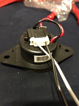

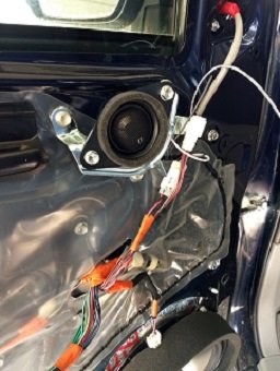

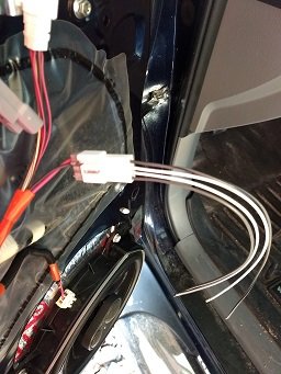

    The Subaru tweeters have the wires to what looks like pin 1 and 4 of the tweeter. So that's how I connected mine and it worked. 2nd gen JBL systems only have 2 wires. The adapter harness I have has 4 wires.
    Toyota connector
    Adapter harness
    Checking if connector fits
    Next was wiring up new connector to the adapter harness
    Finished

    If you have the wire harness from autoharnesswarehouse, you just crimp the pins on the outer 2 wires to the Toyota connector and plug into the tweeter.

    So basically you take the 2 inner wires of harness and crimp them to the outer ones? am i correct?
  12. Jun 21, 2020 at 6:18 PM
    bear263
    bear263 [OP] Well-Known Member
    Sep 25, 2012
    #87716
    669
    Florida
    2013 PreRunner TRD SP
    LED interior lights. Steering wheel mod. New radio. Amp, speakers and sub woofer.
    Yes.

    Does this mean that there are two wires on the harness that will not be used?
    (Middle two)
  14. Jul 13, 2020 at 4:01 AM
    bear263
    Sep 25, 2012
    #87716
    669
    Florida
    Yes.
