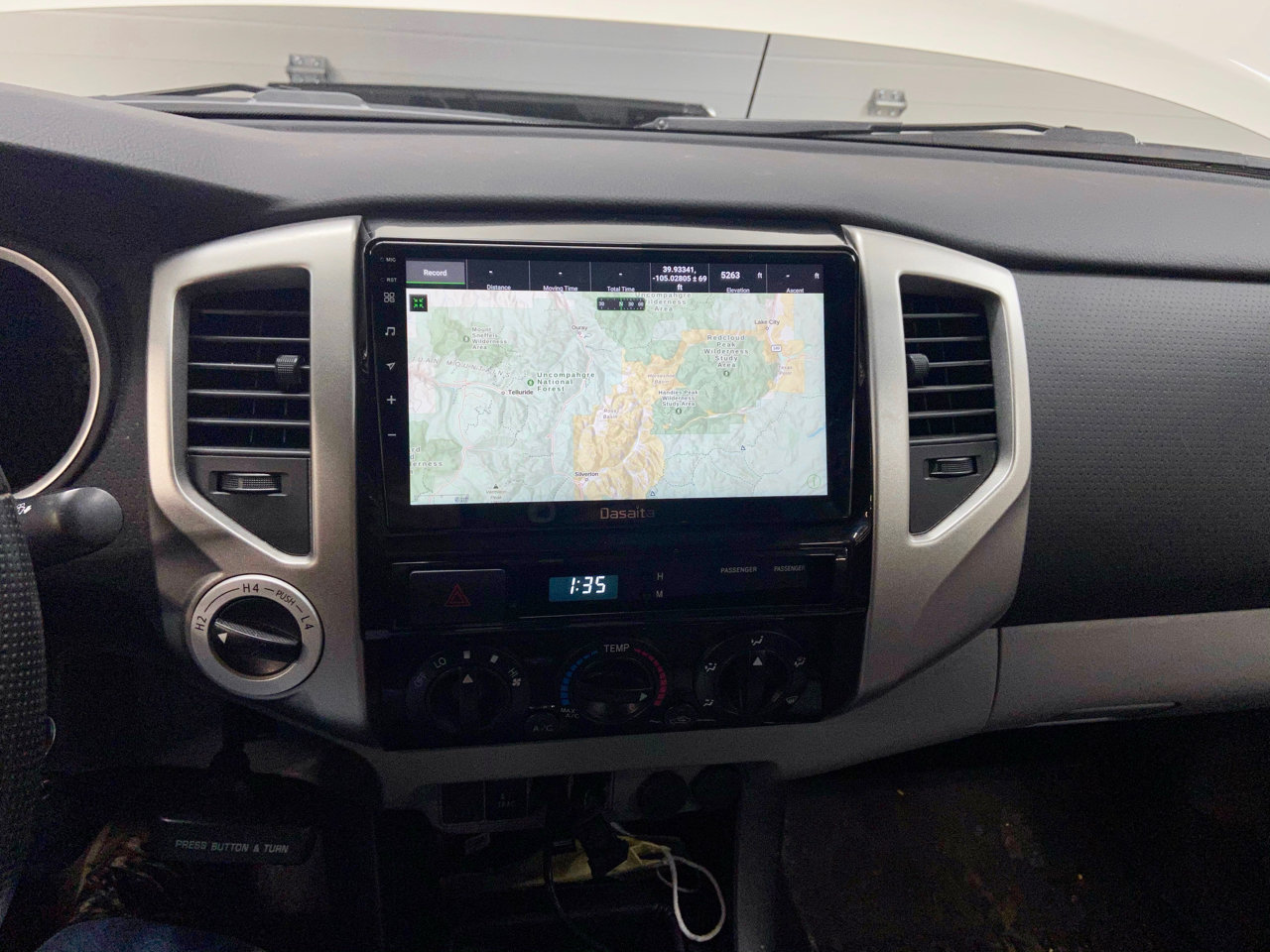

    I didn't see anything on here for this stereo. I just put it in mine so I thought I'd make a thread with my thoughts on it and for people to ask questions. And for people needing help on install. IMG_9598.HEIC.jpg
    In short, it's the bomb. way nicer and higher res than most of the android head units I've seen. Runs CarPlay, and you can put full feature Gaia GPS on it. You can also make it look pretty much however you want with some third party apps.

    I like how yours has actual knobs. I just installed a Dasaita unit in mine. So far I really like it. Definitely not a polished headunit like a Kenwood or Pioneer but very functional. I really like the big screen and the ability to run Gaia maps or any android mapping software offroad.
    My Dasaita did not need any wiring changes, just plug it in. I did have a hassle with the hazard button and clock area on my 2.5 gen. I had to buy a stock stereo from a pre-2011 truck and get the hazard bracket to make it work.

    The ZLink app on my Dasaita does, completely wireless Apple Carplay
    It had an additional GPS antenna, although I just stuck it to the top of the unit and shoved it all in the dash. Works great.

    I didn't have the factory touchscreen. so I didn't have one to start with. But I just put the one that came with it under the dash. It wedged in behind it pretty tight and I put some double sided tape on for good measure. It seems to work great there.

    Ya, the knobs are a big reason I went with this one over the Dasaita. And no branding. Looks a little more OEM. I defiantly like the customization and utility that come with android though. The hazard bracket was already in the bezel on this one and clicked right in.

    I took off the pillar, fished it under the dash and up to the stock mic location. Seems to sound better without the foam wind protector thing. There's an internal mic too. But I haven't tested it.

    Comes with the bezel. The steering wheel controls work. You just have to go to the menu and set everything to the function you want. I took the cover off the stock USB/Aux and ran the two USB extenders that come with it down there. I dremeled out the cover so I could add the second one. Then I hot glued the two female USB's to the back.
