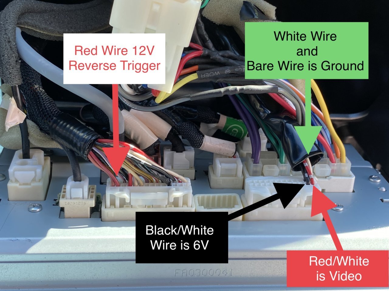

    Just wondering if you powered the camera off of the 12v Key Switched Wire or the 12v Reverse Signal Wire. I am thinking of going off the 12v Reverse Signal Wire so the camera isn't running the entire time. I will probably pull the radio out tomorrow to start probing pins. I am thinking of using this wire harness so I can go back to stock https://www.amazon.com/RED-WOLF-T-H...8f73&pd_rd_wg=amHRf&ref_=pd_gw_pd_cart_vw_crc

    That harness is basically what the Anytime Backup Camera kit comes with, except it doesn't have the power and ground wire coming off it. I just added 12v to the black wire on the Truck side. But I think I did switched 12v, and not the reverse trigger wire. That's a good point to not have the camera running all the time.

    Probed around the back of the radio and found that the camera is powered by 6 Volts. From the video and some of you it looks like your able to run it off of 12 Volts too. Either way I order a step down and will power it off the 12v Reverse Trigger as it seems to be the industry standard. I order the Headunit and just awaiting its arrival.

    Most of my connections look the same, but wires in the camera harness are different. Mine are: Shielded Black is: Video + White is Video - and Solid Black is 12v. None of mine have the white markings on them.
    Will add a Picture next time I pull it out.
