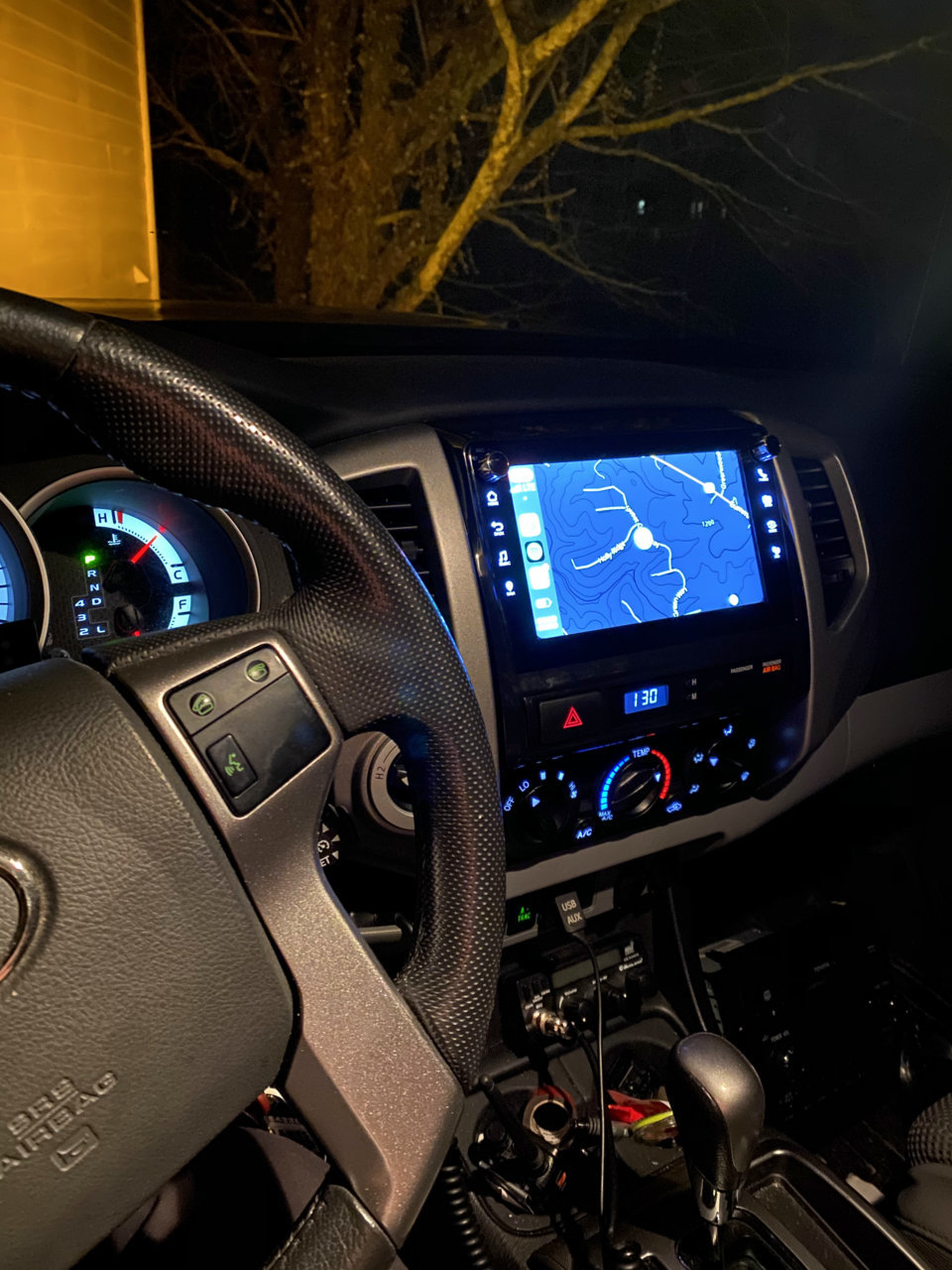

    Bought the Joying head unit because of your thread and video. I was surprised how easy this radio was to install, I'm not used to plug and play radio wiring harnesses, I didn't even need any extra wiring for the steering wheel controls. Appreciate the post man. I bought the 9'' model without knobs. As a bonus it also sounds better than the alpine I had installed before, seems to be a decent audio driver in the Joying units.
    The head unit looks like it was meant to be from the factory.

    Looks great. I like your hazard, no clock.

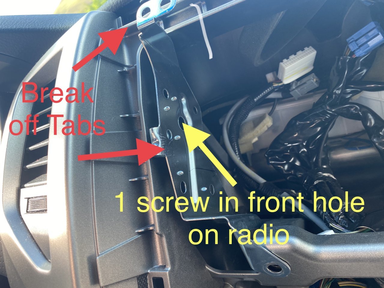

    2014 DCSB PreRunner SR5
    Joying 9" in a 2014 Tacoma Entune Non JBL.
    Everything is fine. My Center, Left, Right and Back buttons don’t work on the steering wheel. Don’t miss them yet as I don’t really remember using them before.
    My subwoofer is not working. I have power to it. The 12v trigger works but no Audio. It could be that I forgot to plug the RCA in because……..
    What a pain in the ass to mount the stupid ass radio. I want to save anyone else the hassle and see the photo below. Basically I was only able to get one screw per a side in the large hole and had to cut off the 4 tabs. After that everything went great. But because of the in and out I may have forgotten 1 RCA cable.
    The sound is 20x better with stock speakers.
    Car Play works great and if you update carlink you can have wireless android auto as of 5 days ago.
    The head unit is snappy and responsive. I look forward to customizing it. I am super happy with it especially for the amount of money. When my USB adapter shows up I will check the RCA and hunt down that problem. Just need a few days playing than installing.
