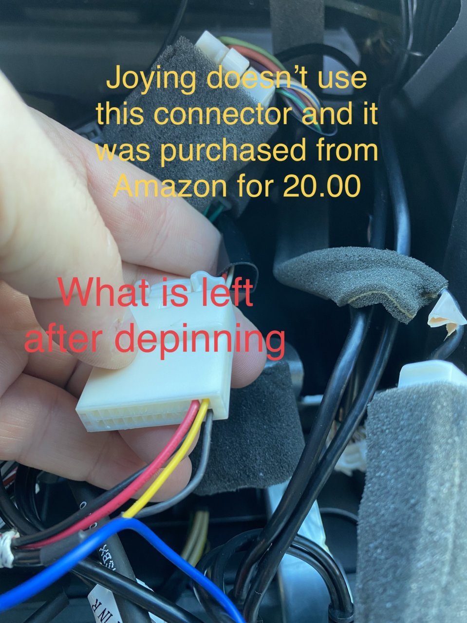

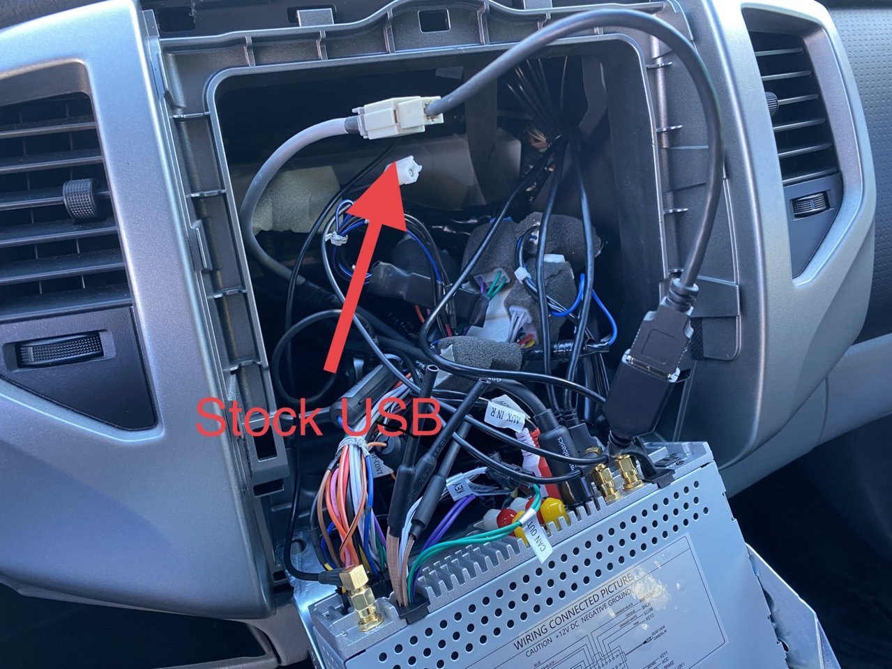

    Hey whats the cable you used to break out the USB and Audio from the stock location? I have the same setup as you basically
