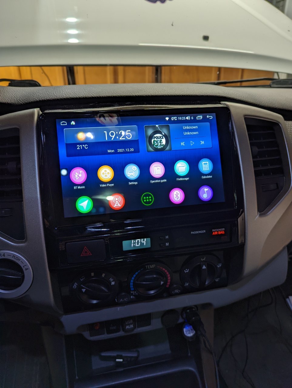

    All installed. Was surprised that it came with a factory usb, and factory backup cam connections! The USB dash cam is nice. Can't wait for the road trip Thursday, now!

    Hell yeah, no cutting, splicing or ordering! Did you happen to take a picture of the harness for others?

    Not really. Rush job for road trip

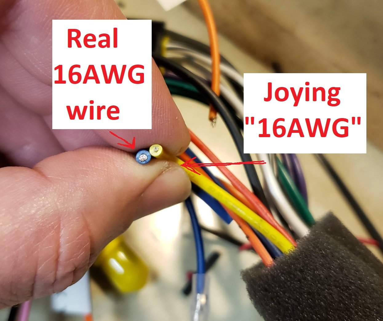

    Pulled the trigger on one of these for Christmas... I had already ordered the Dasaita last month, but before it shipped I learned that its SD card slot isn't accessible without removing the dash. It's literally on the side of the radio, where the brackets go. Who thought that was a good idea? Perhaps they'd also design a car without a fuel filler... just drop the tank to refuel. Anyway I cancelled the Dasaita and ordered the Joying instead, currently mid install, but wanted to take a break to rant...
    God, the gloss black is so awful! I didn't think it would bother me that much, but when I unpacked it, I decided I would have to paint it. First I thought I'd see if my exterior touch-up paint would be a good match to the gray-silver dash...
    The answer is: definitely not! What a terrible idea...
    I hit it with good ol flat black instead, and it looks a million times better now.
    Then I started hacking up the wiring harness for my application and found this: All the wires are fake!
    Here's the main power wire, clearly labeled 16AWG, and thick enough to look it.
    But if you cut it, it's a 20 gauge conductor at best, with stupidly thick insulation and blatantly false labelling, for the sole purpose of deceiving us. The blue wire I'm holding next to it is real 16ga wire. The speaker output wire looks like 22ga or smaller!
    Look, I know we're buying cheap electronics from communist China, none of us expect quality. I wish they would just cut the bullshit already.
    Build the harness with 20 gauge wire, see if I care. I'm still going to buy it. There is no need to make special fake wire here. Just boils my blood.

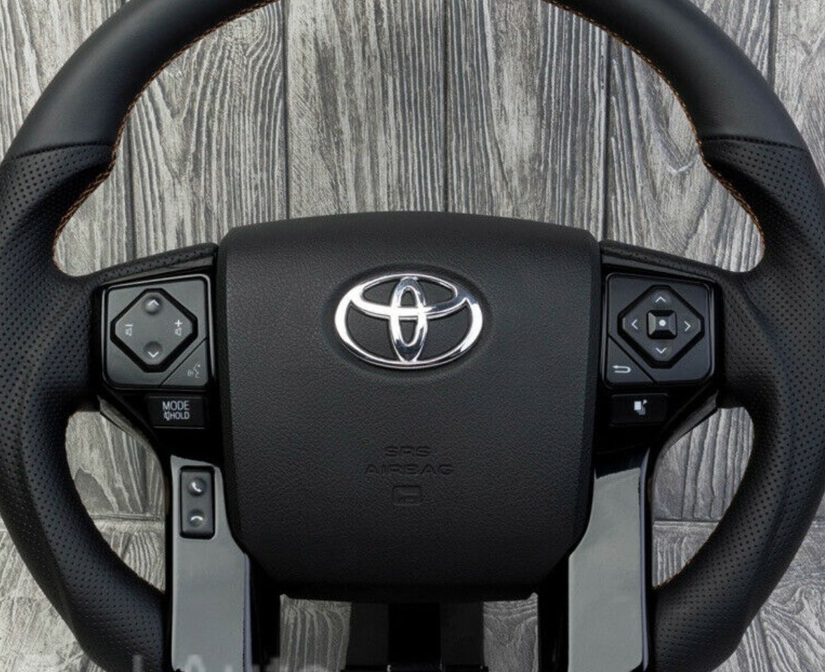

    I should clarify. Anyone get the JBL version and have this steering wheel: upload_2021-12-21_17-26-40.jpg
    and get all the buttons to work?

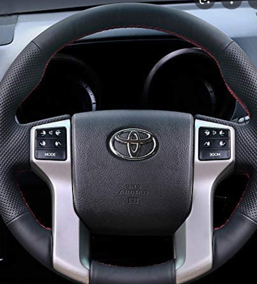

    Or this:
