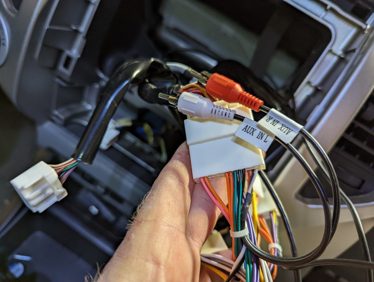

    On mine I plugged those 2 RCAs into the head unit in and my Factory Aux In worked.

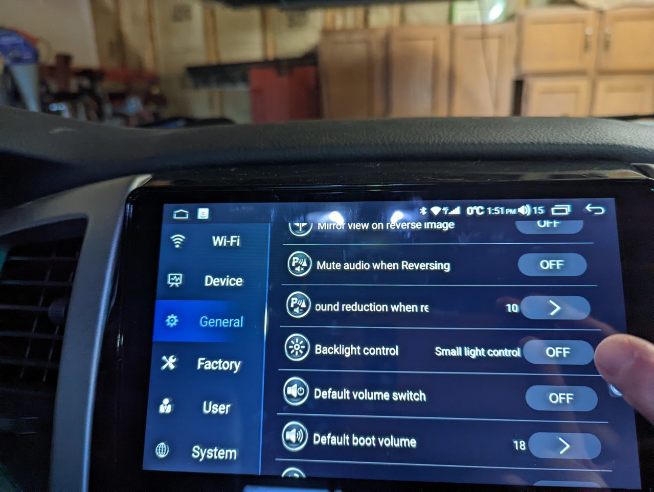

    My night mode or auto brightness isn't working, though. Like when I turn my headlights on, the screen doesn't auto dim. What's the fix?

    Never figured out the auto brightness. I checked all the settings but it never auto dimmed. It does have an auto screen off but not what I was looking for. I ended up using Android auto and hard set the map to night mode

    I just found the setting for auto dim!! Stupid place for it but see pic. Set it to Small light control instead of the default time control (which seemed to not work). But tested small light and it dims with headlights now.

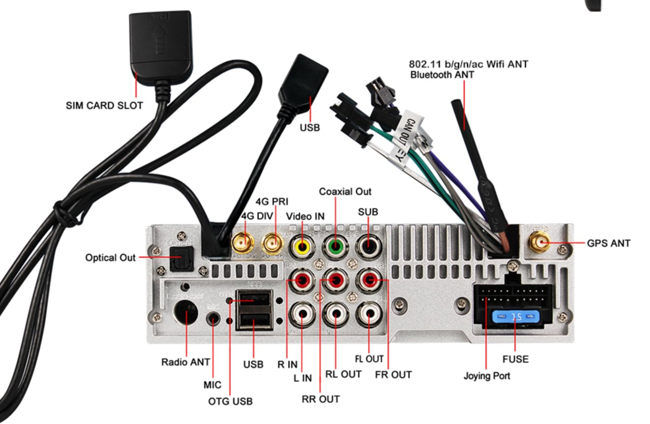

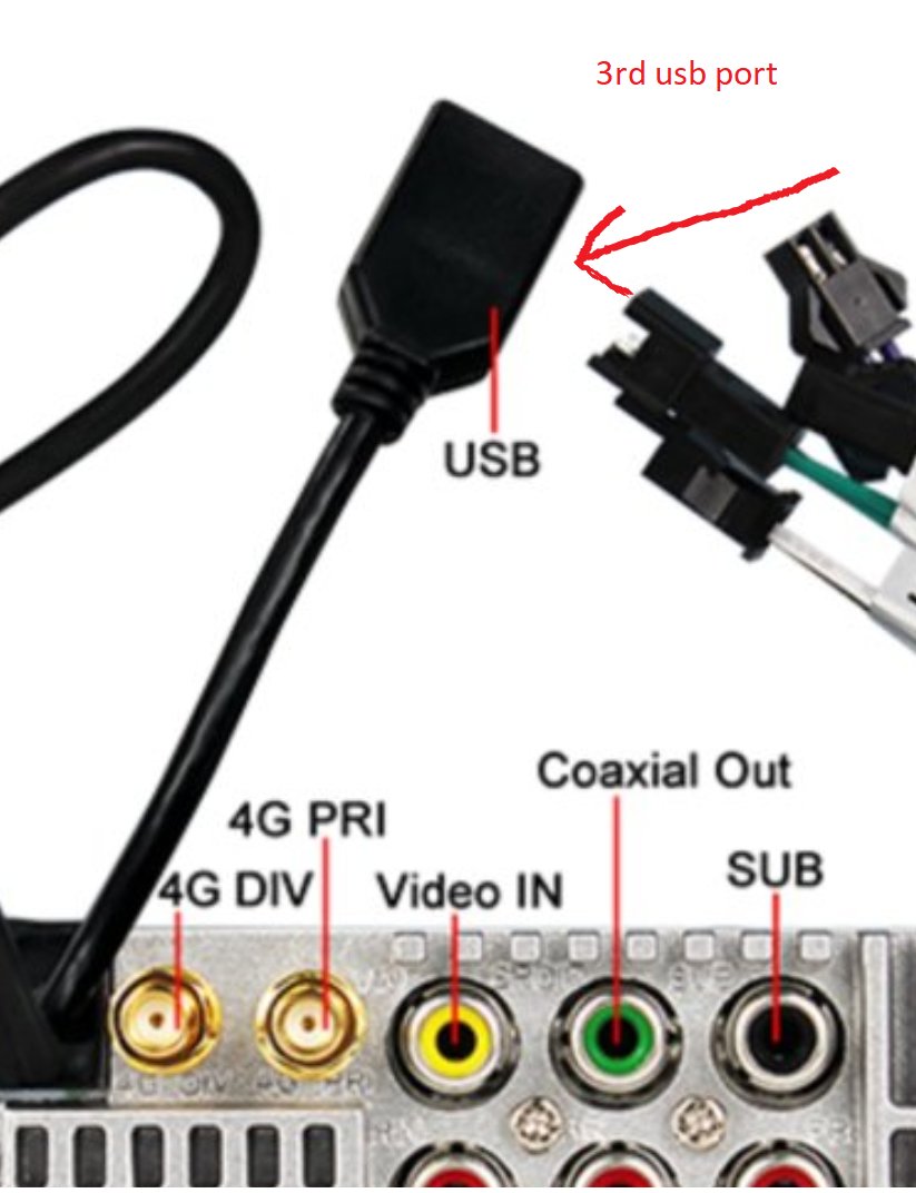

    My unit arrived a day early. I ordered the 8" with knobs, but the instructions, what there were of them, were for the 9" screen. The unit I received differs from the unit online in one respect, there is an extra USB dongle coming out the same hole as the sim card slot cable....

    I attached the USB dash cam to that and it worked. OTG USB port is for your phone. The third USB port I plugged in the tpms sensor

    I'll answer my own question. The unit came with "can out" plugged into "can in". "can out" must be plugged into "key" for SWC to work.
