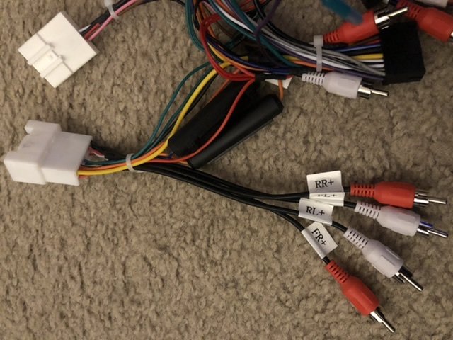

    Need some help with install:
    I have a 2010 with JBL system and I purchased the 8" Joying Unit with CANBUS connection.
    1) Do I need to connect the two 4G antennas if i am not using the 4G LTE SIM card for data?
    2) Currently, only two RCA's from the harness provides me audio: FL/FR..... none of the other 4RCA's provide sound. When messing with the sound output, if i set the sound to all rear speakers, i get no sound. Meaning, i can only adjust L/R sound and no F/R. What RCA's do i need to hook up in order to control all speakers individually? Also, the Subwoofer control settings does nothing.
    3) MAX volume isn't all that loud. I have the loud setting set to ON. Am i missing something?
    4) I have two of the large white harness connected, is that all that's needed?
    5) SWC only works if i program the buttons within the settings? I thought buying the CANBUS makes it plug and play once its all connected?
  13. Jan 4, 2022 at 6:40 PM
    #453
    fizik
    fizik Accidental Offroader
    Jan 7, 2015
    #145816
    177
    Minnesota
    '13 DCSB SR5, '10 DCSB TRD OffRoad (deceased)
    1) No, you don't need them connected if you aren't using a cellular SIM card. I did not connect mine.
    2) Are you using a 3rd party amplifier? If so, then use the outputs on the back of the HU, not the ones from the harness. If you aren't using an amplifier, then it should just use the speaker connections from the plugs. Also, there are some settings you MIGHT need to change (not sure, don't use an amp) to indicate that you are using an AMP and a subwoofer. I'll see if I can find them and post where they are.
    3) Not using an AMP and it was plenty loud for me. I did replace my speakers back in November (installed the joying last week), so I'm not using the stock speakers.
    4) Everything that you unplugged from your old head unit should be plugged into the Joying harness or the back of the Joying head unit. Sounds like you might have missed a plug. Can you provide us a pic of the back of the old HU and a pic of the connectors on the Joying harness?
    5) Make sure CAN OUT is plugged into CAN IN. Yes, you do have to map the buttons after you install the unit. You should only have to do it once, though.

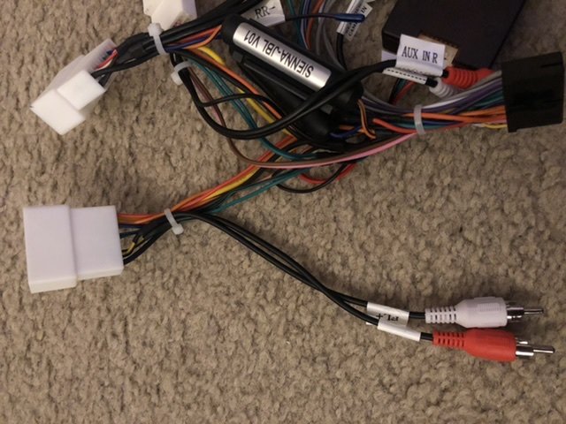

    2) I have no external sub/amp, other than the stock JBL sub/amp. The Joying has two harnesses that i can use to plug into the truck, one with two RCA's, and the other with four RCA's. The only way for me to get sound is to plug in a pair of those RCA's from one of the Joying harness.
    8CF9CA13-137B-4CB7-8D04-BD3CEF9D6745.jpg 1F5FCC64-3820-47A3-816B-55673AD1686C.jpg
    3) There is a menu within the setting for audio input balancing, and i can max out each input device volume. I guess this works but it still can't get as loud (not necessarily better but loud) as OEM.
    5) The only way for my SWC to work is to do CAN OUT plugged into KEY. Programming the buttons work when i do it this way. I just thought it would work right off the bat.

    If I dont need to connect any RCA's, then i think they sent me the wrong wiring harness.
    Did any of you need to connect the RCA's to get sound from your stock JBL radio?

    Your pictures don't show all of the harness(es). Could you show us pics that show the complete harness. Also, can you post a pic of the back of the Joying head unit? Could you also send us a pic of the back of your factory head unit so we get an idea of the factory connectors you have in the Tacoma? You did order the unit specific to the Tacoma, right? The head units themselves are the same, but the wiring harnesses and fascia are specific to the model you order it for.
    Did they send you two different wiring harnesses?

    This is the harness they sent me. I am assuming I would use plug #2 with the two RCA's:
    https://www.joyingauto.com/blog/pos...nd-which-harness-recommended-to-be-connected/

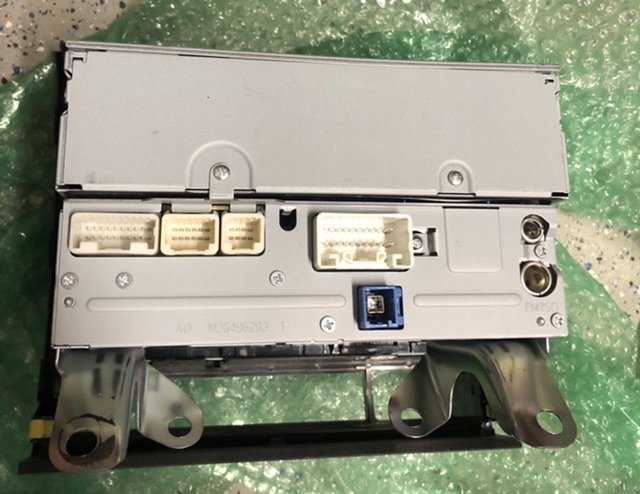

    Back of the HU:

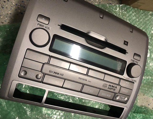

    and this is my oem radio:
    9544DCF0-D4D4-4CF6-8317-5F6D9398FAD6.jpg 7DE27D6E-6ED9-4C57-BF4B-74718EA49019.jpg

    Yeah, I think they sent you the wrong wiring harness. You should send them those pictures of the front and back of the HU, so they can make sure they send you the correct one. The harness they sent you doesn't have connectors for the 2nd and 3rd white sockets from the left.
    I had that same HU in my 2010, but I never replaced it. Except mine wasn't JBL (odd since it had the TRD OR package).
