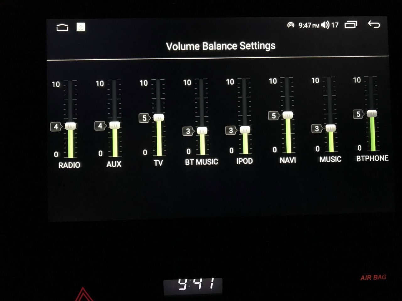

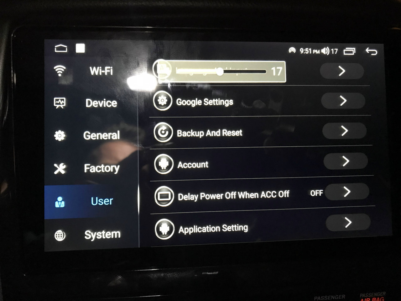

    I thought I found the volume adjust jackpot but it didn't do anything to the ringer volume of incoming calls. I lowered every setting to 0 to see if either the built-in BT phone or Carlink Apple Carplay phone were linked to something other than BTPhone, but nope. Only way to adjust the incoming call is to lower the volume on the slider, but even then it only seems to stay low half the time. Also, I would want it up for music anyways. Went through practically every setting menu.

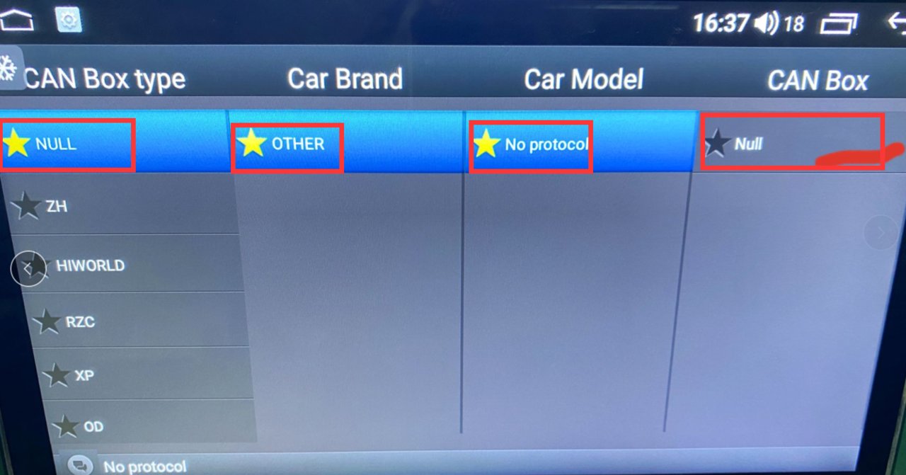

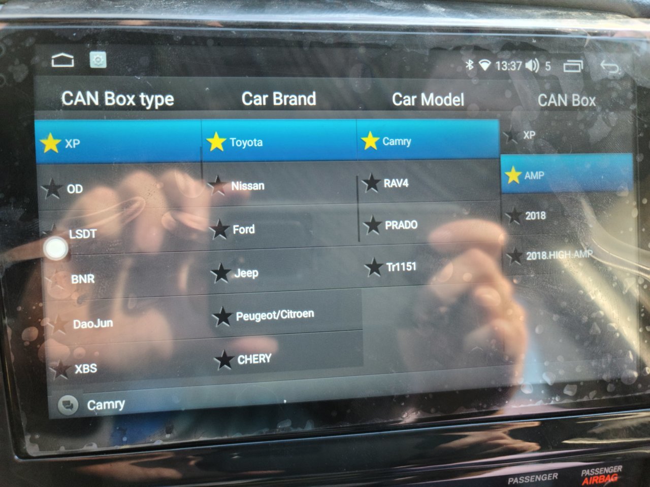

    I have also tried a bunch of different vehicle settings, and I have found that a few have all the speakers work, but then volume control and the fader do not work. I have attached a picture of one of those settings.

    I think I found it... Settings -> System -> Developer -> Disable Absolute Volume .
    Ringer is not as loud after that.

    Try this CANBUS setting yet? This is suppose to work.
