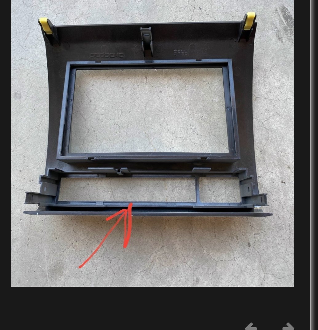

    1. For those of you referencing the "clips" for putting the head unit in without the bracket/screws ... mine does not snap into place at all ... are you all just leaving it floating there and depending on the angle to keep it from popping out? that seems un-safe?

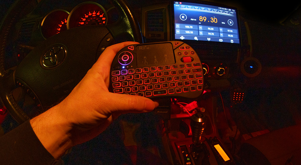

    3. Bluetooth sucks. This one is well-known: Joying head units don't have a proper bluetooth stack, never have and probably never will. Only cellphones and certain Joying accessories (such as OBDII) are supported. But I was really hoping though that my compact bluetooth keyboard would work. I mean, it's just a keyboard, right? Wrong. Not even a keyboard is supported! Typing on the screen sucks, and doing it for hours on end (e.g., when setting up the unit after a factory reset) will have you wishing for a chiropractor... so I really wanted a functional wireless keyboard for this head unit.
    My old bluetooth keyboard, it was perfect. (It was charging in the photo, not normally wired to anything.) Also shown: my cat.
    Tip for other users: To use an external keyboard and/or mouse, you will need one with a USB interface. This is too bad, because it eats up a USB port, and also, my favorite type of compact keyboard (shown above) is only available with bluetooth. It was extremely thin but had proper key spacing for high-speed typing. Plus it lit up. USB keybards seem to be much bulkier, and I can't find an adult-sized USB keyboard that will still tuck away in my console. But I found an okay alternative:
    USB wireless thumb-keyboard device
    This one is too small for real typing, but with actual physical buttons rather than a stupid piece of glass, I can still thumb-mash words a lot faster than on a cellphone screen. Plus it has lots of extra buttons such as volume control, play/pause, and a scroll wheel. Finally, it has a touchpad, not a particularly good one, but it works well enough to operate all aspects of the head unit from the comfort of the seat, rather than straining forward to reach the stupid touch screen. Oh, and it lights up too!
    Plea to Joying: Stop ignoring your customer base and add full bluetooth functionality to your devices!

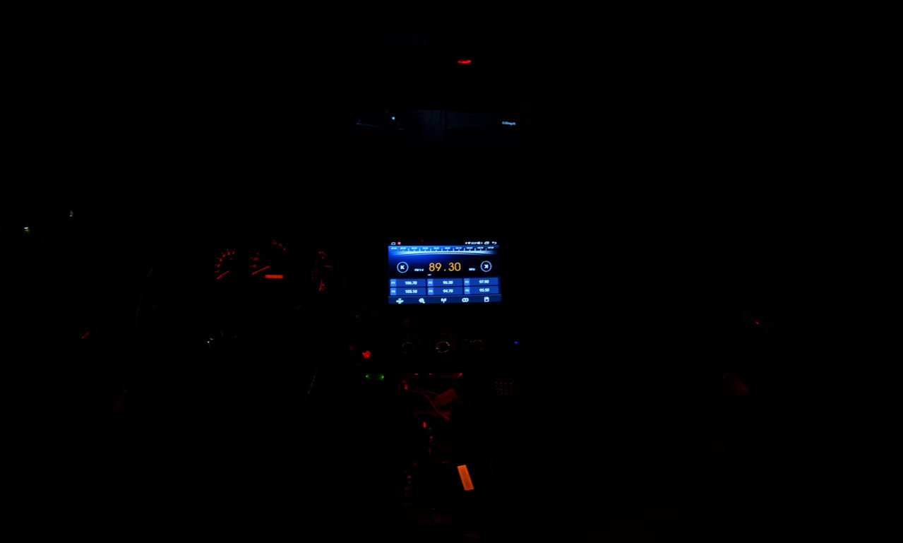

    4. The display is too damn bright! This one should be #1 on the list really, but I've got a passable workaround for now... The display on this thing, even when set to 0 brightness (that's zero--as low as it goes) is ridiculously, obnoxiously, dangerously too bright for night driving! Here's an undoctored photo (well except for blocking out the view of my chaotic garage through the windows) of the display at night. My parking lights are ON here, which does indeed dim the display (to zero, as I have it set), but it is still this bright. My dash lights are turned up to maximum brightness. The photo looks underexposed, but I specifically exposed it so that the brightest part of the Joying screen is 100% white in this image. (Normally a camera will overexpose the brightest part of a picture, to give you a better view of the dimmer parts.) So this is an actual comparison of how bright the Joying screen really is, again at zero brightness, compared to the rest of my dash at night. (I happened to pick the shitty radio tuner app for the photo, which is a fairly dark UI with a small amounts of white text. Displaying something with more white, such as a topo map, is utterly blinding!)
    Ridiculous! Compare this to the photo of my old head unit above (the one with the cat!)
    I'm at a loss here, there is absolutely no reason to have such a high minimum brightness automotive LCD. It is stupid and dangerous. At the upper center of a photo is a bit of dim white text, if you look close you will see "0.0 mph". That is also an LCD--a rearview-mirror-integrated dashcam with backup camera. It is displaying a perfectly clear and non-blinding image from the camera in my rear bumper. You just can't see it because of how insanely fucking bright the Joying display is.

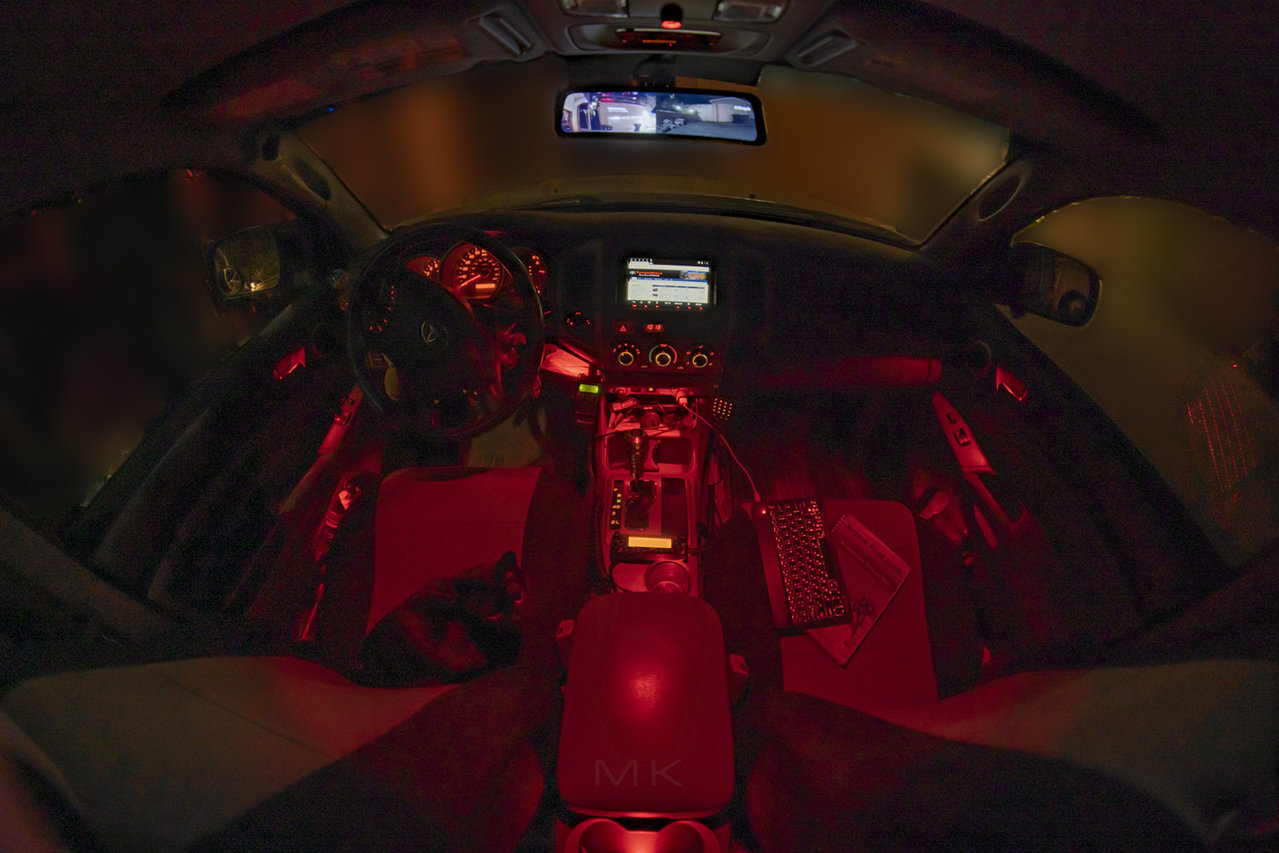

    Here is the same exposure, but with the EV set to +5 in darkroom. That means everything is 32x brighter. (That's why it looks so grainy too.)
    Same image, 32x brighter
    As you can see, I have a pretty well-lit cab at night. I have foolishly installed little red LEDs all over the place--in the cupholders, door handles, cubbies, etc. Plus, there's a particularly bright always-on red overhead map light. That's right, I have a red light that's bright enough for reading installed in the overhead light assembly, and I find it so non-irritating for night driving that I didn't even install a switch to turn it off. None of this interferes with night driving. What does is this stupid Joying head unit with it's gigantic blinding display, which again, is set to zero brightness, yet is 32x brighter than the brightest pixel in the above image.
    To offer reasonable brightness compared to the rest of my dash at maximum brightness, the Joying minimum brightness should be 50x lower than its present lowest ("zero") setting!
    So how the hell are you supposed to drive at night, other than by turning the whole head unit off? Well what I've settled on for now is an app called Night Owl, which dims the display to an acceptable level at the click of an icon on the home screen. There are many others like it, I tried several, and this one sucked the least. It is adequate but not ideal for two reasons: First, it has to be done manually, rather than dimming automatically with the headlights. I do have the headlight illumination wire connected to the head unit, and the display does indeed dim when I turn them on, but because that's still 50x too bright, I have to manually dim it the rest of the way with this app. Second, the Night Owl app achieves the dimming mostly if not entirely in software (e.g. as an overlay), rather than actually reducing the LCD backlight brightness. So the range of adjustment is limited, and the display contrast and readability degrade substantially at the required darkness levels.
    Without getting into too much detail, LCDs are basically rectangles of uniform white light (the "backlight") covered by an array of tiny "valves" (pixels) that control how much light gets through to the front, forming an image. Each valve can go from open to closed in 256 steps. The highest step, 255, is the maximum brightness, i.e., white (actually red, green, or blue, but that's irrelevant here), and the lowest, 0, is the minimum or black. But even when fully closed, the valves still leak a bit of light. We are all familiar with cheap LCD screens, and how they still glow gray even when the image fades to black. In the early days of flat-screen displays, plasma TVs had a huge advantage over LCDs, just because they didn't look like stupid glowing gray rectangles when movies faded to black. LCD manufacturers have worked to improve the quality of the valves, so that they wouldn't leak as much, but even the best ones still leak some amount of light. To really solve the "fade to black" problem, they figured out that they could dim the backlight depending on the content of the image displayed. Only then could LCDs truly fade to black, or show dim images without looking like stupid washed-out gray rectangles.
    Unfortunately the backlight in the Joying head unit is 50x too bright at its lowest setting, so we are stuck in the obnoxious gray glowing rectangle regime no matter what. But software such as Night Owl can still dim the image, by preventing the LCD valves from opening as much. Normally, for full brightness, images would be displayed using the full range (256 steps) of each valve, but when dimmed, the valves are limited to a lower range of values. Let's say we wanted to properly darken the display by a factor of 50. Then, images could only be displayed using the lowest 256/50 = 5 steps for each valve! Computers in the 1980s had better color depth than that! And those 5 steps provide very little contrast, since even the lowest step (0) is a dull obnoxious gray glow. The usable dimming ratio is a lot less than 50x! So while Night Owl does prevent the Joying display from blinding me at night, it does so at the cost of contrast and image quality, and doesn't fix the problem of having a gigantic obnoxiously glowing rectangle in my field of view at all times, and I still wish I could dim it further. Even manually dimmed, it is by far the brightest thing in my cab. What's so infuriating though is that this is a trivial problem to solve -- just turn down the fucking backlight!
    I'm not claiming to be an expert on this... perhaps there are ways to further reduce the backlight, and I'm just throwing a tantrum over my own ineptitude here. (In which case please let me know!) But my brief research suggests this would require the system to be rooted, and I can't find specific evidence that it's been done on these newer Android 10 models. Perhaps I'll try that someday, but for now, this seems like a pretty infuriating problem, and I can't believe more people aren't complaining about it here. How the hell can the rest of you see the road at night over the blinding glare of this stupid LCD screen?
    Tip for other users: Use an app like Night Owl so you can see the road at night!
    Plea to Joying: Reduce the minimum LCD backlight current/PWM by a factor of at least 50!

    I put 3M double sided mounting tape under each clip to both keep them from pulling off when I removed the headunit but also to thicken the clip for a tighter fit. My fits really securely with ONLY clips. You have to get your hand back in there and push all the wires, modules as far in and to the side as possible (top and bottom) before snapping it in.

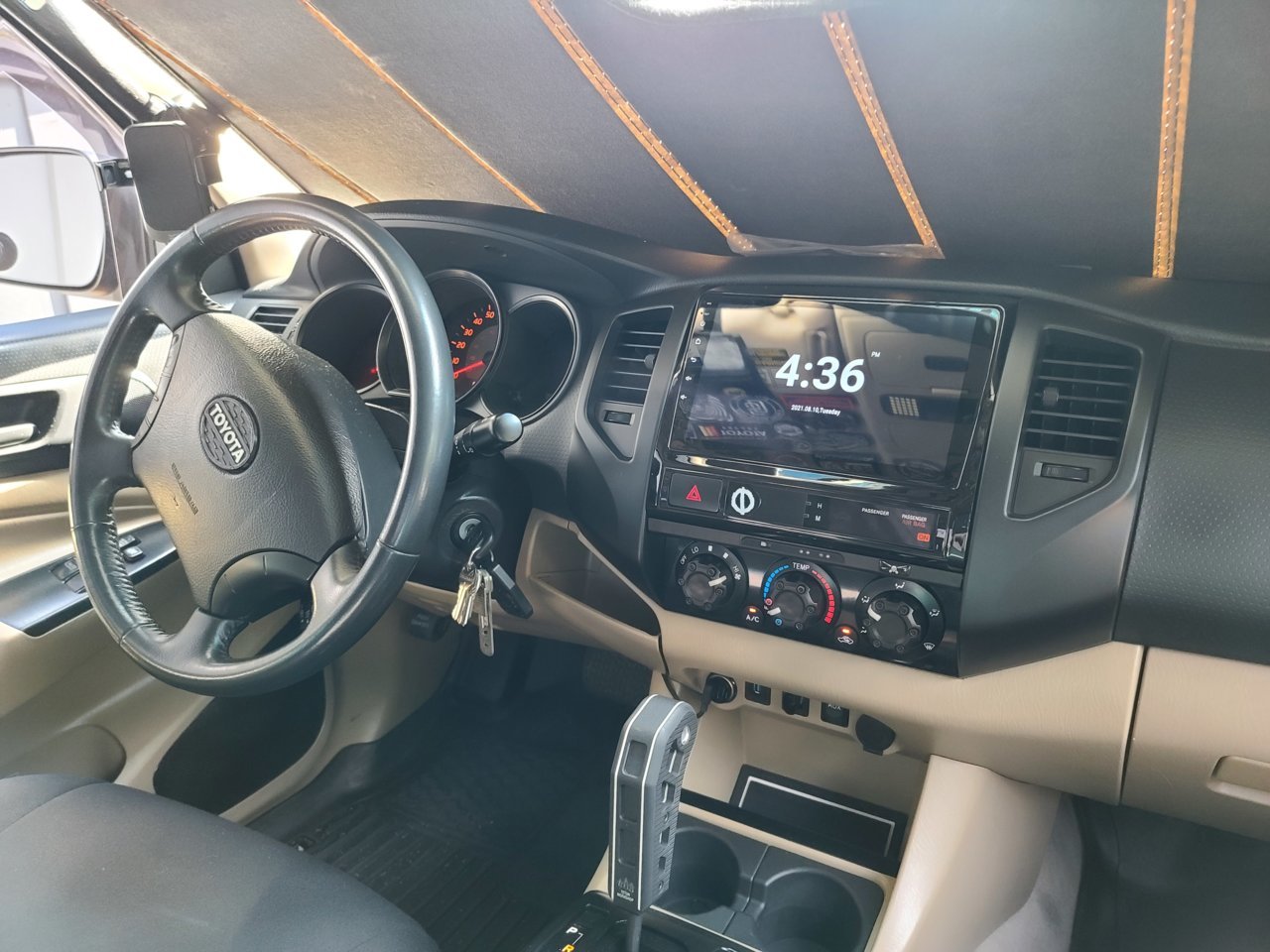

    how did you get your ajt temp knobs to have red and blue like that? did you paint them or did you order custom?

    You can order different colored screws from his website :)

    Regarding the media library, Joying says on their web site that they support up to 64GB USB flash drive. I have a 64GB USB flash drive and it loads very quickly. Yours is 500GB, well beyond the stated support size. Perhaps the load time is why.
    The LCD backlight could definitely be lower at night. I too have mine set at zero. For the most part it doesn't bother me except when using navigation. For some reason, my maps don't switch to night mode in Android Auto, and the white background is too bright at night. However, as I do run my headlights when it is overcast, I can still see the display during lower lighting conditions, which I could not do with the factory head unit if I turned the headlights on during the day.
    Have you considered a tinted screen protector?

    Did you play with the second set of backlight/dim controls? I was also pretty ticked about the screen dimming at night (when heads lights are on) but found the hidden/convoluted second set of pass-code (= 5768) protected dimming controls that are buried in the pass-code (= 3368) protected "factory" settings. You can really crank them way down to next to nothing.

    Brilliant! Thank you. My factory defaults were 90 for max and 80 for min. Slid my min down to 25 and then had to go re-adjust the night brightness in the display setting. I do believe that will work just fine.
