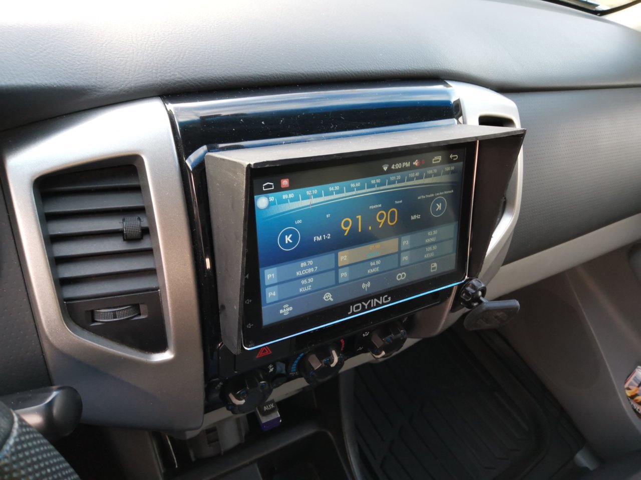

    Made a glare shield out of an old mudflap:]

    That looks stock! (Yeah, I can't say that with a straight face :) Hey, whatever works for you!

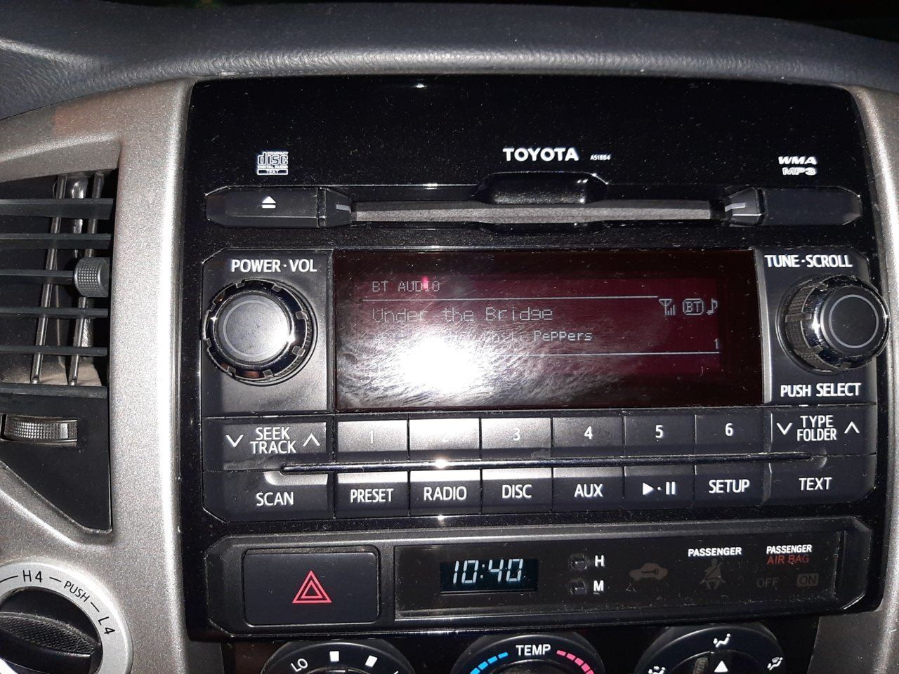

    On the Fascia around the radio, somewhere around the CD slot, there will be a little "JBL" logo if you have JBL. Feel free to post a picture of the front and back of your radio here to help us make a more informed recommendation.
  9. Feb 22, 2022 at 6:14 PM
    #609
    bradroche18
    bradroche18 Member
    Sep 15, 2021
    #377142
    16
    Looks as though mine is the non JBL, correct?
  10. Feb 22, 2022 at 7:11 PM
    #610
    Joseg14
    Joseg14 Member
    Jan 19, 2022
    #387807
    18
    Texas
    2012 Tacoma
    Yes, Non jbl.

  11. Feb 22, 2022 at 11:47 PM
    #611
    fizik
    fizik Accidental Offroader
    Jan 7, 2015
    #145816
    179
    Minnesota
    '13 DCSB SR5, '10 DCSB TRD OffRoad (deceased)
    Yeah, send Joying an email or use their chat function. Explain what you have. They DO have a wiring harness that should work for you.

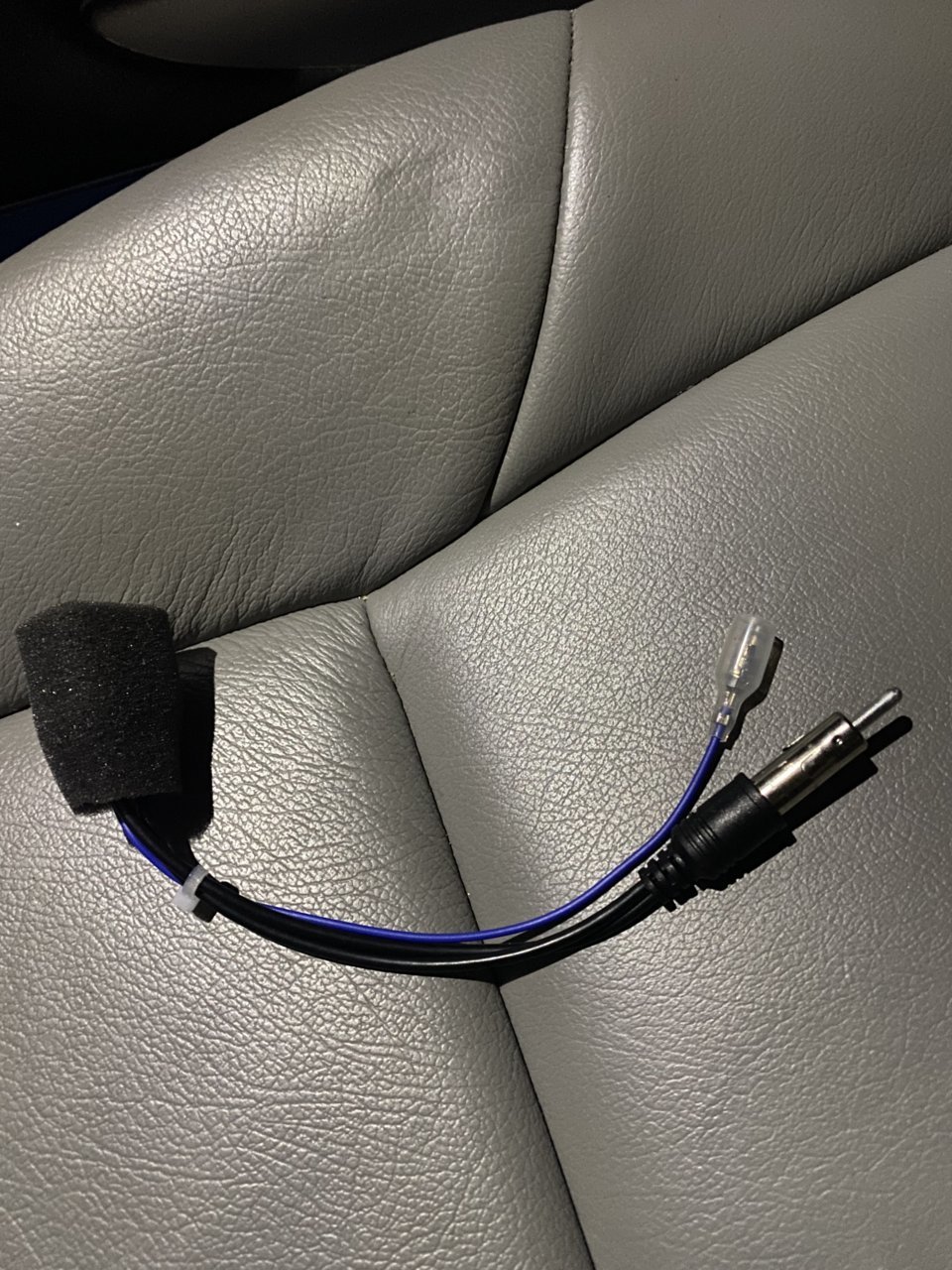

    I have a 2012 non JBL.
    1.) I’m left with 3 plugs, do these connect to somewhere? Or just extra?
    2.) This was included with the HU, any idea what it is? (First time ever connecting a HU)
    3.) How can I wire my oem rearview camera to the HU? ive watched several videos on yt but no help.
  14. Feb 23, 2022 at 9:36 PM
    #614
    Regnar
    Regnar Well-Known Member
    Apr 25, 2018
    #251674
    250
    Kodiak,AK
    2014 DCSB PreRunner SR5
    1. The blue plug is your shark fin/sat radio antenna. One of the white ones is your stock usb plug and requires and adapter to work. See ads below on Amazon. The third one maybe you Hazard/Clock plug.
    2. this is for your stock antenna. You are suppose to plug it in the head unit and plug the stock Fm antenna into the adapter. You have it wired up wrong
    You also need to hook up the 2 RCA plugs into the Aux in for the stock Aux Jack to work.
