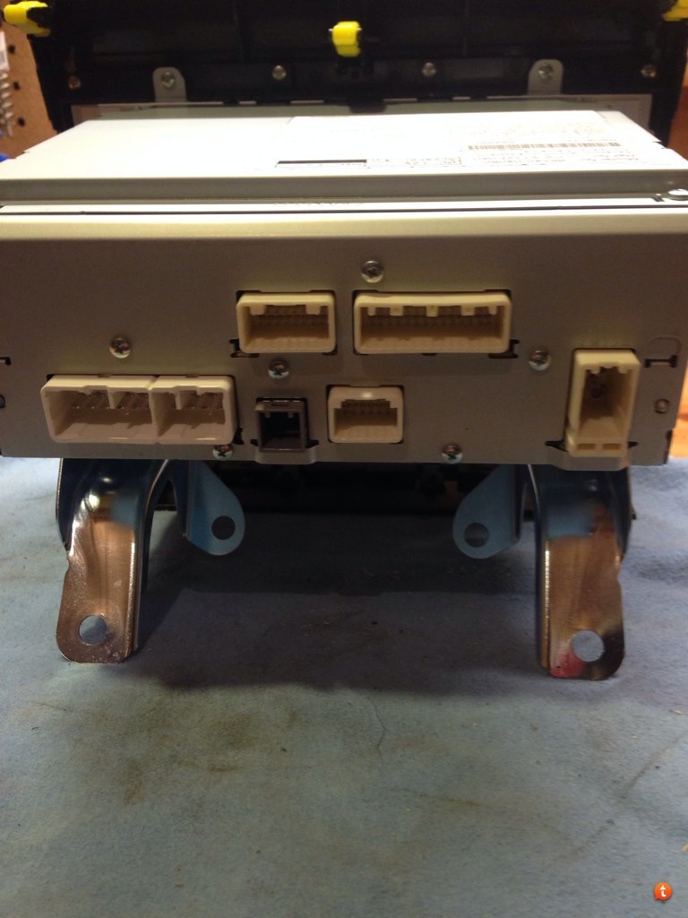

    Same exact radio I had. The two sockets on the left and the two upper sockets match "A". The gray socket in the middle is for the USB and the tall one to the right is for the antenna (My harness came with an adapter for the antenna plug, and I bought an adapter for the USB on Amazon https://www.amazon.com/dp/B00F0YJ49O ). That leaves the lone socket in the lower middle and I don't remember if anything was actually plugged into that. So, my guess is "A".

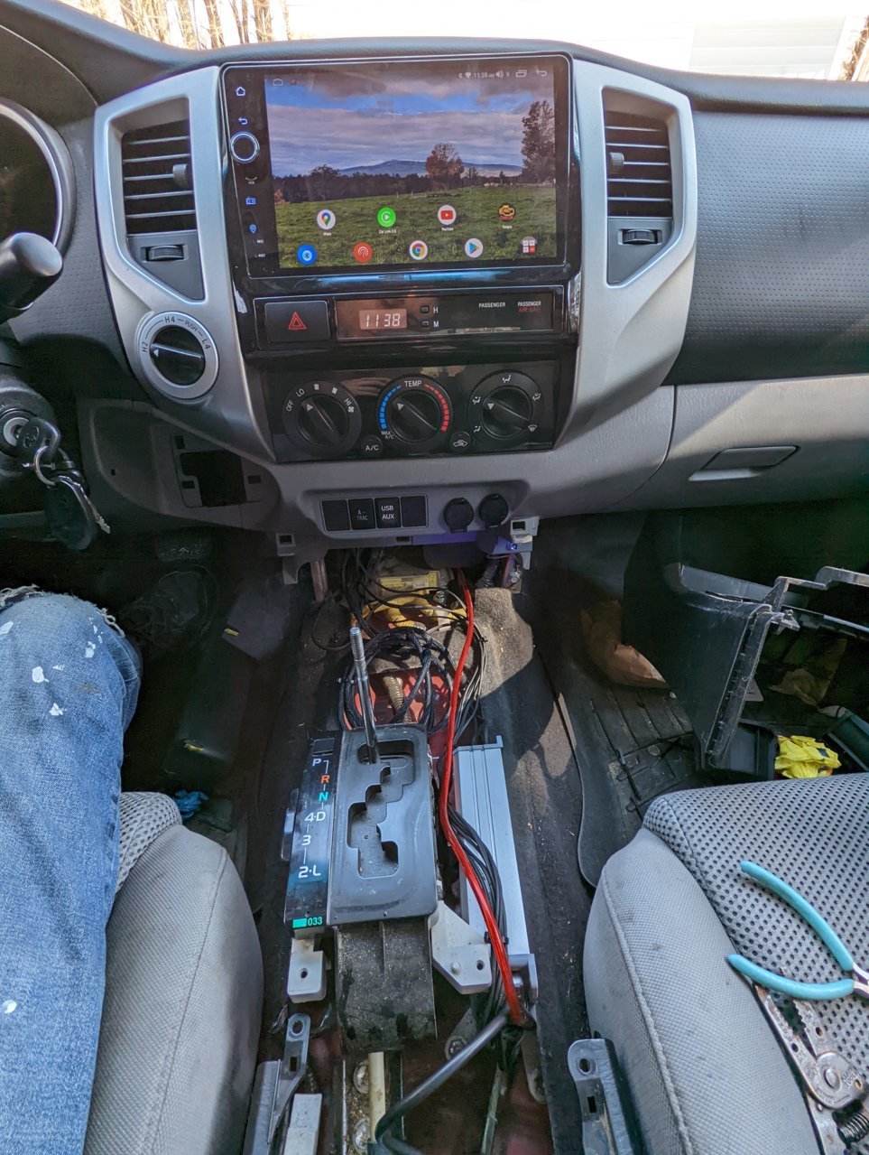

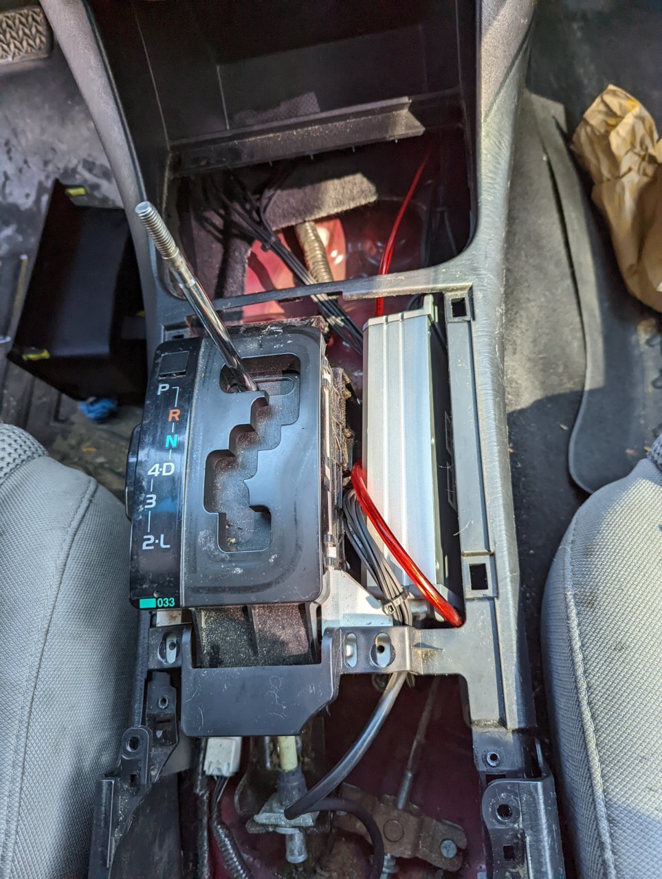

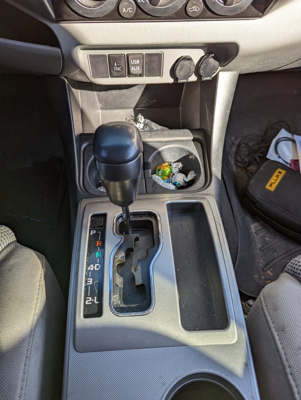

    New to the forums but wanted to let everyone know that I successfully installed an aftermarket 4-channel amp into my 9 Inch Joying Auto HU. I have a 2012 TRD off-road, non JBL.
    ALSO. Look how sneaky this spot is.

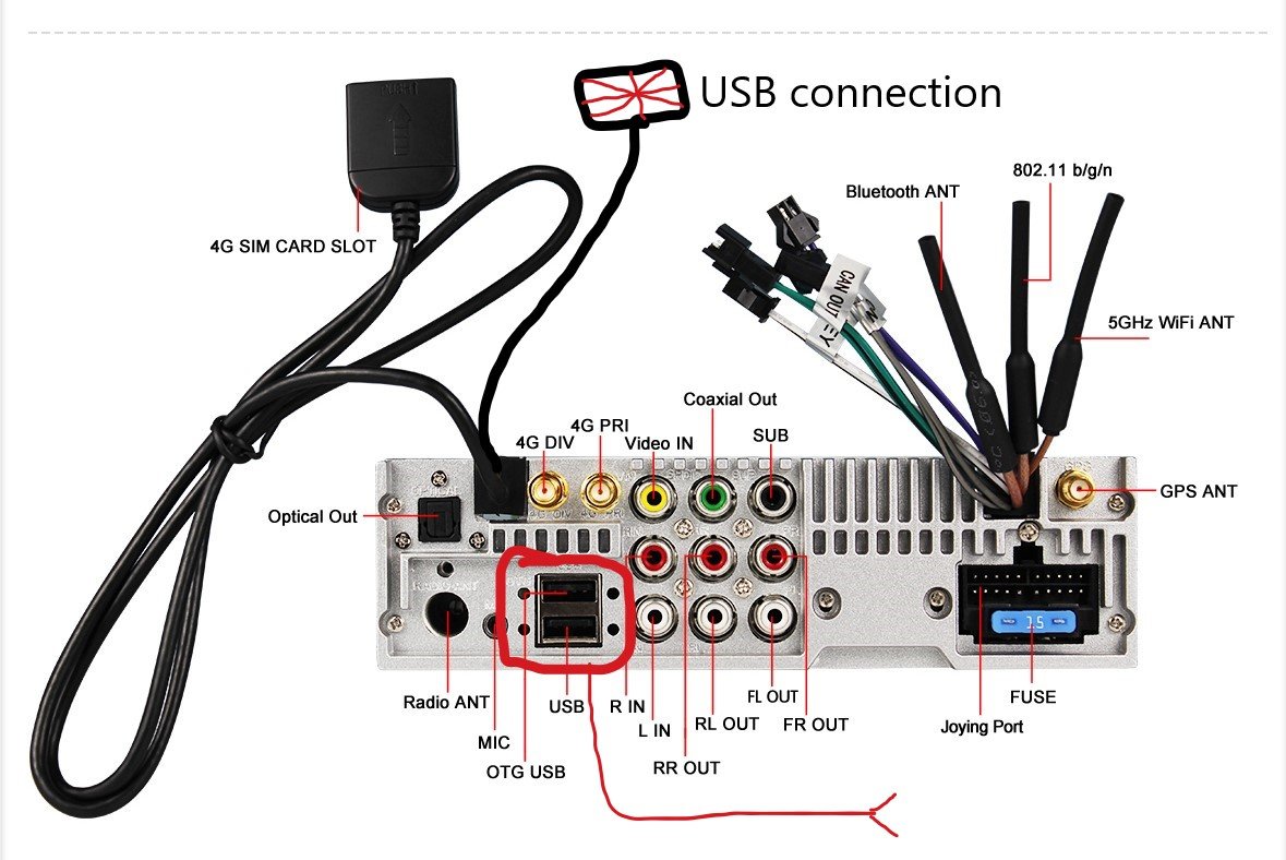

    All righty then! The head unit was delivered today and is hooked up and running. I haven't buttoned everything up yet, because I'm hoping to only do this once. With that, I have a question. On the back of the unit there are two USB connections (circled in RED) and then next or with the sim card dongle is another dongle with a USB female connection (indicated with a black square and red lines). Please see the attached picture.
    I'm curious as to where I should I connect the two (2) included USB cables to? The two in circled in red - or one there and the other up next to the sim card dongle?

    The wired USB i connected the joying USB dash cam. OTG USB is for your phone to connect to Android auto or carplay. Third is open

    Good to know. I'll run the two included USB cables out of the OTG and open slots. Using my house wifi, I downloaded AA on my phone and the HU. Once loaded it was able to run without my phone (Pixel 6) being connected via USB. I've never really used AA and I perfer not to. What I'd like to do is seperate my phone (except for calls) from the HU. I'm hoping a sim card (yet to be decided) will handle radio broadcasts and a good navigation app that works with the GPS antenna.
