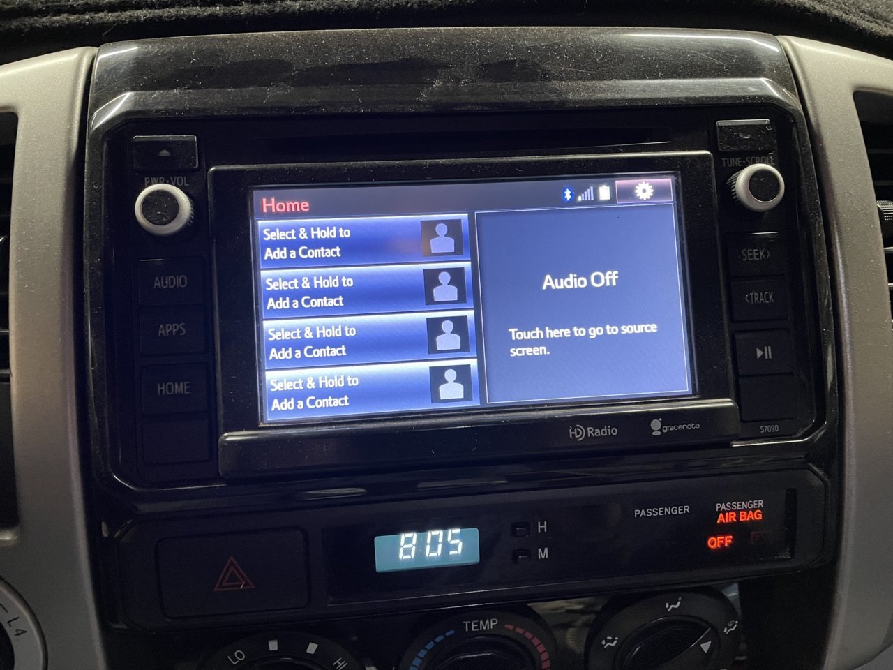

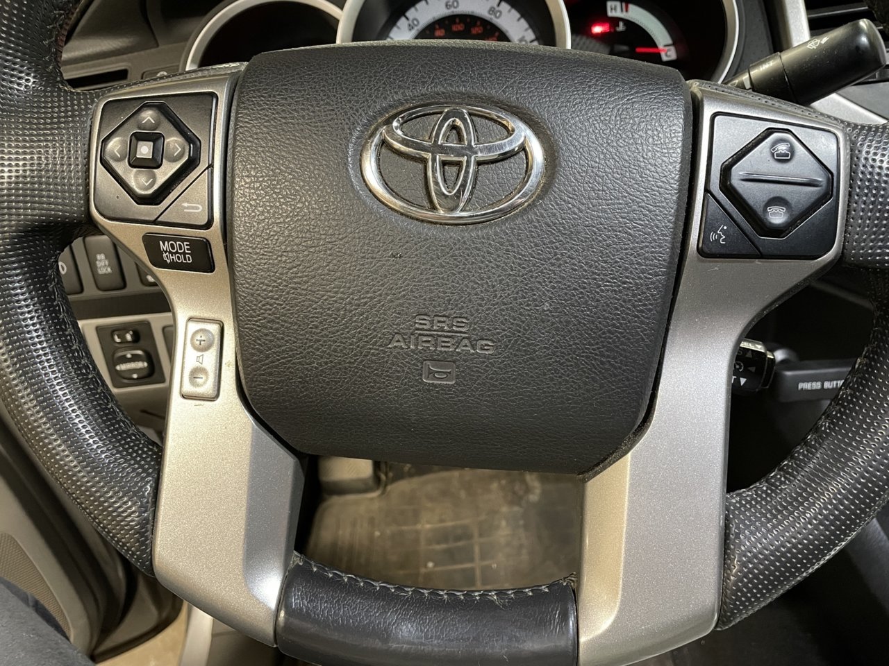

    I read all 37 pages of this thread & have decided to go for the current 9" Joying unit.
    My Taco is a 2014 4.0L Access Cab 6spd-manual 4WD (TRD-Off Road). I have the non-JBL OEM head unit at present.
    I just ordered the Joying 9" unit from eBay, Manufacturer Part Number: JY-TQ187N8G-B.
    I'm also getting a PAC-USB-TY1 USB harness so I can keep the OEM USB port. https://www.amazon.com/PAC-USB-TY1-Toyota-Lexus-Retention/dp/B00F0YJ49O/
    Due to adding a bed cap w/ solid rear swing doors (removing tailgate) I will be deleting the factory backup camera. I plan to add a separate hi-rez rear-view-mirror substitute backup camera, so no concerns about backup-cam connection to the Joying. It's a pity Joying doesn't support USB or HDMI backup cam input; RCA video signal at 480p can't do justice to contemporary HD (and beyond) cameras.
    From what I gather here, assuming they ship the right part # I will not need any other wiring or harnesses to install this. Here are some shots of my current head unit & steering wheel. Appreciate any comments or remarks, i.e. if I have ordered the wrong part number or am forgetting some harness or plug that I will need.
    Expected delivery is not till end of May/early June; I will post my install & post-install experiences here in due course.

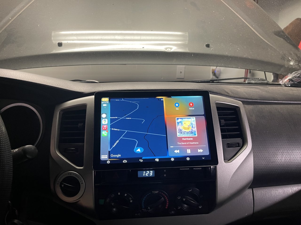

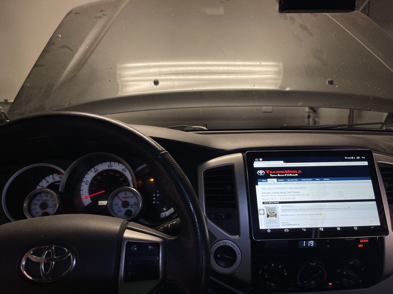

    Y’all this feels like cheating

    Haha you gotta dam iPad on yours! What type do you have? Thinking of making a switch with my stock one.

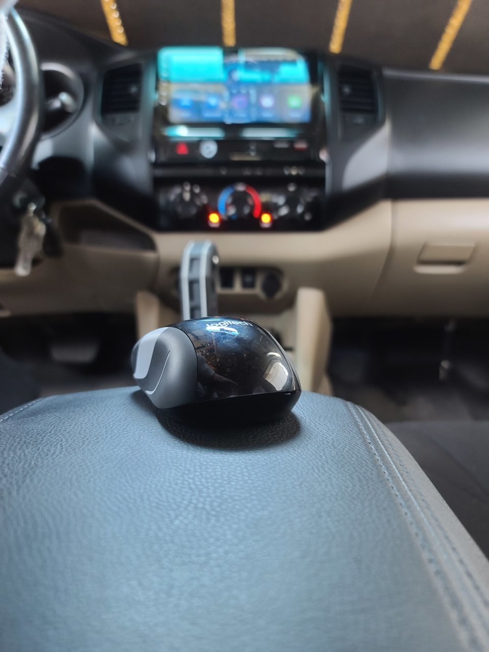

    I'm running a dasaita, but I wanted to share that using a wireless mouse makes it much easier to update software, etc.

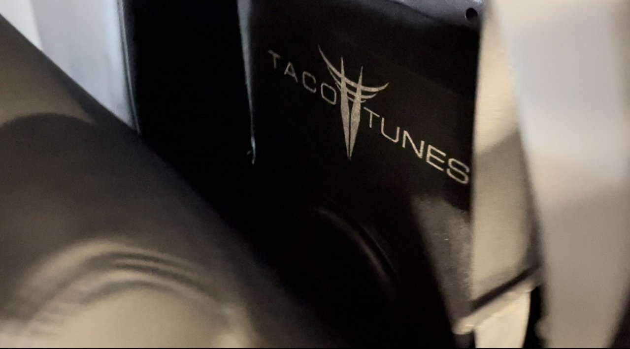

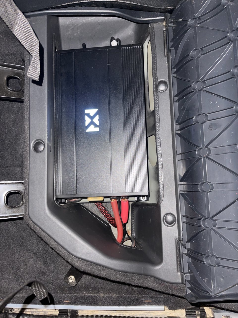

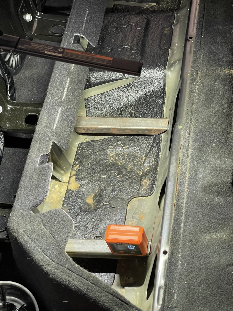

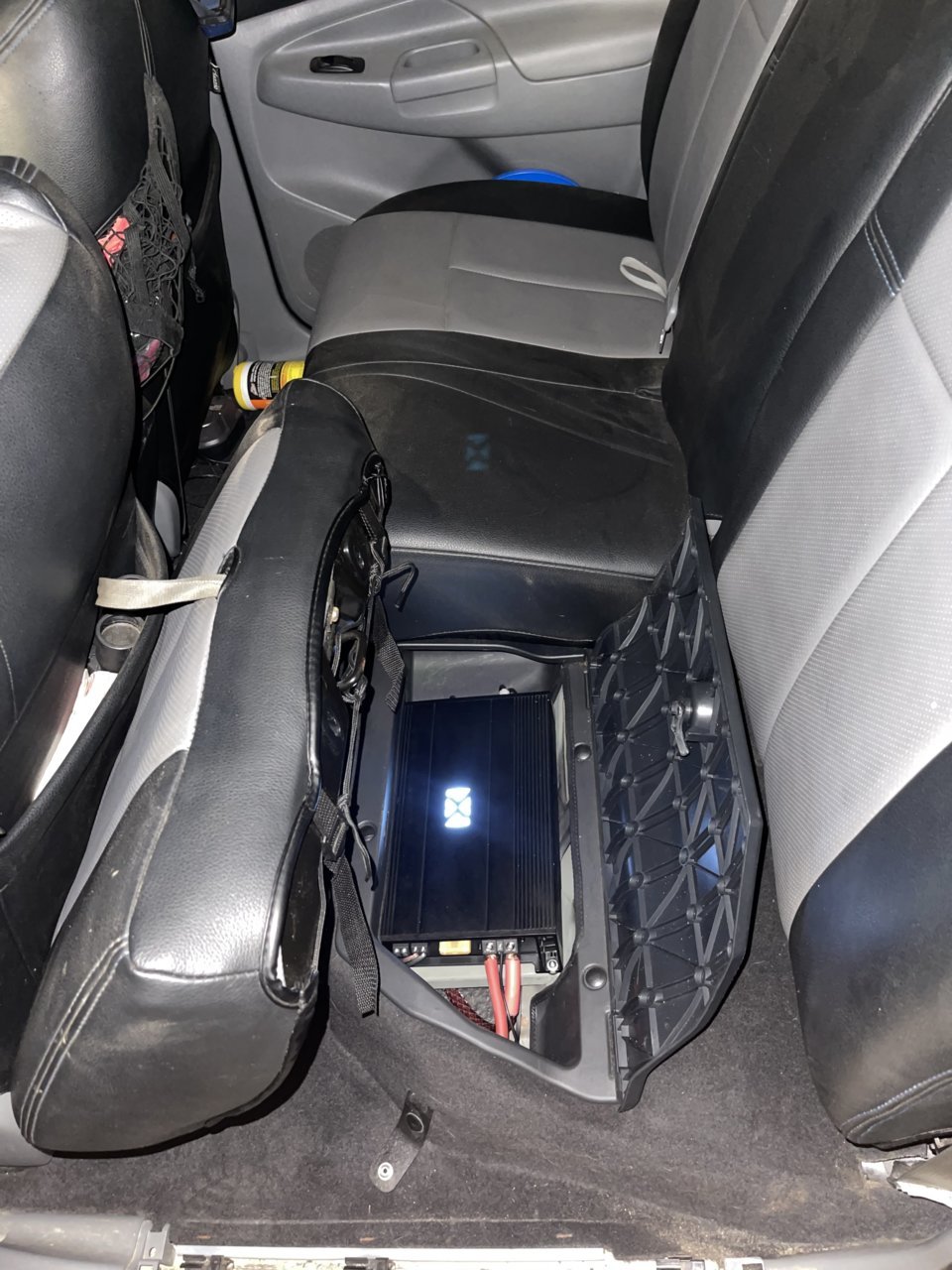

    Man I love it!! Haven’t gotten to drive the truck since installing it yet but the little bit I’ve played with it has been awesome. It’s the 10.1” Joying listed here: https://www.joyingauto.com/newest-1...05-2015-head-unit-supports-apple-carplay.html
    Def still need to figure out a few configuration things but got Netflix working, wired and wireless CarPlay works, output to the new sub and amp works, all speakers work… seems to be promising so far. Wireless car play is a little laggy, but wired is almost no lag.
    As mentioned I also got my sub and amp installed, super happy with how it turned out. Welded a couple brackets in the bottom of the cubby to mount the amp to. Trimmed out the cubby area to fit. Sub fit great behind rear passenger seat. All super clean, you wouldn’t know it’s there without pulling up the seats

    The amp looks cozy in there under the closed door & seat insulation above that. How hot does it run? Any issues with overheating when playing loud & long?
  20. May 19, 2022 at 2:26 PM
    #740
    HappyGilmore
    HappyGilmore LambTek Innovations
    Dec 24, 2018
    #276792
    2,978
    Huntsville, AL
    2013 SC’d DCSB TRD OR 4x4 | 2012 Lexus IS-F
    Yes
    I’ve yet to have any issues but I also haven’t had a chance to drive the truck either :) I just rebuilt the engine, chopped and lifted the front of the frame, replaced steering rack, motor mounts, etc., refreshed the front suspension and am in the process of installing long travel in the rear… she should be rolling by next weekend fingers crossed and I’ll be able to come to a better conclusion then :thumbsup: I really don’t anticipate much of an issue; there’s about 2” of space both below and above the amp so it’s not totally insulated by material. Wouldn’t be difficult at all to tap a little 12v fan in there if overheating does become an issue though…
