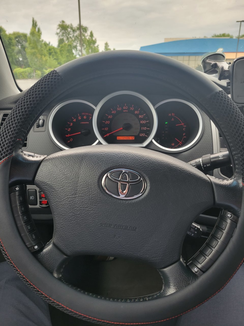

    I had one of those dials, sent it back immediately. I was hoping it would be like a regular analog stereo dial, but you can't really move it up and down quickly. It still has to register one click at a time, didn't feel any better than the touchscreen. If you move it too fast it won't capture all the clicks.
    I attached a picture of my current setup which I am very happy with

    That’s a nice setup for pre-FLs.
    Volume skipping was assumed without smoothing (essentially coding a specific time delay) but for ~$20, installed in no time, it’s something and it’s better than spending weeks piecing together something with an Arduino. Or maybe I buy two and mod the second with an Arduino. Probably more work than I want to invest.

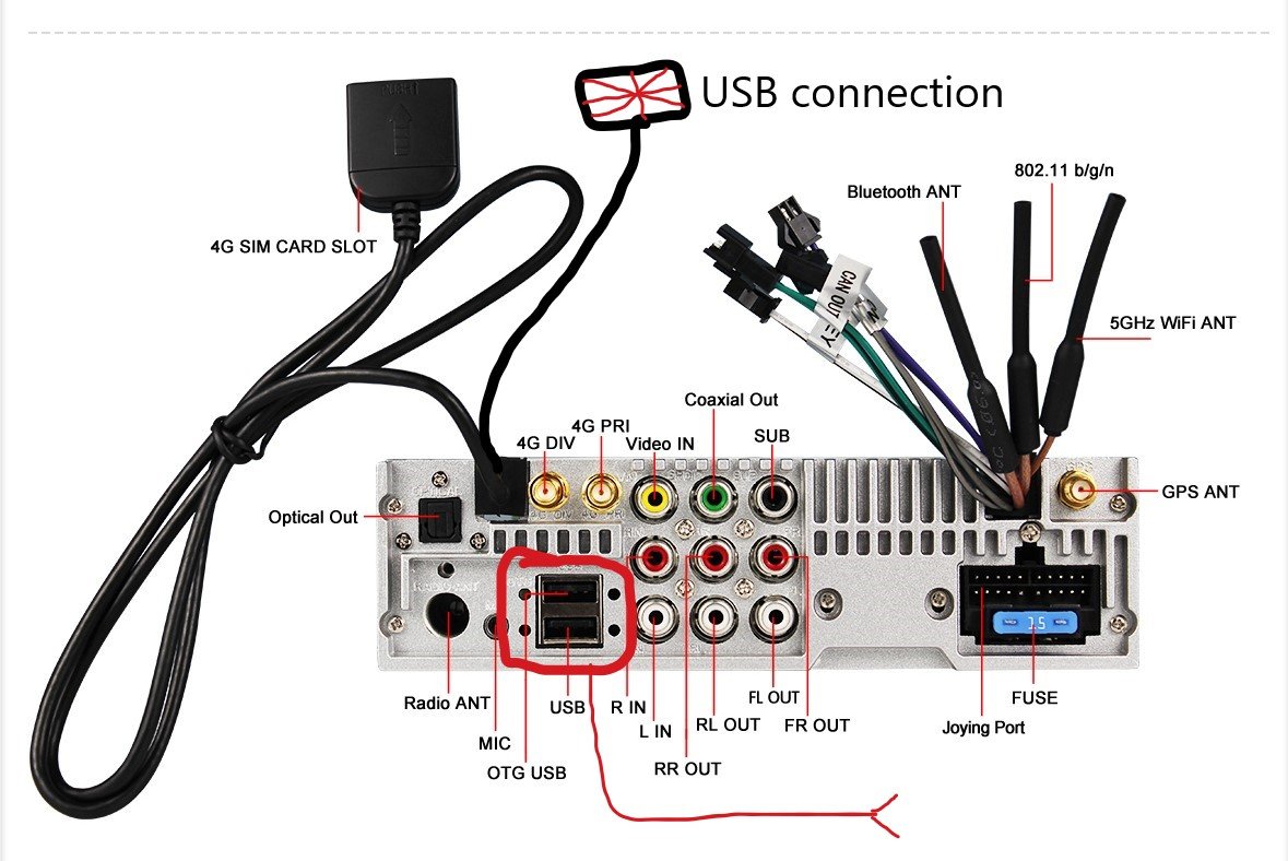

    I’m about to pull the trigger on the 9” with the volume knob. Does anyone know if there is a port for a Sirius XM receiver to plug into?

    I do not have a Sirius receiver, but recall something about the RCA in jack for a speaker??? Here's a picture of the back of one of their head units. Hopefully it will give you an idea.
    Disregard the red square and additional USB connection. It was for a question on USB connections and the additional one (drawn in) that was on my unit.
    BTW- Joying has pretty good customer service. Email them with proof of purchase along with your question and they'll get back to you by the next morning. Time difference...

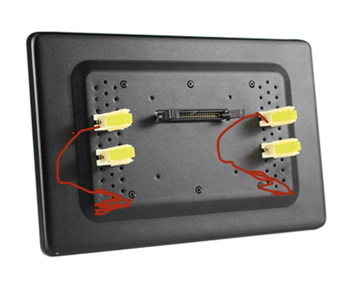

    Can anyone with the 1920x1200 10.1” or 11.6” confirm the screen can be installed higher?

    I moved my clips to adjust height with no problems

    Thanks, that pretty much seals the deal for me. Would love to see a pic of you have one handy. Also curious how much the screen tilts back.
