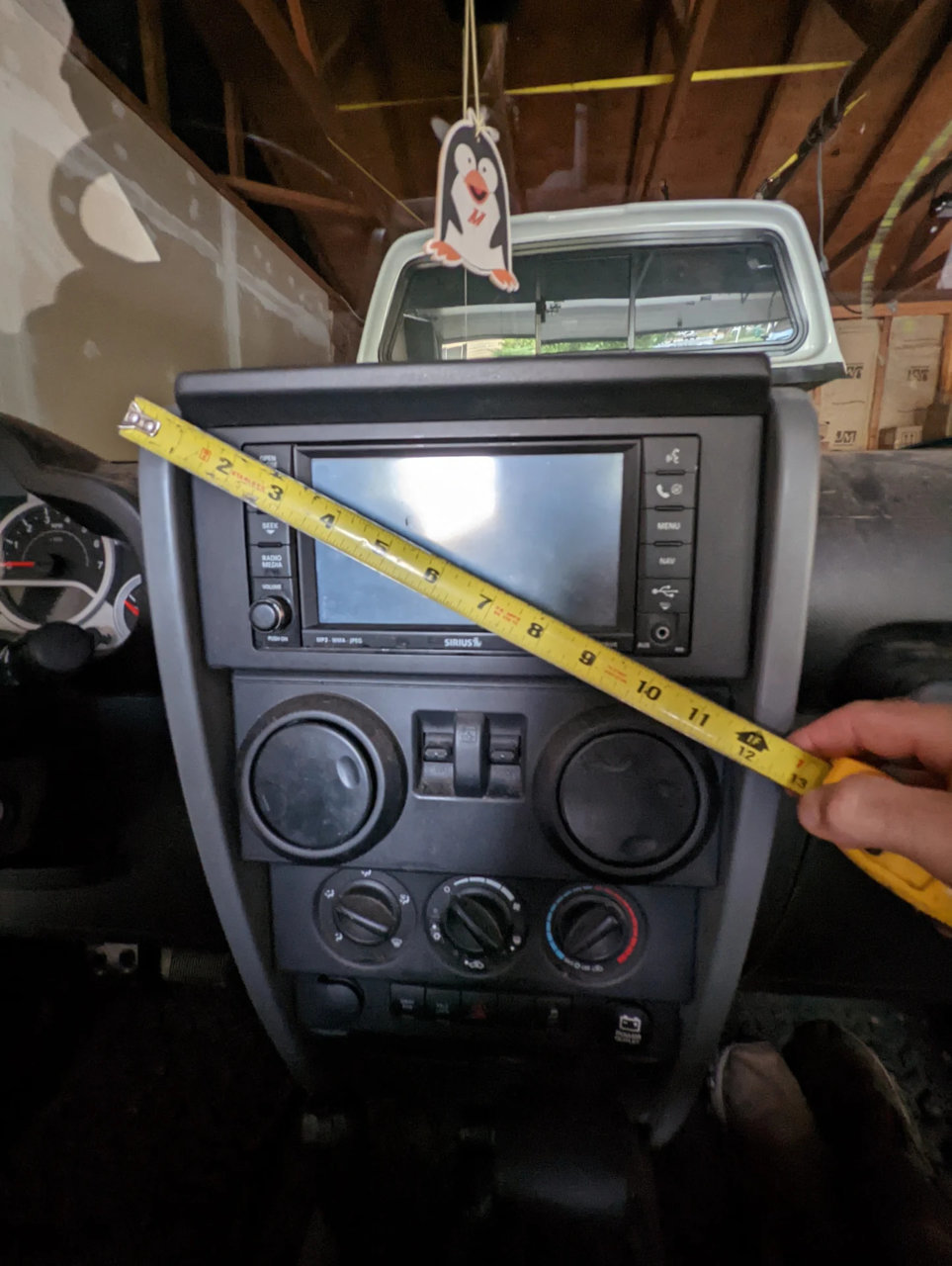

    Just cause I'm 'taco 4 life even tho I sold it', I still wanna document some Jeep JK stuff here unless people object. Below is a of basically what the 11.6" (12") joying unit will replace in the JK Rubicon
    And hey, Taco related, that 2nd Gen Tacoma DCSB Snugtop XTR topper is for sale!

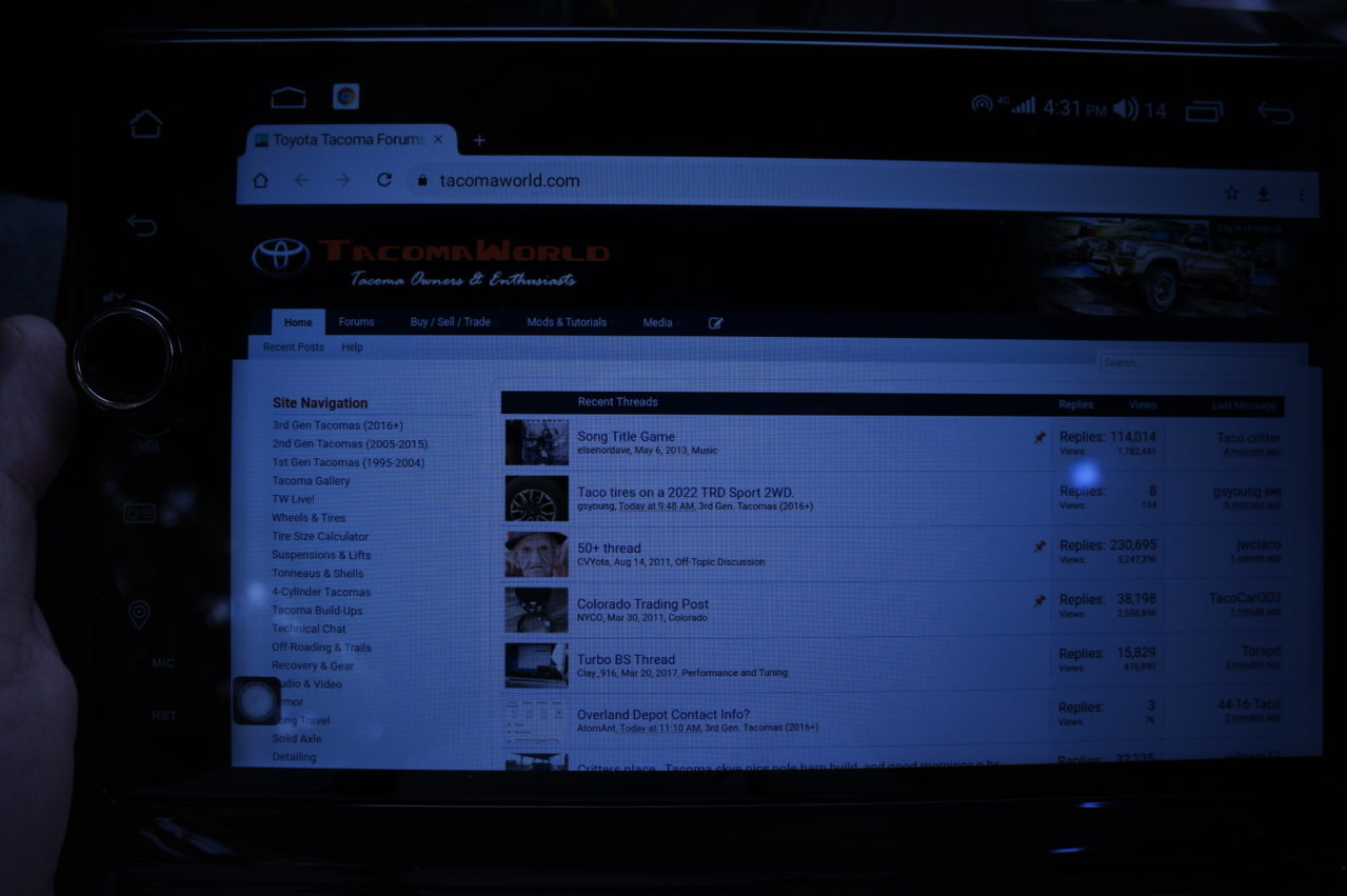

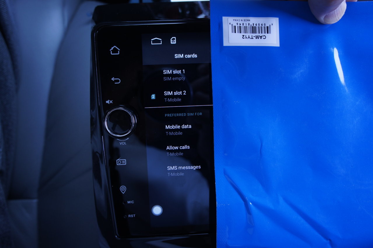

    T-mobile tells me the new data SIM is active, but nothing. I got hungry so until tomorrow.
    The amplifier does sound good. Better than the stock HU. So it’s a win there.
    BlueTooth - CarPlay works but seems a bit flaky, maybe user error. Not as seamless as the VW.
    Also confirmed, the box does get warm.
    Never give up (on the first try) T Mobile works

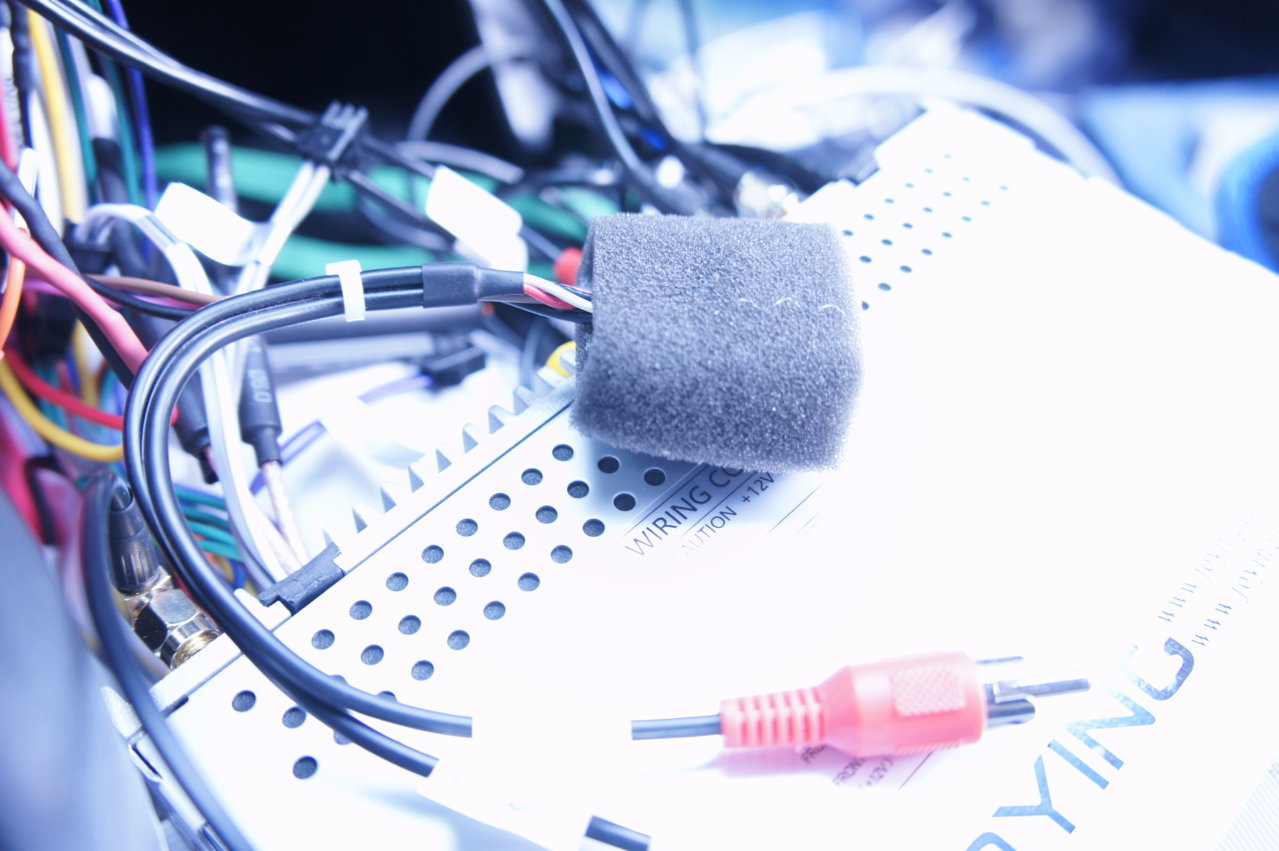

    Question?
    I have a 20 pin connector (not 10 pin) from the Joying HU that is unused. It has 2 RCA's. Is that normal? For what is it used?

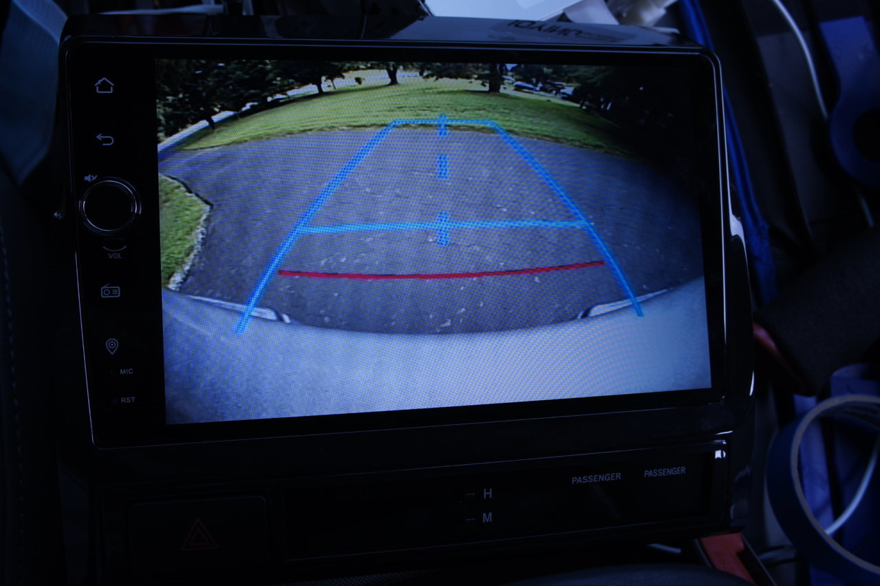

    OEM Backup cam works.

    I think that connector is for the CAN-BUS box, if you have one. On my VW, that connector has the CAN-BUS module plugged in.

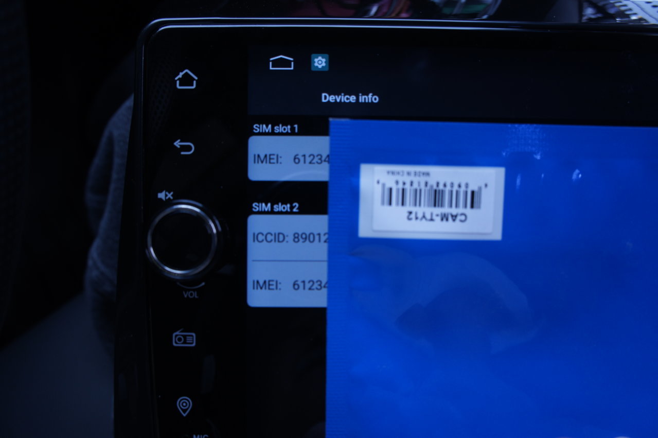

    It's interesting the SIM card uses slot 2. I would have assumed slot 1, since there's only one physical card slot
