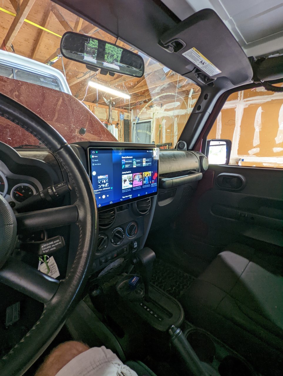

    I just got mine today and setting it up atm. Taking a break for food, and a drink refill.

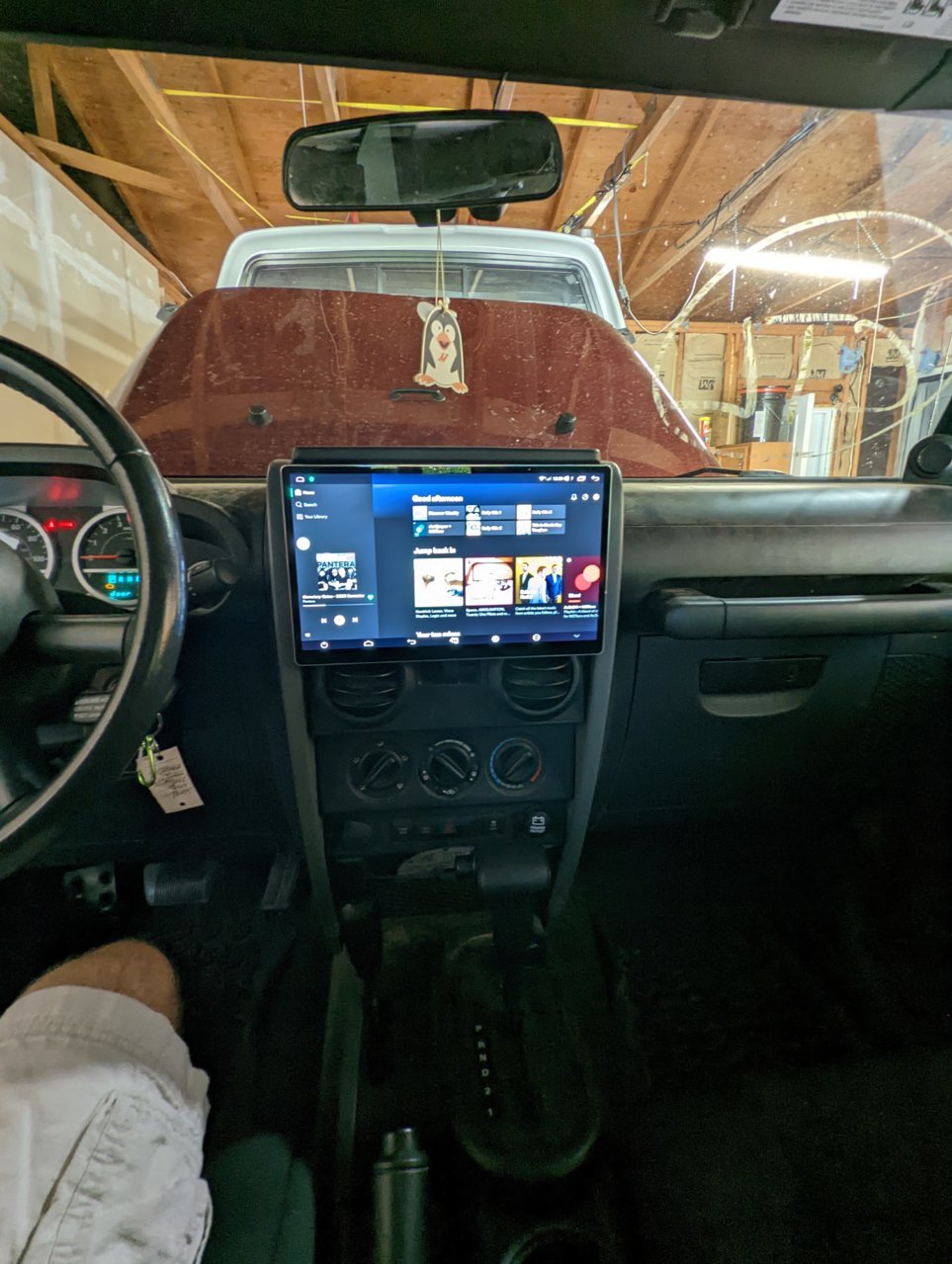

    Mocked up in the jeep

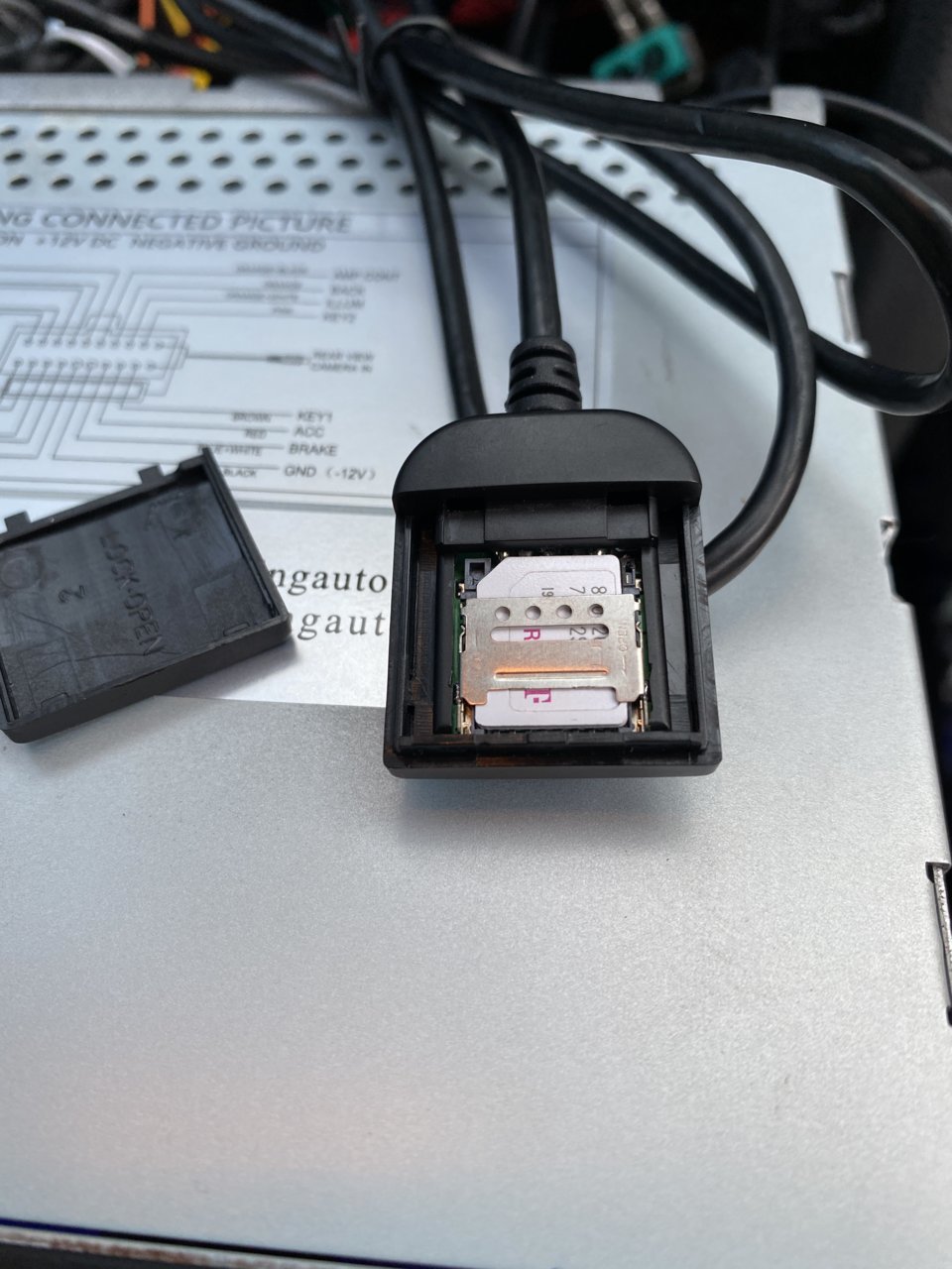

    For those of you using t-mobile, did you run into any challenges getting the head unit to recognize the SIM card?
    I put mine in the card holder, but the Joying still says the slot is empty

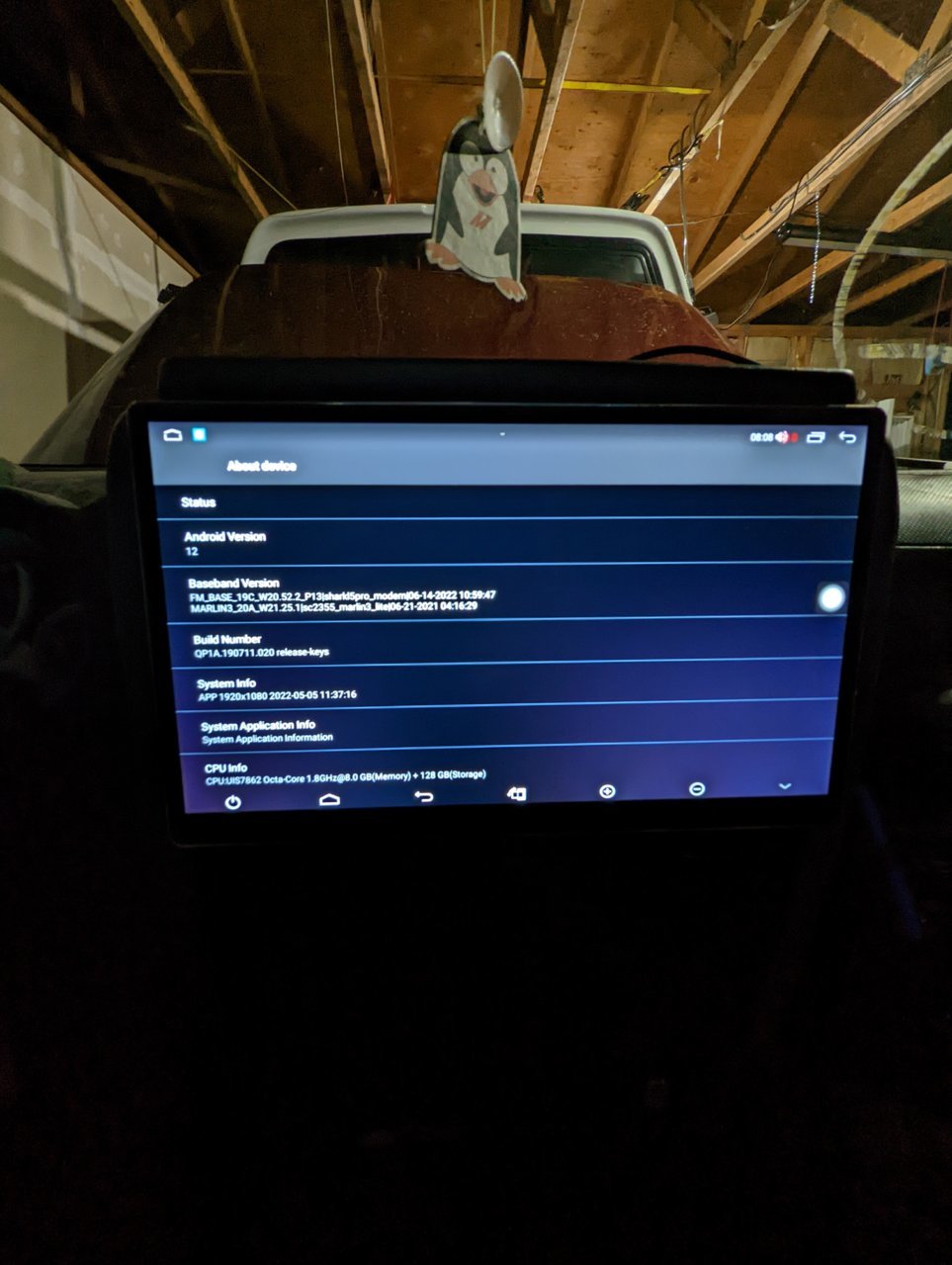

    I got mine all updated to Android 12. Pretty easy. Just download the 6-22 update file. Unzip it. Copy the contents of the unzipped file to a USB drive that is FAT32 formatted. Insert USB into joying and it will auto detect and promt for update. Then do the same thing again with the Android 12 update.
    If you plan to do the update, do it before setting anything else up because it will wipe the joying hard drive

    Reset the HU. There is a pin hole on the front of the Joying (metal box). Paper clip works.

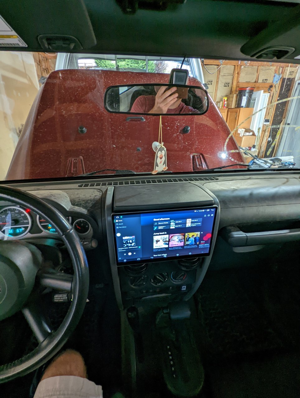

    Mostly finished JK install

    I was apprehensive about bricking the new toy before the physical install was complete. However, Android 12 is in. :humble: I like the new interface.
    Both F & Bk cameras still work. FM radio is still meh.

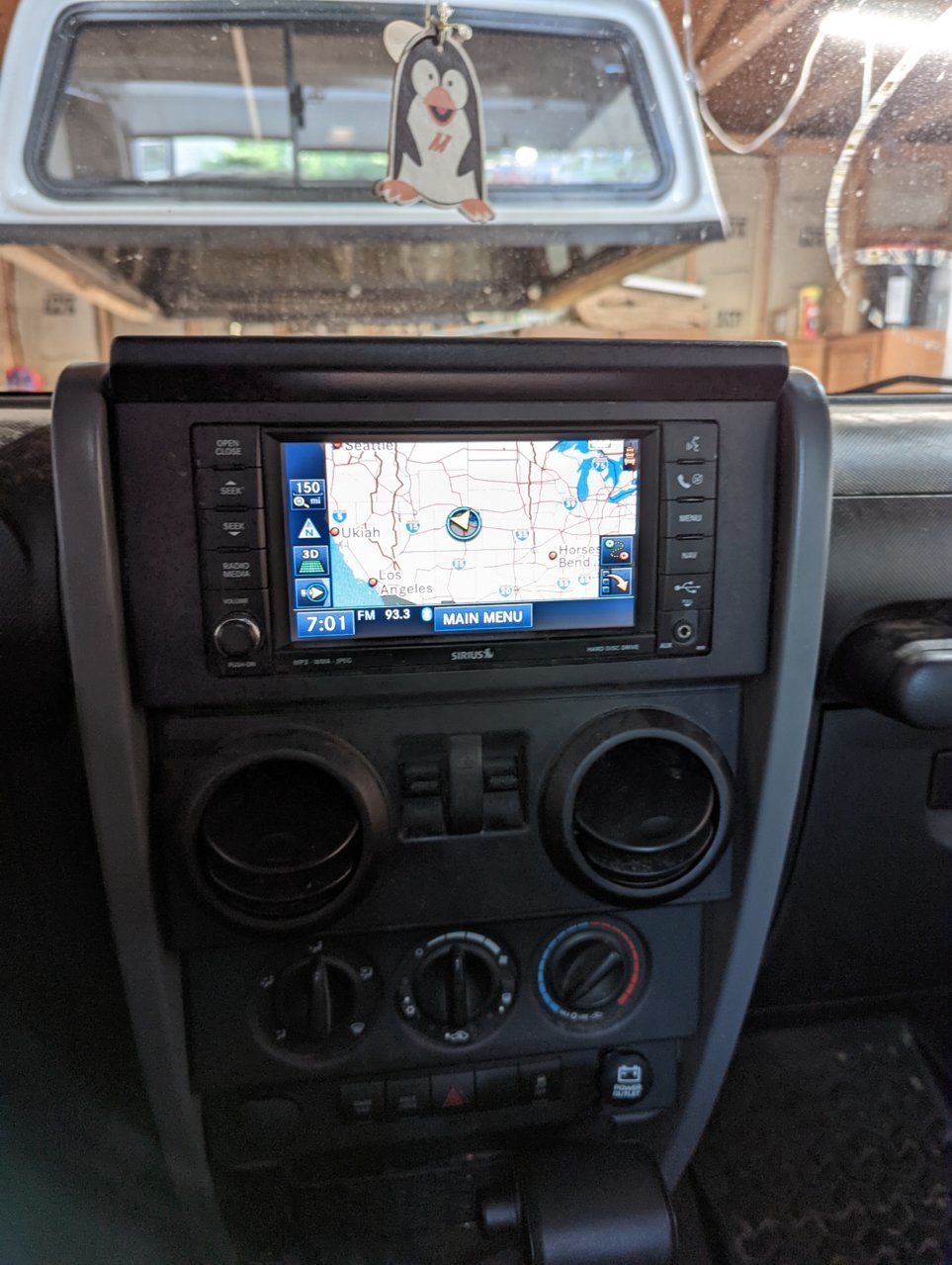

    I've used both of them. AGAMA seemed to have more quirks that I couldn't figure out and I went back to Car Launcher Pro that I've used for years and years. Pic of it on my former Taco.
