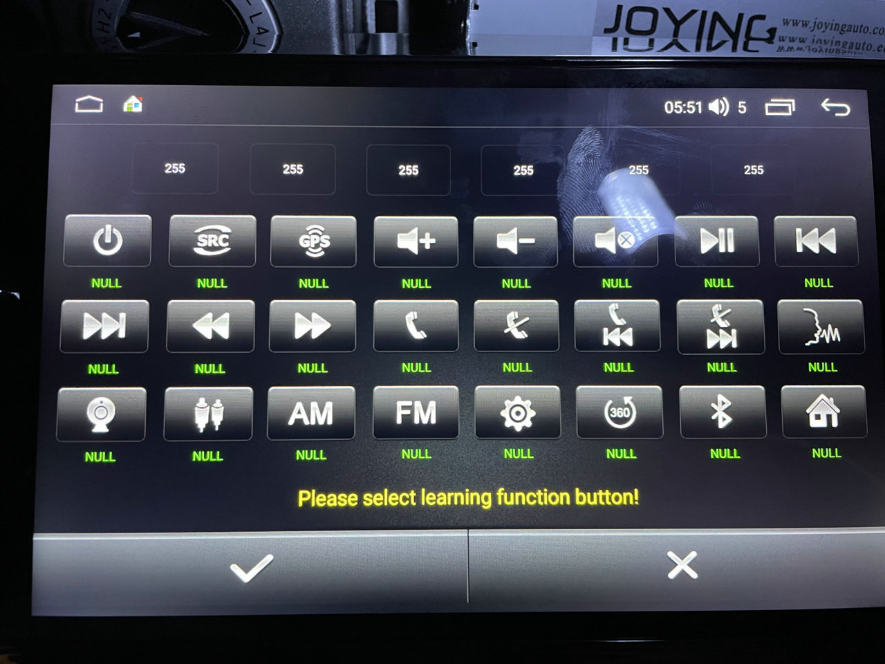

    Ok fellas, I'm on the wiring stage here and need some help. 2012 Entune+JBL setup.
    1. Is there any way to keep my shark fin antenna (blue connector from stock end)? I'm not sure what these adapter types are to do an adequate search...
    2. Where do I plug in the "Can In" and "IR" connections?
    3. Are the 4G connectors needed for CarPlay and misc apps?
  9. Aug 25, 2022 at 2:12 PM

    Taco Salad Sport, post: 27742376,
    1. Is there any way to keep my shark fin antenna (blue connector from stock end)? I'm not sure what these adapter types are to do an adequate search... XM sat radio? It’s not something I use, but I don’t think it’s supported.
    2. Where do I plug in the "Can In" and "IR" connections? I’m non JBL. So what I did may not apply.
    3. Are the 4G connectors needed for CarPlay and misc apps? 4G is for cell data service. WiFi and BlueTooth have their own antenna(s).

    Looks like I have everything connected and working (backup camera, unit turns on/off with the key, sound works) with the exception of the steering wheel controls.
    I have tried both types of connections... With CAN OUT + KEY, the display text will rapidly flash between the yellow, "Please select a learning function" and the red, "Please hold the button on the steering wheel into the learning state". With CAN OUT + CAN IN, only the red text appears. In both cases, pressing a button on the steering wheel and display has no effect.
    The following link says that if I have a CANBUS decoder, CAN OUT + CAN IN is the solution. No sure if that applies to me, but it didn't seem to have an effect anyway.
    https://www.joyingauto.com/blog/pos...i-stereo-and-keep-the-steering-wheel-control/
    I e-mailed the customer support folks but they have only sent me a link to a youtube video which does not help.
    Any ideas?

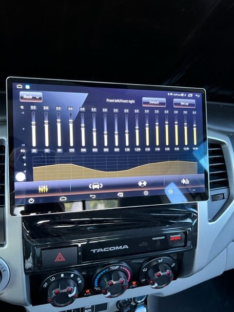

    Speaking of which - Has anybody played around with the JHU’s DSP? I’ve got a 3-way component speaker with passive crossovers and 75W x 4-channel Class AB amp. In bridged mod, the 75x4 amp would send waaaay too much RMS to the crossovers. 75W per crossover is half of what they can take. Neither option is great but I could definitely live with 75W per crossover.
    In messing around with the JHU, there may be a solution…
    Ideally the front RCA outs would carry a bandpassed signal to amp channels 1/2 and provide 75W per woofer. The rear RCA outs would carry a high pass signal to amp channels 3/4, sending 75W to each passive mid+tweeter crossover.
    Looking at the JHU EQ there might be a way to do this but for whatever reason I can only change the front left/right and not the rear.
    Suggestions??

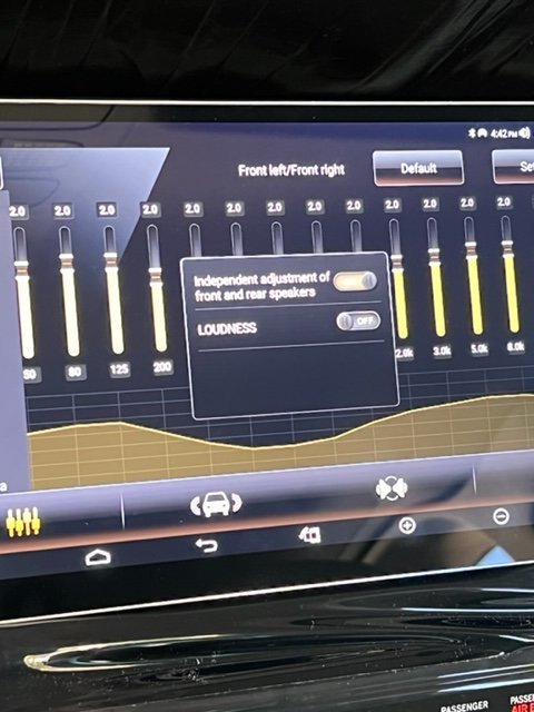

    Sorry can’t help. I’m using the Joying amp output. Equalizer works for me. Got the SW running. Turned the loudness off. It seems to like the SW xover at ~ 125-160 Hz.

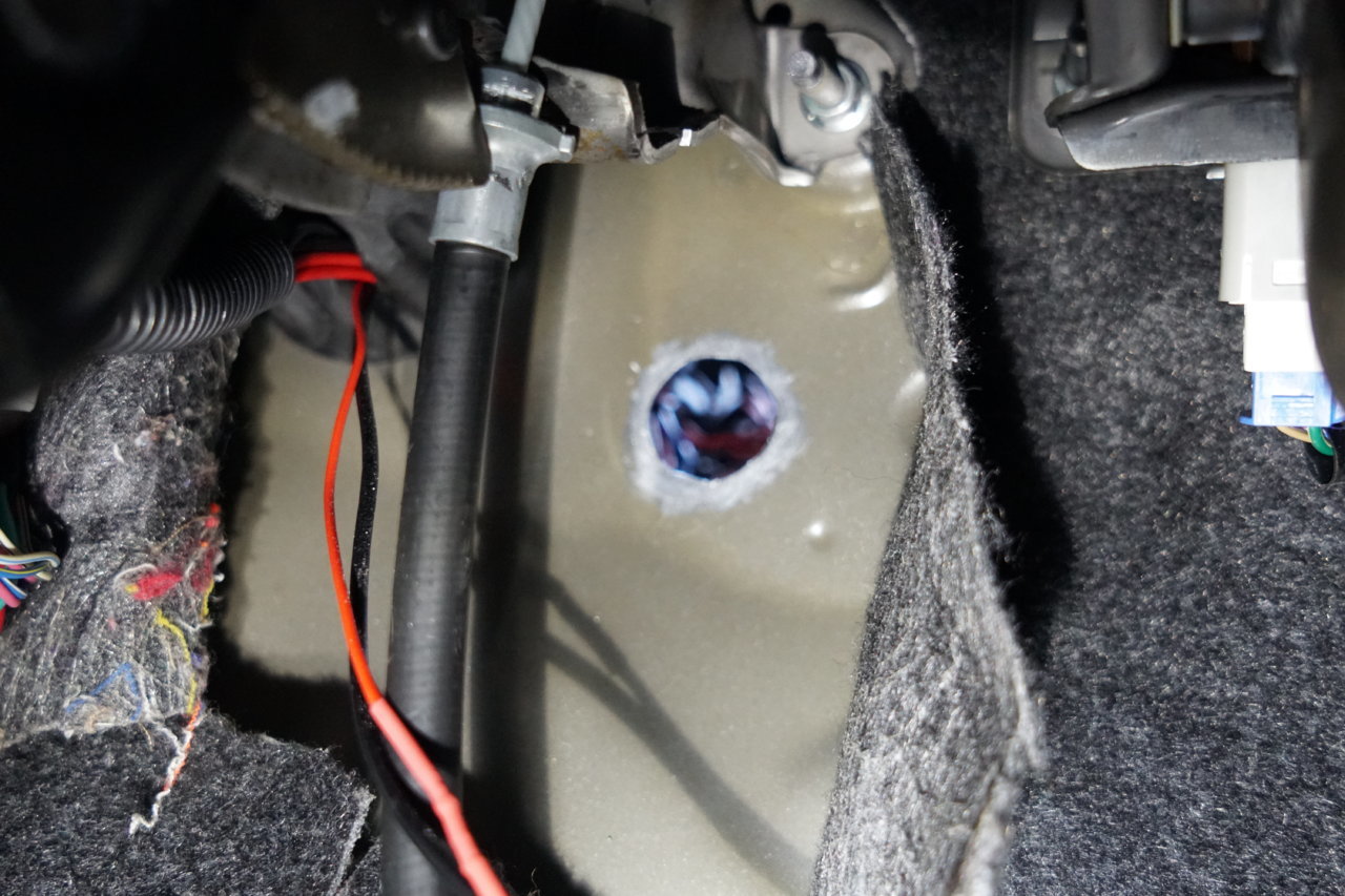

    Two thumbs up. Very happy. The whole system sounds really good. The Joying HU sounds good. Note: I believe some of the improvement in sound quality is because I’m now streaming FLAC (lossless) files from Amazon music. Had to turn the tweeters turned down. Bass volume (thump) is also not a problem.
    As small as the SW amp is, I had to pull passenger seat to situate the amp under the seat. Adding the SW dedicated power take’s some of the pressure off the accessories fuse. I ran a 8 gauge line from the battery with a 30 amp fuse (the amp is fused by the mfg for 20 amps). Also ran a 6 gauge ground wire. Overkill admittedly. I could have just grounded to the frame but in the past I’ve had issues with ground loops. Regardless this gives me room to add more stuff, nothing planned for sure but 8 gauge can take 40 - 50 amps.
    Had to drill a hole through the firewall for the wires.

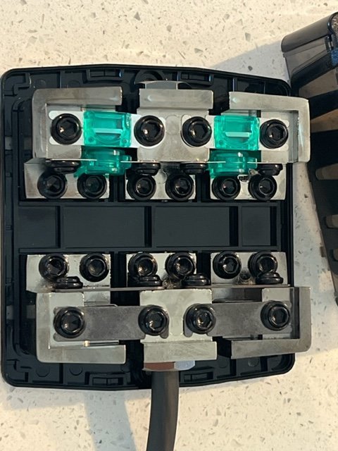

    We may have similar goals. I’ll be running a full CT Sounds system and have been impressed with the build quality and very happy with their support. Emailed them yesterday about the active/passive scenario I described above, they already wrote back and confirmed that setup will work. Every email over the last year has been responded to within 24hrs. So now it’s on to Joying support for DSP assistance…
    Anywho… I don’t want to rattle anything either. The music I listen to needs more precision and punch than teeth rattling SPLs (I don’t have any fillings so I can’t relate). First to go in is a CT-700.1D amp and Tropo 8” dual 4-Ohm sub. That amp will send ~380-400W at 2-Ohm, perfect for that sub. Short term the sub will go in a decent $40 box I found on Amazon. It’s a wedge shape and on its side fits snuggly between the rear access cab “seats”. Big cat approves.
    Wiring is a little different than rnish. I’ll have 4ga from the battery to a (big) KnuKoncepts distribution block. 4ga to the subwoofer amp and eventually 4ga to the 75x4 amp for component main speakers. I could run 8ga from the distribution block to the amps but I have plenty of quality OFC 4ga at my disposal and both amps accept up to 4ga.
