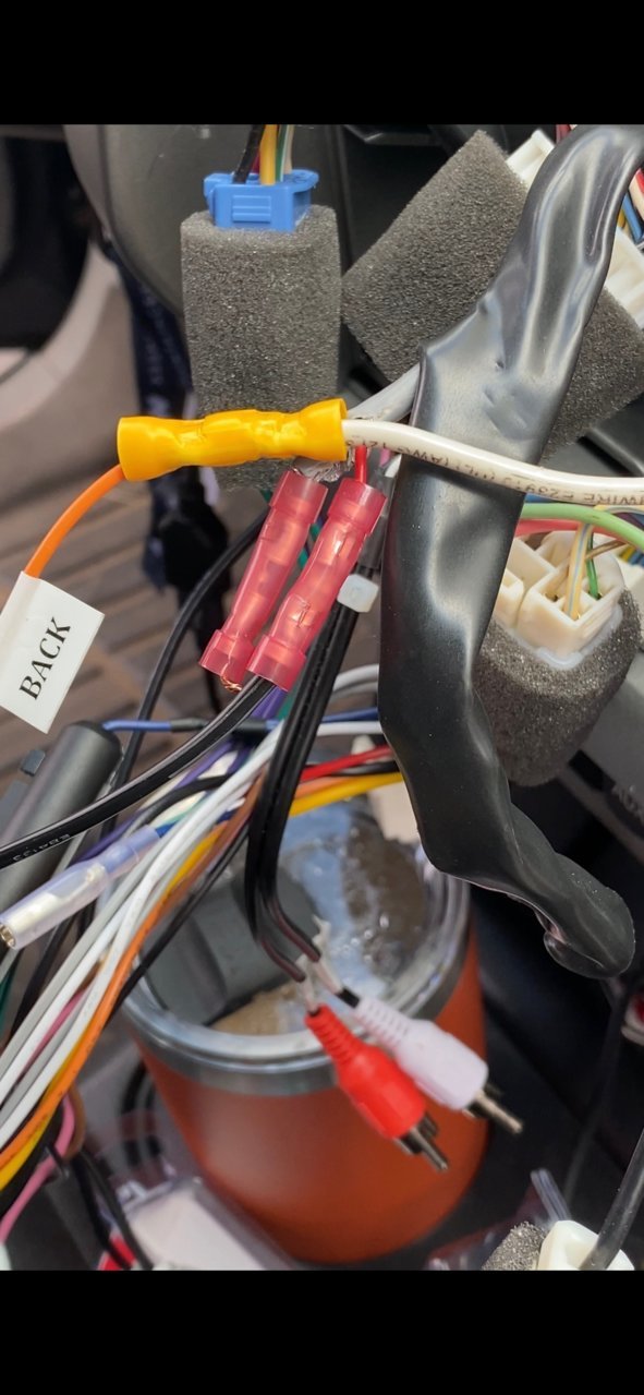

    Would you happen to have any picture of how you spliced the factory camera harness

    Here is how i wired my factory camera.
