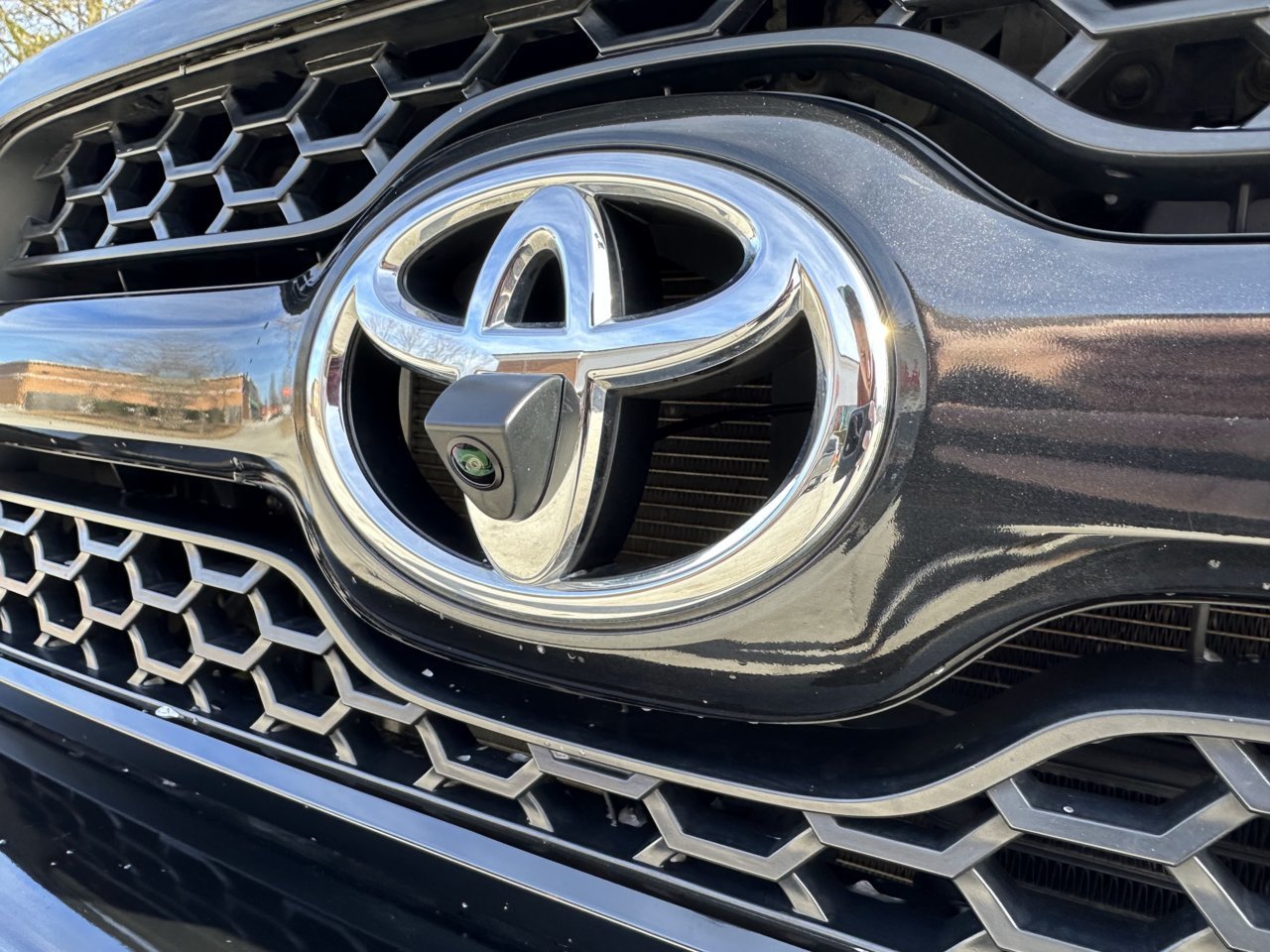

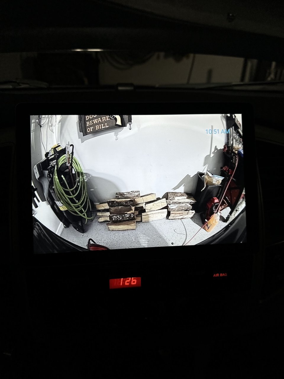

    The head unit has two inputs. The rear cam input and a second yellow RCA on the back for video in. If you enable it in the menu, that becomes the input for the front cam.

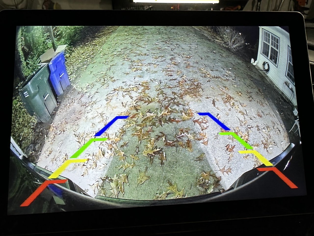

    Confirmed bitches. Joying head unit w/ canbus installed in a 2014 Tacoma non-JBL with the factory backup camera. No wiring/splicing/etc whatsoever. Plug and play.
