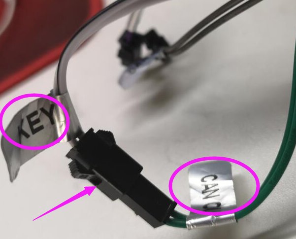

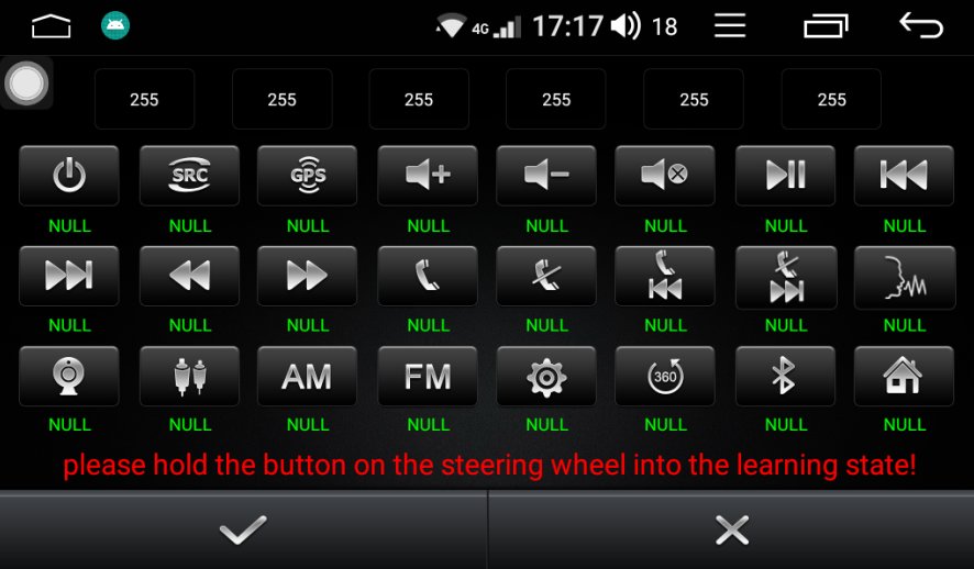

    1) First, pls choose key+canout in the back of the JOYING head unit as below:
    2) Pls choose null as below in setting-factory setting(3368)-car model:
    3) Then pls go into control app to learn and set the steering wheel control as below:
    Here is a similar video for your ref about how to learn and set the SWC buttons: https://www.youtube.com/watch?v=azhmdqPl3MI&t=12s

    This is how everything was set up but the only button it would recognize was the voice button. I will try again when I get home. The only button I was able to learn was the voice button for some reason.

    Ok so I got all the steering wheel buttons to learn except the ones I want. The volume up and down and the track skip buttons are unresponsive.

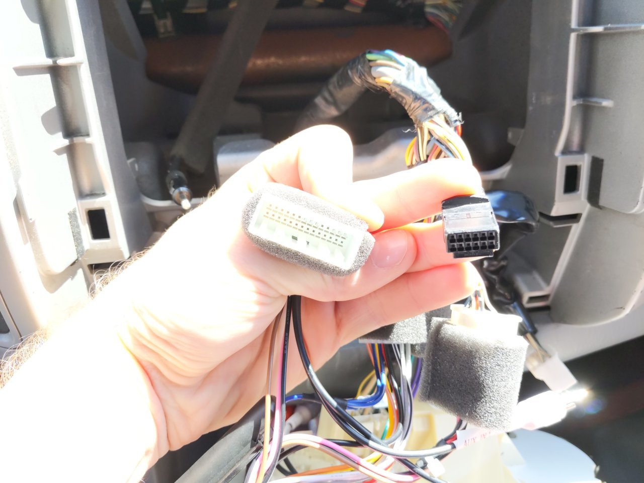

    Ordered from Joying direct. They shipped with the wrong harness. They followed up by sending a replacement which was also incorrect. I decided to wire it the old fashioned way and the touchscreen doesn't work at all and half the clips that hold the guts to the screen broke off while removing it for the third time to take a picture of their harness for them.

    Yep, I believe it's a problem with the pirated silicon they use in the touch controller - I had a problem once in a previous life with otherwise very good counterfeit chips that had similar quirks.
    The "correct" harness they sent has everything except for the steering wheel control connections. Does anyone have any insight on getting those wired up to these units?
    Edit: Here's a photo of the mismatched connectors from the "correct" harness and my truck - I'm assuming that small black connector carries (among other things) the CANBUS, since the first harness had a CANBUS decoder with the wrong ends on it and this one does not have a CANBUS decoder at all.
    Does anyone have an idea of what the most expedient way to get these buttons working is going to be?
    Thanks.

    I didnt plug in either of those plugs in my 09 and it works fine.

    Ya, not sure what exactly mine looked like. But I had leftover plugs. I assume for satellite radio, factory mic, etc.
