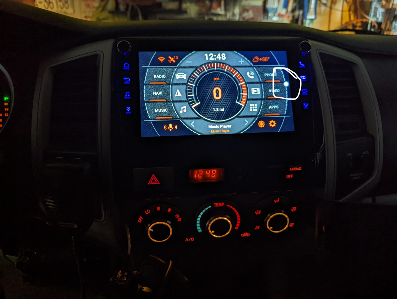

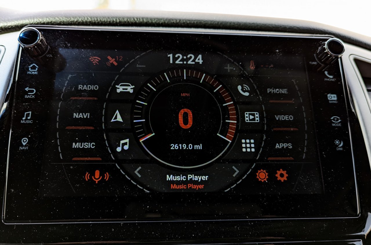

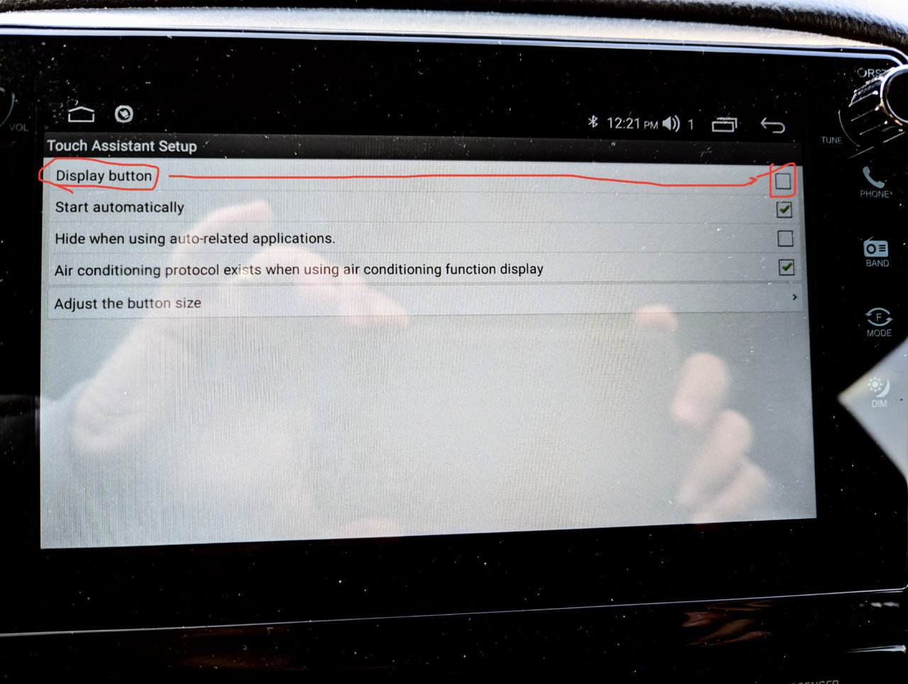

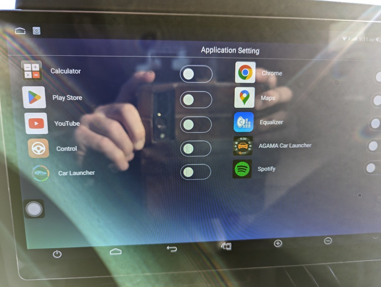

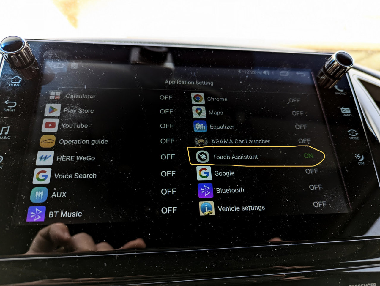

    Thanks to @GoldenTaco27 for the clue on where to start with this. First go to SETTINGS, then USER, then APPLICATION SETTING. There you will see TOUCH ASSISTANT, turn it on. Shut off power to the head unit (key accessories) for a minute or two. When you power up the head unit you should see the Touch Assistant set up. I unchecked the "display button" option and again turned off the head unit. After a minute I powered it back up again the floating white bubble was gone. I then went back to USER, APPLICATION SETTING and turned the TOUCH ASSISTANT back off. I again powered down the head unit for a minute before restarting and my normal home screen was there without the floating white orb.
    Pictures for reference
    PXL_20230222_192201696.jpg PXL_20230222_192218317.jpg PXL_20230222_192113883.jpg
    No more Orb. Before and after
    Note: before picture was taken months prior to this post while the after picture was taken today.
