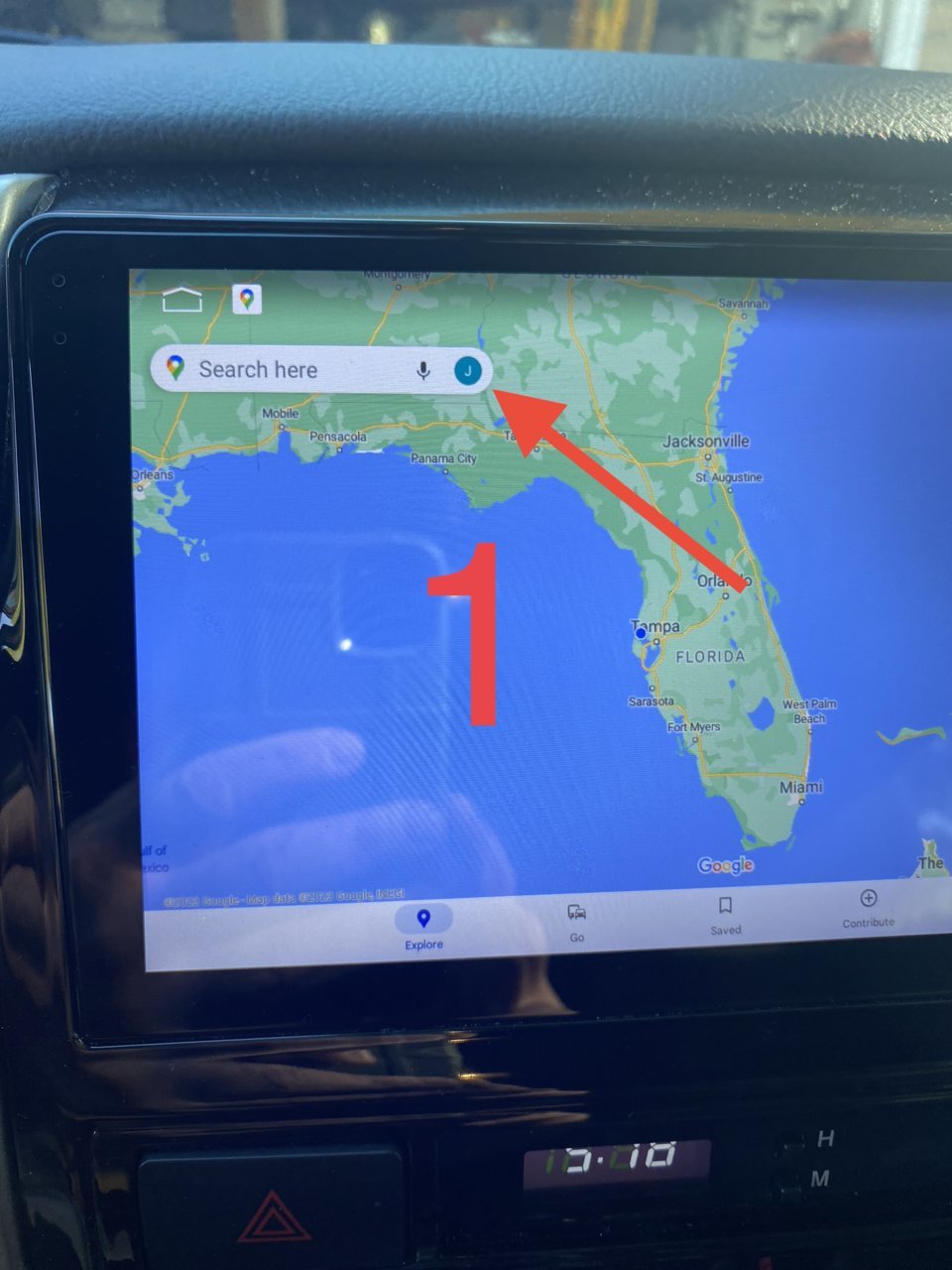

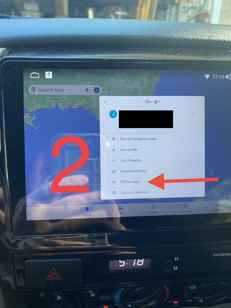

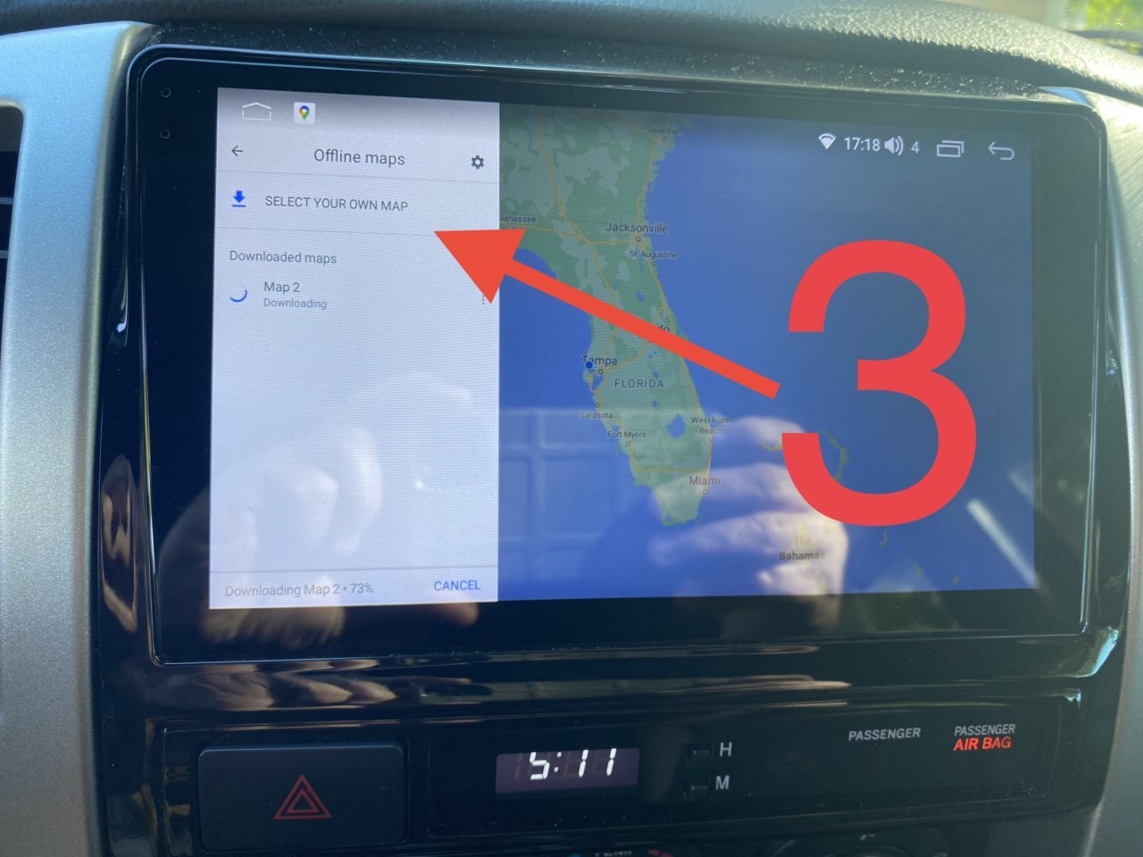

  12. Mar 16, 2023 at 9:22 PM
    #1052
    Regnar
    Regnar Well-Known Member
    Apr 25, 2018
    #251674
    250
    Kodiak,AK
    2014 DCSB PreRunner SR5
    See attached photos. Maps are good for 14 days. I downloaded about 12 states, 2 provinces and all of Alaska for my move last year. So quite a bit. Just took some time.
    scootter82 likes this.

    Ok, tried it, and we have a winner! I downloaded Maine and Massachusetts. It took less than 5 minutes, around 500 Mb total.
    Plugged in my local gas station (no phone in truck), app worked well, voice and all. Plugged in "home" prior to turning off engine to gas up, all good. Restarted the engine after fueling up and there was the map, shrunk down in the corner of the screen waiting for me to open it back up. Everything working as it should now.
    Thanks Regnar, that was about as easy as it gets. When downloading the files, google says that the files will expire on such and such date unless updated. I assume they will automatically update in my driveway through my WIFI. If not, no problem. Just download them again.
