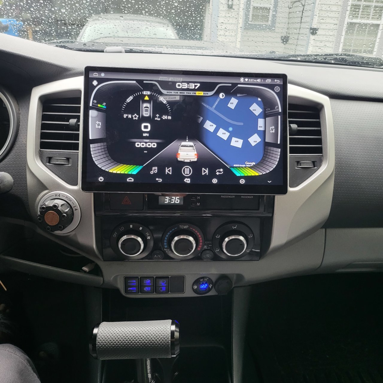

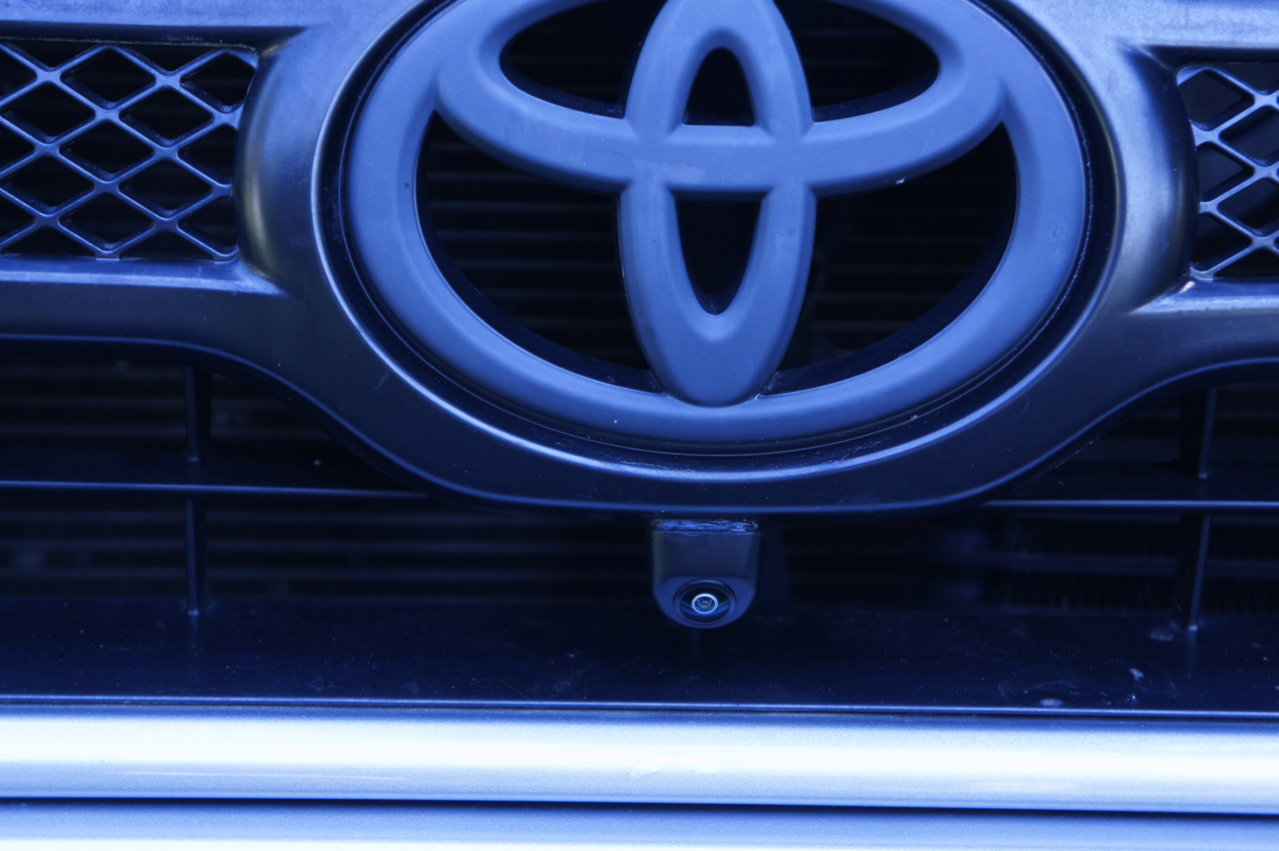

    I installed a HW button that supplies power to the aftermarket front camera. CarLauncherPro tells Joying display the front video/view.

    GibbsTacoma
    GibbsTacoma Well-Known Member
    Dec 17, 2017
    #238715
    258
    Charlotte Metro Area
    2010 Tacoma TRD Sport DCSB 2wd
    Where did you get the camera?
    Also, I like that screen. Is that a option for Joying or did you upload that?

    Front and rear cameras are on a two separate circuits. When the key is turned to acc or start the front camera can send power through to the front camera. The CarLauncherPro tells Joying to display the front view.
    Assuming front camera is on. When in reverse, the rear camera comes on and has priority over the monitor. I can put the car in reverse the rear camera come on, shift to drive the front camera comes on. Handy in parking lots, and on trail.

    Camera is off Amazon, nothing special aftermarket China special.
    Screen is aftermarket app “CarLauncherPro”.
