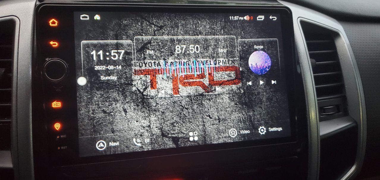

    I was able to add reverse guide lines. I tried the carpro launch app but I ended up uninstalling and refunded only because I personally didn't care for it when i actually played with it. Ill just stick with the joying interface. I did add a custom background that im satisfied with.
    Does anyone know how to add a boot logo?

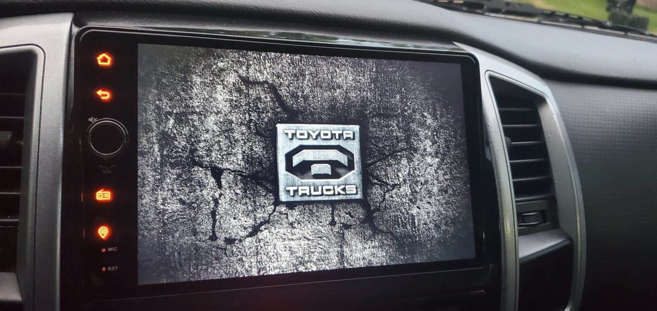

    2010 Tacoma TRD Sport DCSB 2wd
    Anyone knows how to add custom boot logos? I asked Joying and they sent a video but part of it is cut off. The options to make changes to anything are all over the place for these recievers. No big deal but it would've been easier to sub these options under settings - display, rather than enter the 4 digit code for additional options.

    There on one of the android launcher apps. Not sure which one but if you search up "tacoma, joying" on youtube there are videos of people adding the boot up logo. It is not on the unit itself, but the option is added once you find the right launcher, I think Nova Launcher, Car Pro Launch and several others have the option of adding it. Some one else will surely chime in and let you know what app they're using.

    I finally got the logo on. I figured it out. U gotta create a file, then save on the USB then upload.
