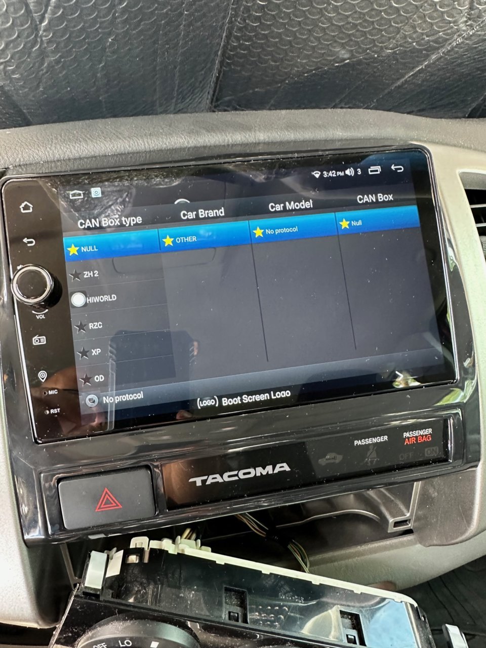

    I have been at this all day. Trying to figure out the steering wheel controls. Tried programming but it is not liking it.
    What I do notice within the Joying steering wheel setting without pressing any steering wheel buttons, it starts to flash between the message "please hold the button on the steering wheel into the learning state" and "Please select learning function button"
    This flashes back and forth. I also found this link: https://www.joyingauto.eu/blog/post/how-to-connect-the-joying-car-stereo-back-wiring-cables/
    And connected the wires trying both "Can-out and Can in" and "Can out and Key" and same thing.
    I also read about the Canbus not set. I looked at factory setting and it is set to Null see picture attached.. I looked throughout all options and couldn't find one for Toyota Tacoma. I see for other Toyota models.
    Any help or guidance greatly appreciated.
