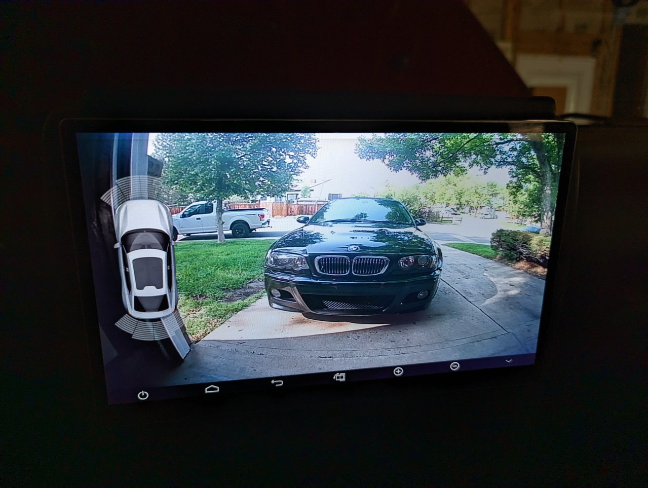

    Like the image or build quality? The AHD camera that came with mine looks really good on the 11" 1080p Joying display. The build quality...is ok. It cut out completely during some of the super cold days over the winter. And the hinge for it is kinda rusting a little.

    The image lol. Build quality seems middle ground but the image of the camera they gave me is pretty rough. Looks like a backup camfrom the early 2000’s lol. But I lived without one for a year or so so just having one is good enough haha

    I think they will all look bad because the connection to the HU is a RCA plug, which max resolution is 420p - on a 9/10/11inch 1080p screen that's going to look pretty rough. Honestly, doesn't bother me too much - not the most premium but it does what it needs to do.

    They use AHD, Analog HD, so they can send 1080p over RCA. It looks great on my Jeep's 11" Joying HU with 1080p screen. If you have the 1080p screen, make sure you're getting the Joying AHD cameras and not a regular backup cam. They are different!
