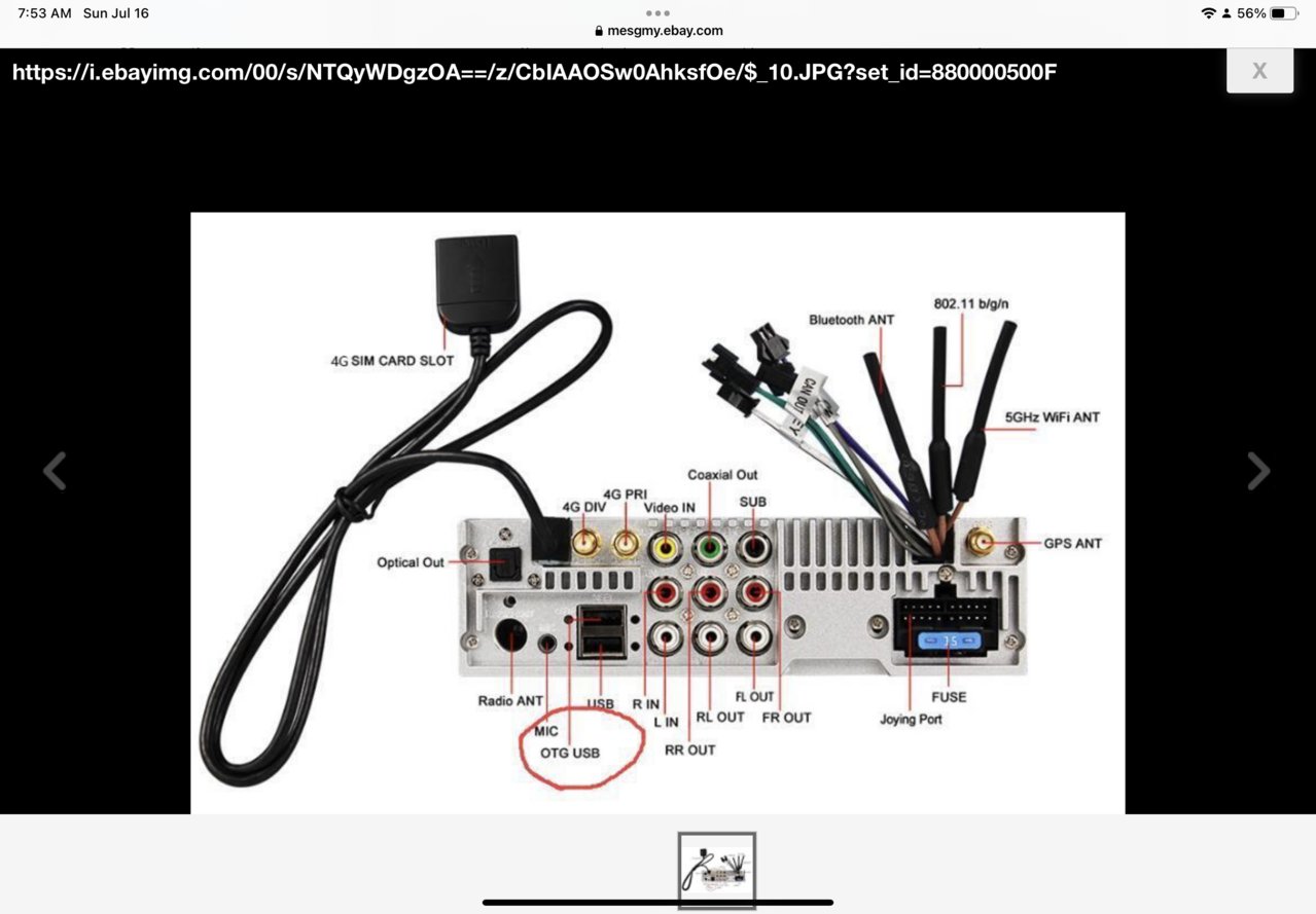

  6. Jul 14, 2023 at 5:57 AM
    #1206
    Jtaoj0
    Jtaoj0 Well-Known Member
    Feb 16, 2015
    #148854
    186
    Hi, of the three usbs on the unit! Which is the signal?
    also, which front camera did you go with and any insights on how best to wire it? I bought a 15 cam, seems straight forward but not with a switch. Doe your front cam work as soon as you click the switch on or do you have to go into apps?
    thanks!
    edit: heard back from Joying, with instructions to use the OTG plug. Mine has a third USB on a wire coming out of the black SIM area.

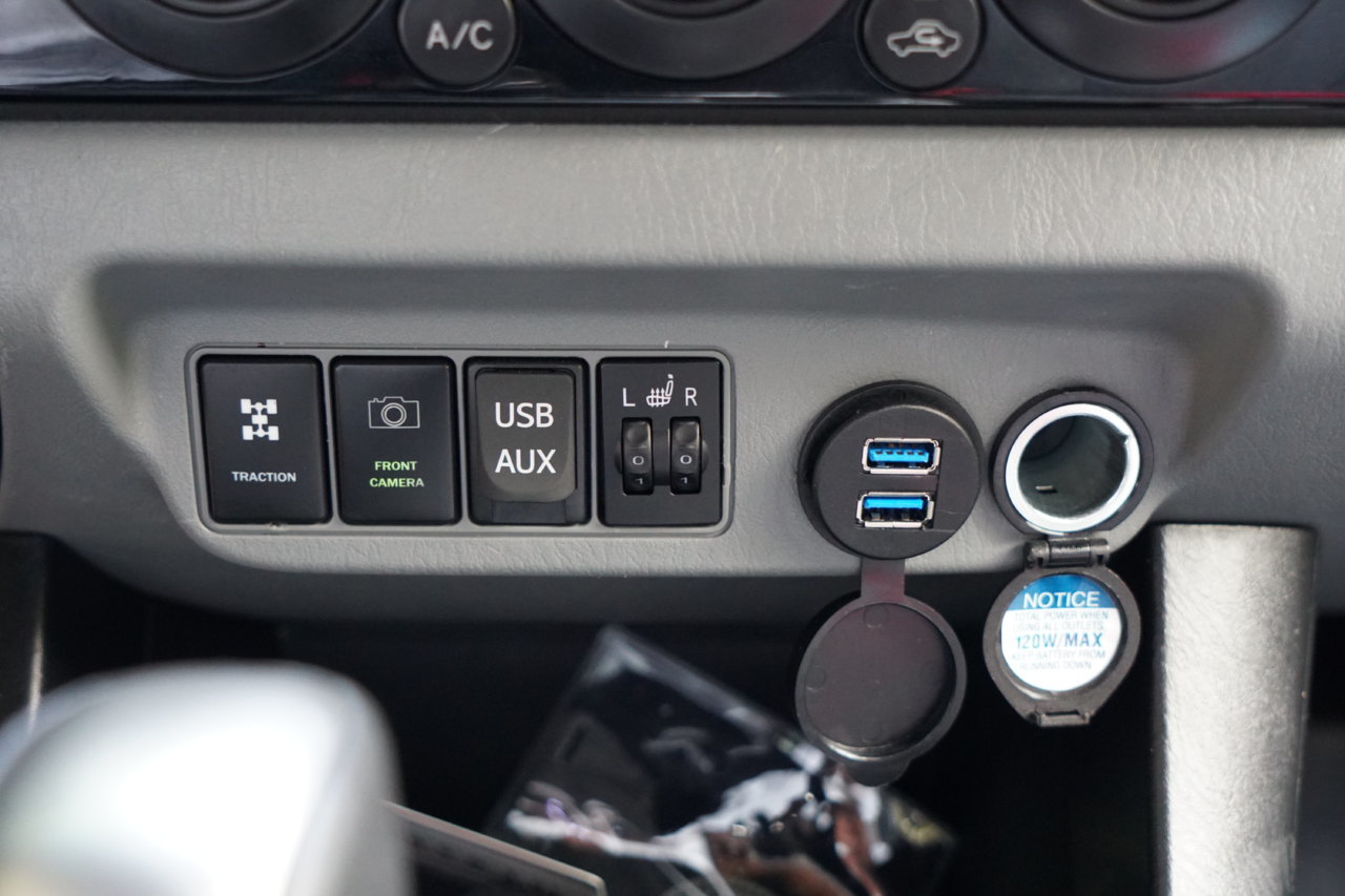

  7. Jul 14, 2023 at 7:09 AM
    #1207
    rnish
    rnish Well-Known Member
    May 9, 2014
    #129450
    8,606
    Peoples Republic of Maryland (USA)
    Tacoma 2nd gen
    King's, Camburg UCA, Dirt King LCA, armor
    Joying tells you which is signal vs power. If I remember correctly it’s also a different plug. Connected to the OEM USB AUX plug.
    I added a power switch to the camera it’s connected directly to the battery there is a 5 amp fuse in there somewhere. Otherwise the camera would be constantly on. Parasitic power loss. There was no convenient switched power under the hood (YMMV).
  8. Jul 16, 2023 at 1:45 PM
    #1208
    Jtaoj0
    Feb 16, 2015
    #148854
    186
    So the power is the red wire at the camera. Did you just connect that to the battery? There is a wire near the RCA plug for signal. On the front camera, what did you connect it to? Than
    Nike.

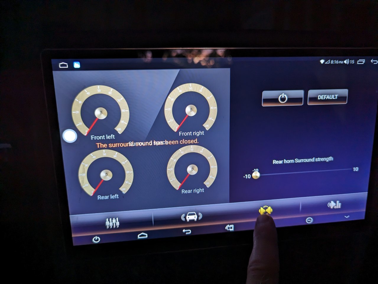

  11. Jul 17, 2023 at 12:58 PM
    #1211
    scootter82
    scootter82 Well-Known Member
    Oct 2, 2016
    #198816
    2,028
    Aurora, CO
    Forgot about the pic. But it's in the EQ app, and it's one of the four tabs at the bottom of the app. It may or may not be on, mine was. And it allows you to adjust the volume levels of each speaker independently

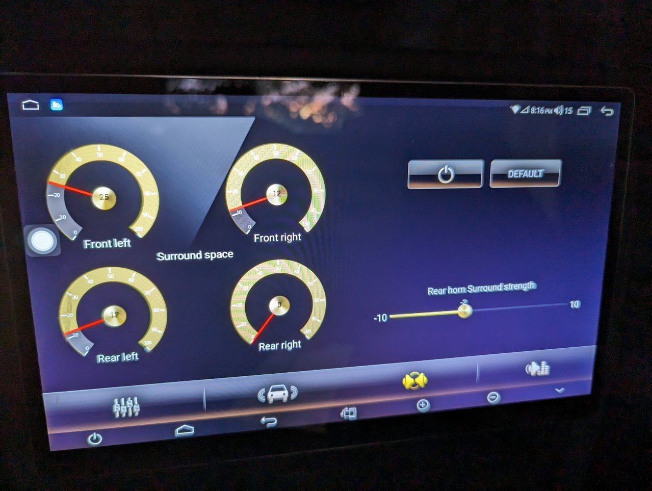

  13. Jul 17, 2023 at 7:18 PM
    #1213
    scootter82
    Oct 2, 2016
    #198816
    2,028
    Aurora, CO
    Pics. You can see when I turn it on, it sets each speaker to a different volume
  14. Jul 17, 2023 at 8:51 PM
    #1214
    GilbertOz
    GilbertOz Driver
    Oct 18, 2018
    #269844
    1,888
    CA
    2014 AC V6 MT 4WD, 84K miles
    FOX 2.5, Deavers, ARB, OTT, 4xInnovations
    Err, I want to make a clarification here -- at least on my JOYING unit, and I suspect on all of them, this is not a volume adjustment panel. Rather, it lets you adjust the delay (in milliseconds) for the audio coming from each speaker. Its purpose is to allow you to time align the system so that the Left and Right stereo channels arrive at the driver's ears at the very same instant -- plus or minus a tenth of a millisecond.
    Most average car head units lack this feature, which is why most car audio cannot have good stereo image reproduction. But with time-alignment offsets it's possible to adjust for the asymettrical distances between speakers and the driver's ears. Once properly corrected the stereo imaging magically reappears. Read more about time-alignment here: https://hometheaterhifi.com/technic...-the-most-out-of-high-fidelity-audio-systems/
  15. Jul 18, 2023 at 7:57 AM
    #1215
    scootter82
    Oct 2, 2016
    #198816
    2,028
    Aurora, CO
    Ah ok, I just assumed that was volume settings :)

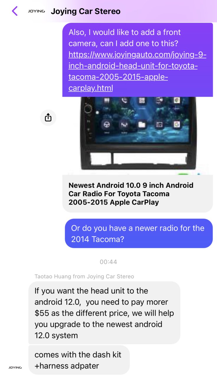

  16. Jul 18, 2023 at 9:41 AM
    #1216
    Naveronski
    Naveronski Well-Known Member
    Sep 14, 2013
    #112501
    9,517
    Fort Worth
    2014 MGM DCSB TRD:OR
    Thought this was interesting. Have y’all seen the newer unit?
  17. Jul 18, 2023 at 11:09 AM
    #1217
    scootter82
    Oct 2, 2016
    #198816
    2,028
    Aurora, CO
    You can upgrade older units to Android 12. It's on their blog support page
