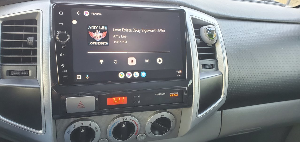

    Gotcha, thanks! I found it while playing around yesterday, mine was off by default. Figured out the bass enhancement section is what I was looking for...really brings out the lower rumbly bass that I love. Now I can actually adjust the EQ properly without it swinging way to far in one direction or the other lol.
    Interesting that your UI looks very different from mine as far as style goes. Layout seems identical though...I'm guessing you just made some changes through the system for a different look?

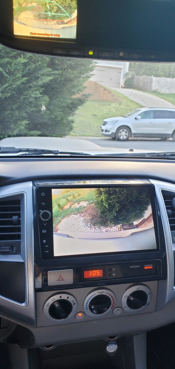

    Hey which method did you use to get the rear view camera into the HU?

    I used the spliced wiring from my rear view mirror (have the reverse screen) then convert to a male plug, then connected to the reverse female from the Joying wiring harness

    Ok thanks. Was there a post to show how this was done? Or where the wire is. I read all the post maybe I missed it.

    I'm sure there are post on here. It's not too bad though because all you're doing is tapping into the existing connection of the reverse camera if you have that feature. If not then you can either tap into the reverse bulb wiring or the right fuse. You have two connections (power and a signal).
