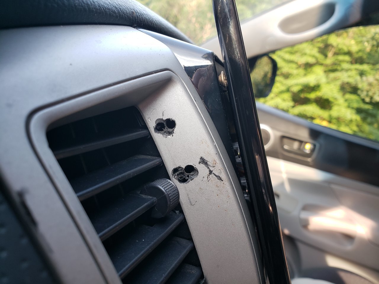

    So I just installed the Joying 11.6 in my 2009. After 2 days of trying to get the dash trim clips to hold the unit tighter to the dash, tried different size clips (they did not work), tried tape on the bezel protrusions (no change still slight movement) I drilled small pilot holes and used 2 inch drywall screws, just tightened them to secure the bezel to dash, I did not crank them all the way down. The heads protrude slightly but with the screen on you cannot see them at all and they don't touch the back of the screen It tightened it securely to the dash. No issues on normal roads, have not been off-road yet so I can't attest to that but it is now tight to the dash now with NO squeaks or movement at all.
