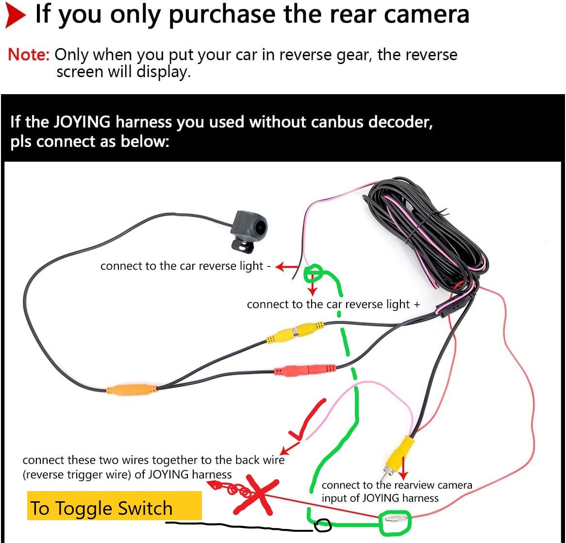

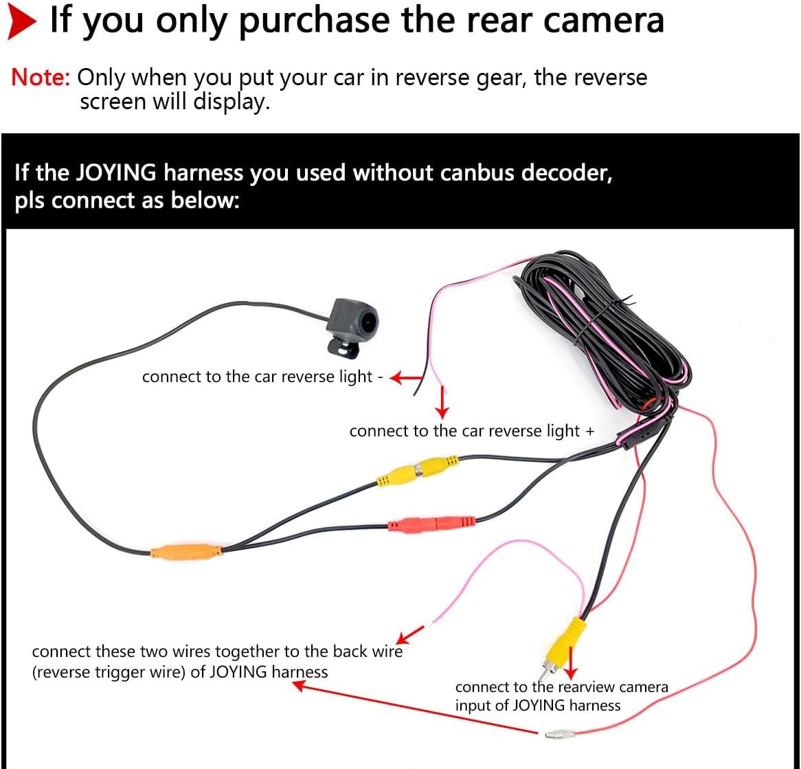

    With the canbus, no. I wired exactely how they illustrated in their instructions.
    Without the canbus, instead of using the + & - from the backup lights I used a switched power source and ground. That switch was from my outgoing backup camera set up.
    Wiring with CANbus
    Without CANbus

    In your picture if you wired it exactly "With" a Canbus it has no ground and the camera will not work. Especially if you have the camera mounted to plastic. Might work if you have it mounted to metal though.

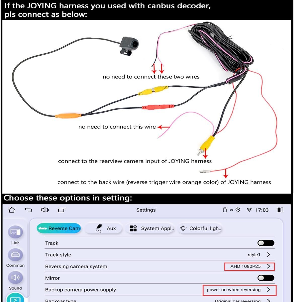

    I got it figured out. I checked for ground or lack of and found that the camera was grounded in each wiring scenario. So the ground wasn't the issue. I then looked at the third illustration on the Amazon page for the camera. This one is for "if you bought the front camera too." I noticed the red wire (with the male RCA) from the backup camera supplied power to the front camera. My thought was to connect this red wire with the (+) reverse light wire and then to a 12v power source. I would then connect the pinkish/purpleish wire to the back wire. I put the car in reverse and the camera worked! I then connected my toggle switch and the camera worked without putting the truck in reverse. It's 96 with the relative humidity of 67 in my garage which makes it like 120. I'll run everything tomorrow morning before it gets Africa hot again.
    What I did

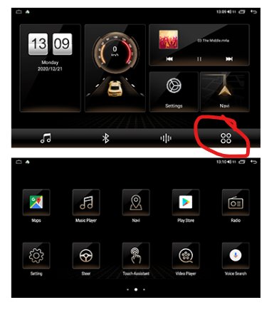

    Has anyone had any issues with the 'apps' button not working? I have the 10.1" (listed here) and I recently went into the settings and adjusted the brightness levels and changed the startup logo. After doing that, the app button no longer works. I can click on it, but it just returns to the home screen as soon as click on it.
    In this photo, its the button on the bottom right that I circled. It would usually bring up the screen on the bottom, but it just goes blank and then returns to the home screen.
    I reverted the settings back to what they were before with no success. Ive rebooted the radio and also disconnected the battery with no luck. Anyone ever experience a similar issue? I've got a video I'll see if I can upload later to show exactly what its doing...
