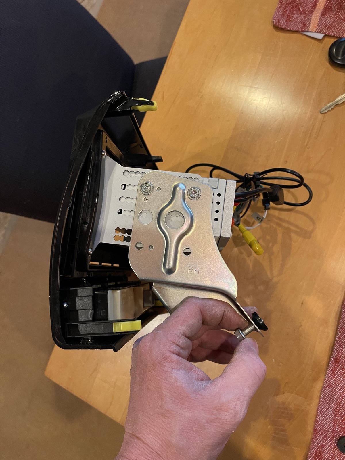

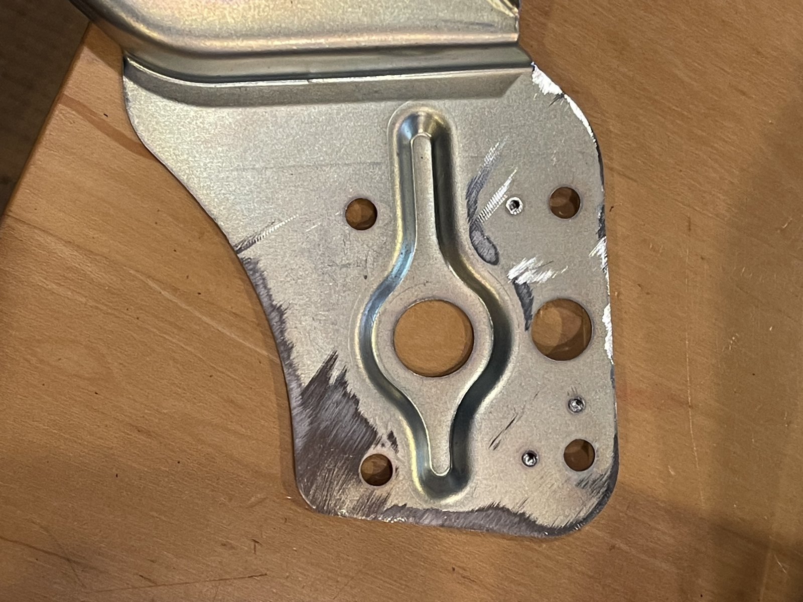

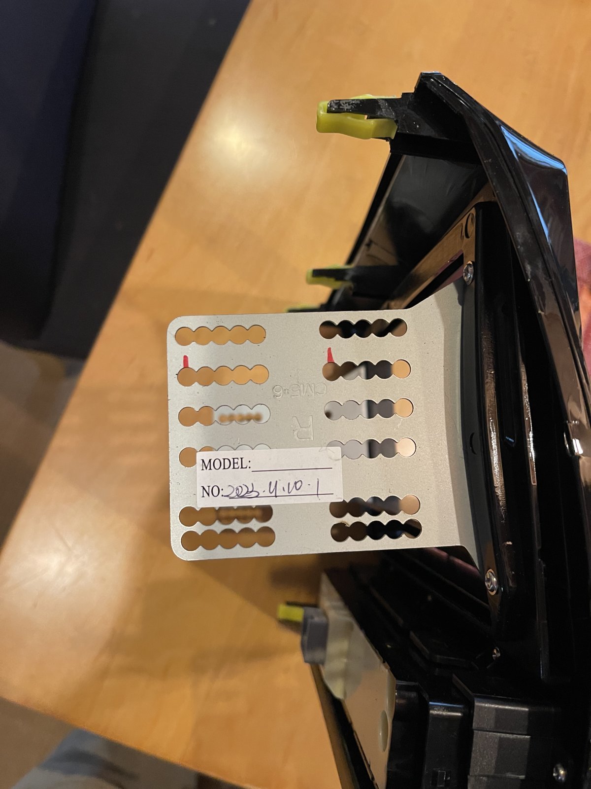

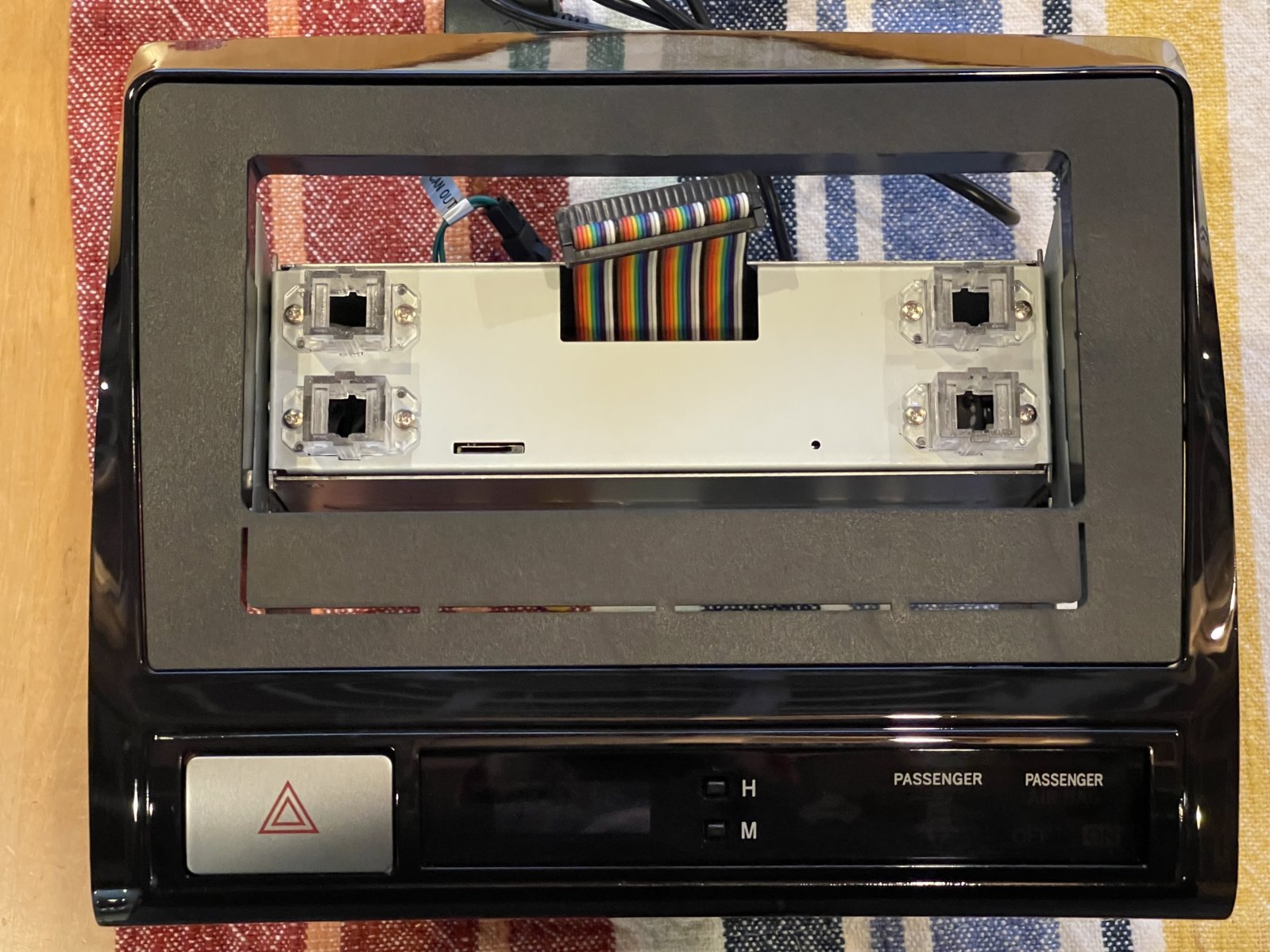

    You will notice the R is on the left side. Comes from the factory backwards and is correct. The hole pattern is not far enough down if right to right and left to left, you can see in picture. I tried it, so don’t bother.
    You must file down the 3 alignment points on the bracket for it to sit flush. Screws go through holes marked in red.
    I do wish there was more space for the face plate when it is snapped on. Definitely wish there was another 1/8”. It sits very tight. Will see how it holds.

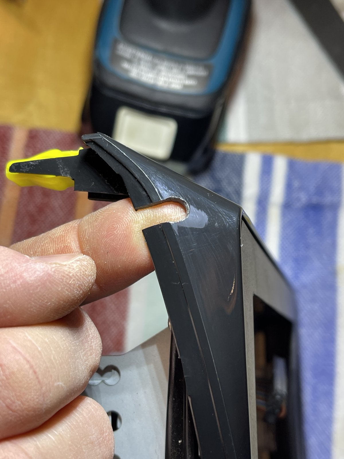

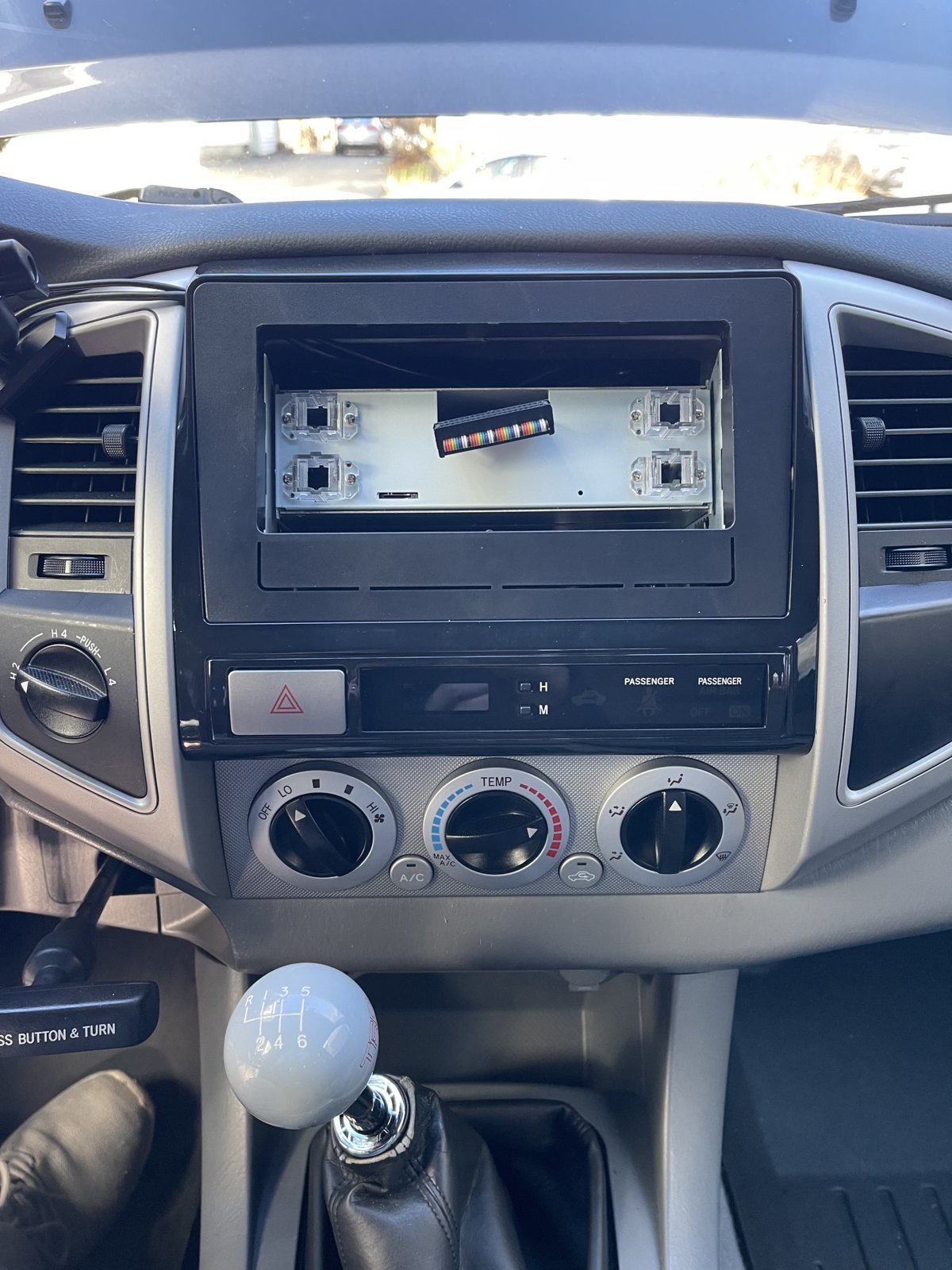

    Thought I may need a spacer but you don’t.
    This is everything screwed together.
    Top part of the face plate needs to be removed.

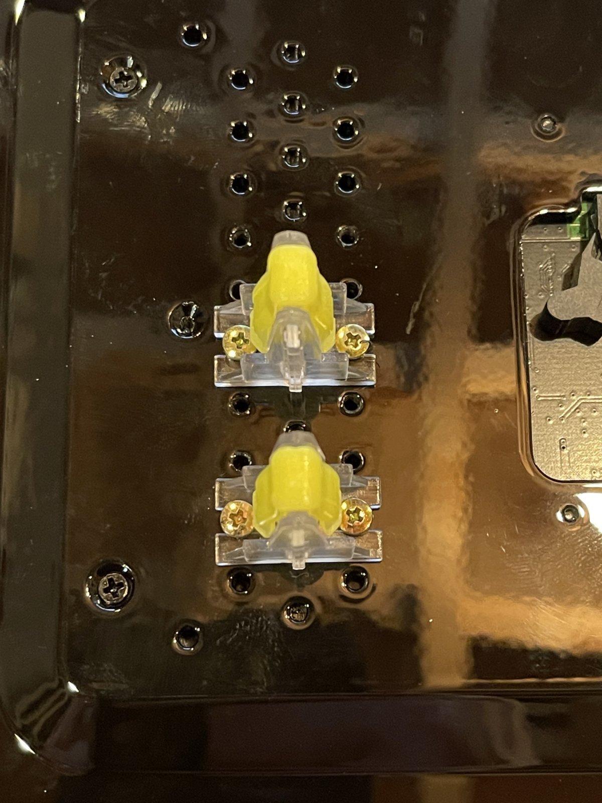

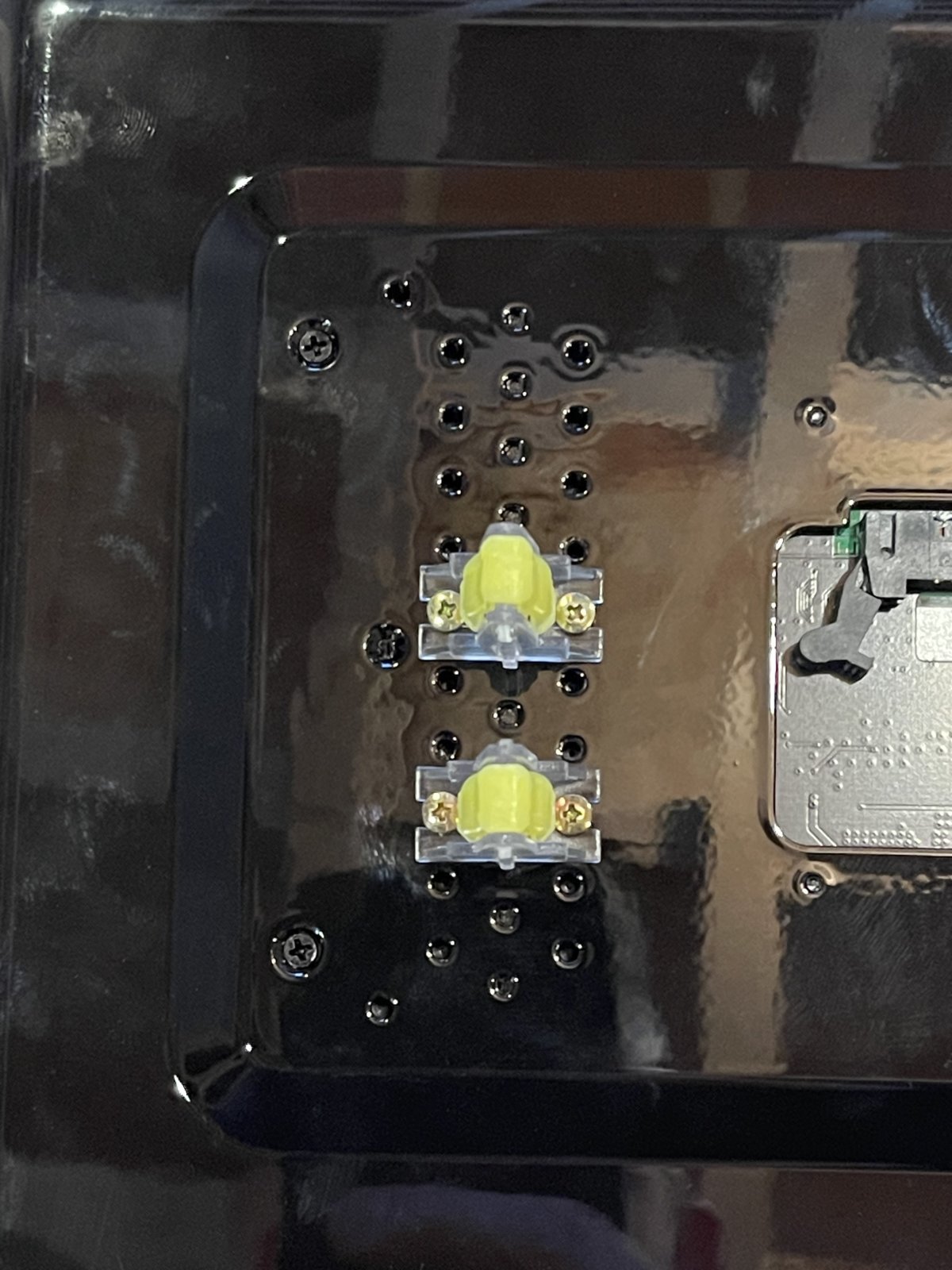

    Mounting points are moved down one spot to raise the screen about 1/4” higher.IMG_9693.jpg IMG_9694.jpg

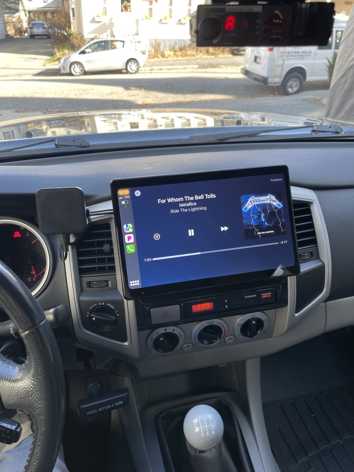

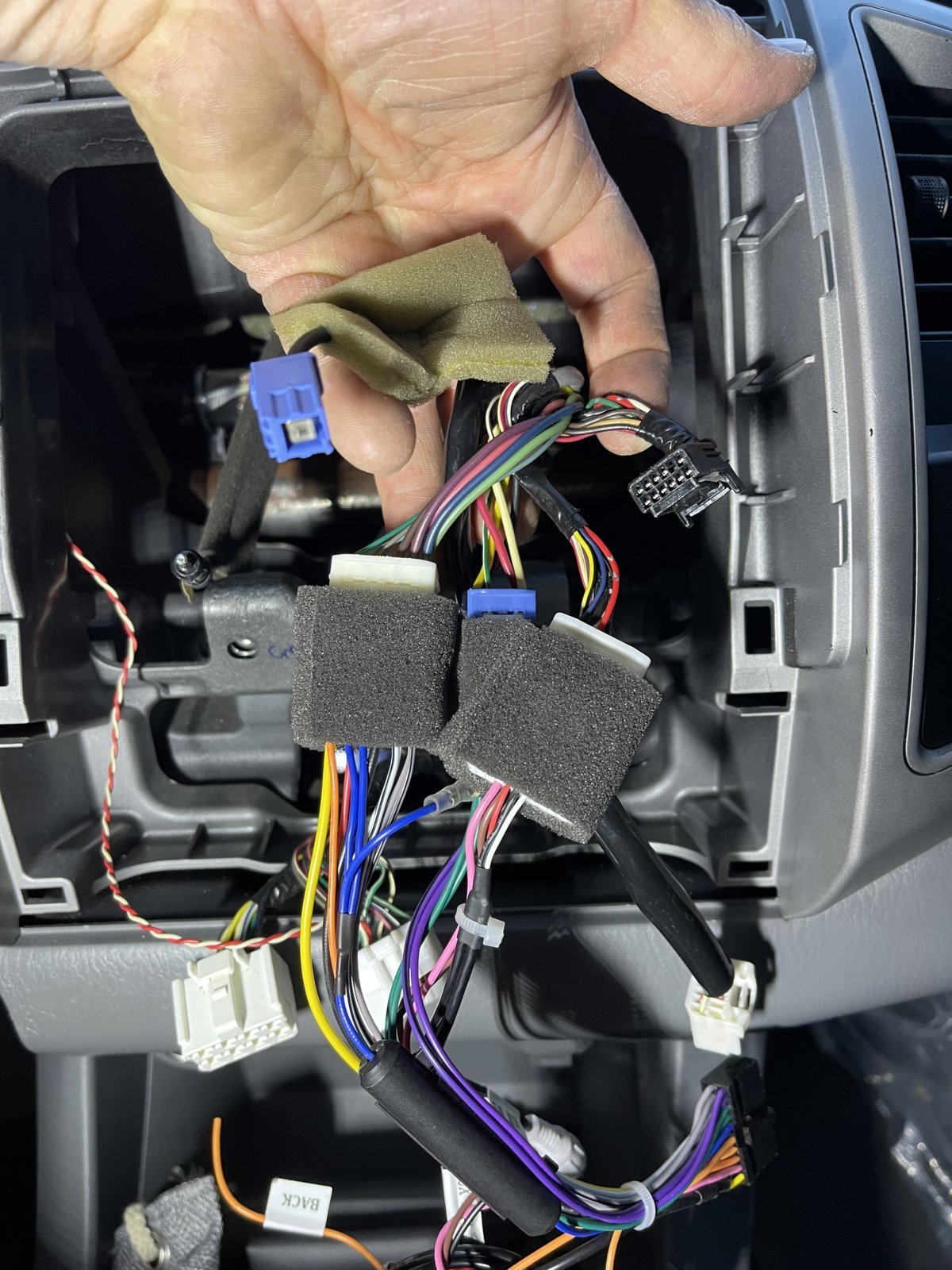

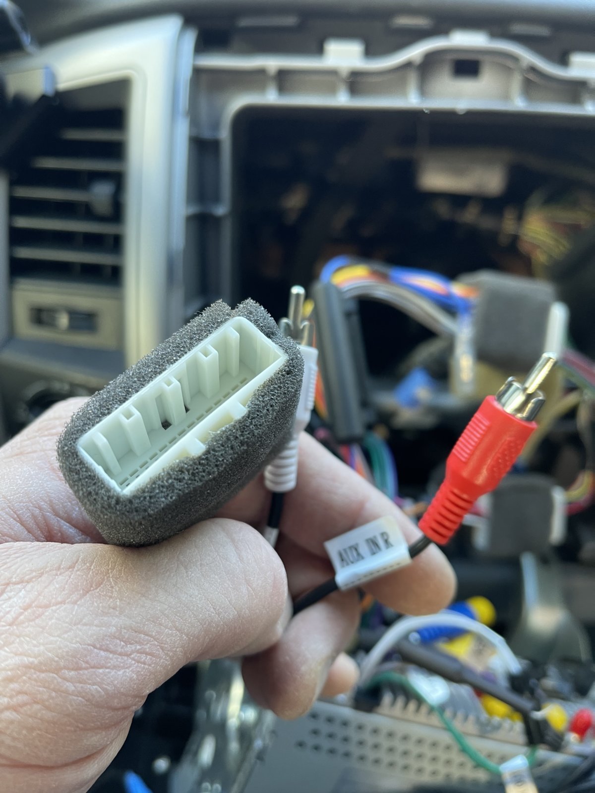

    Blue and black not used from truck, white not used from harnessIMG_9672.jpg IMG_9697.jpg

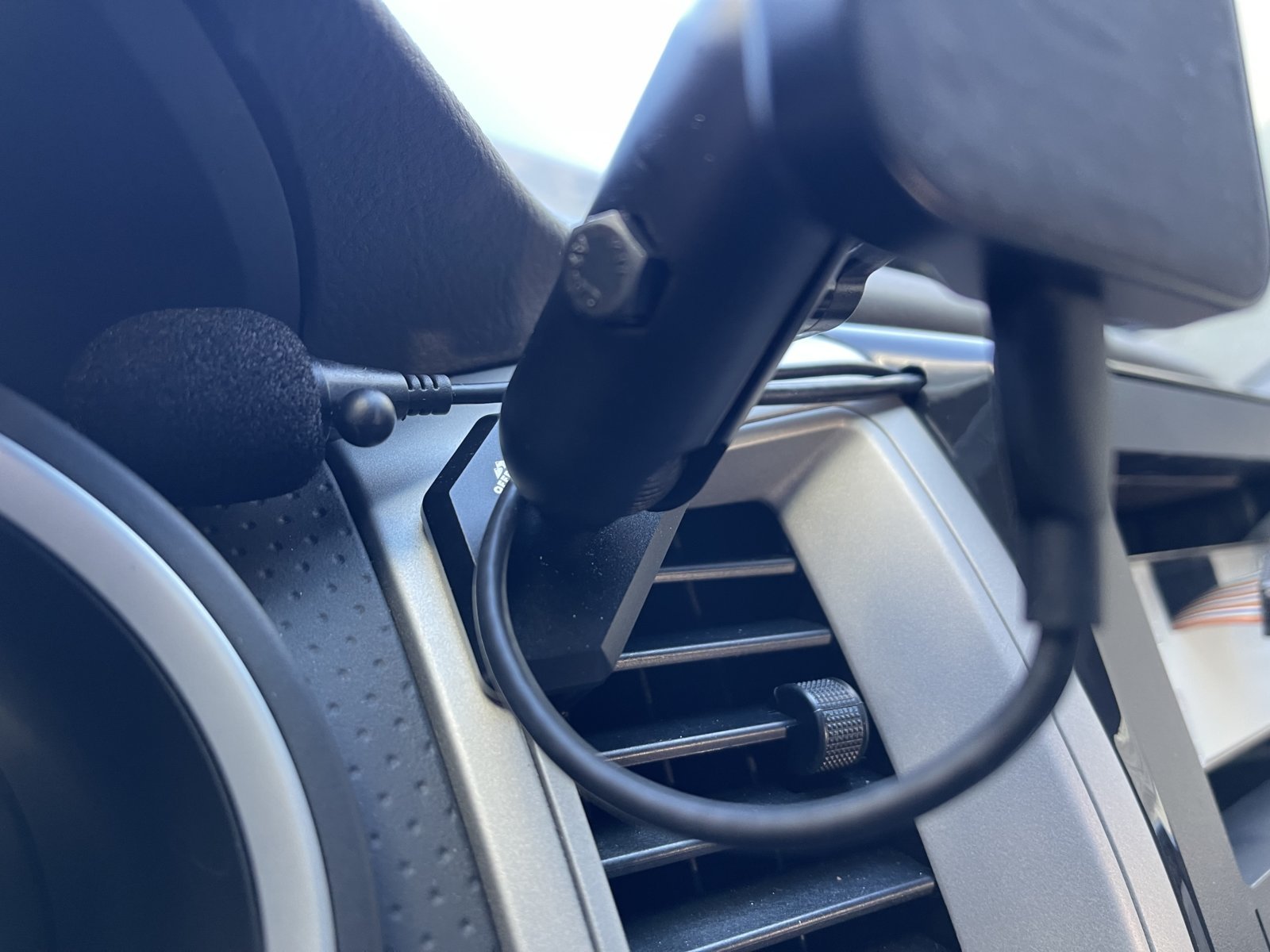

    I will be hooking up cameras in the future.
    Also will hook up usb port to transfer data for custom Home Screen.
    Still need to test gps signal and a bunch of other things, like how the phone connects and what can and cannot be used without disconnecting from car play.
    Sounds better than stock
    Like I said before
    I do wish the screen would sit further off, but would require custom mounts
    Fyi
    The OFFROAM phone mount is awesome.
