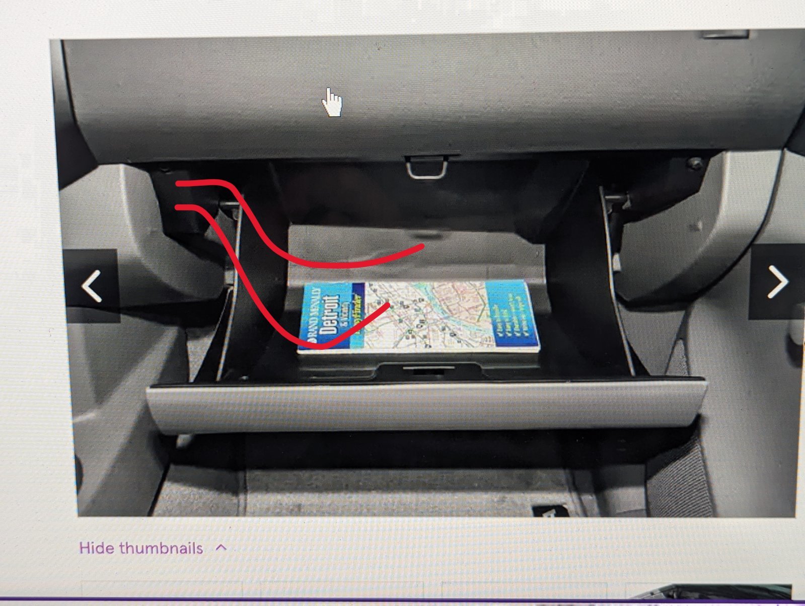

    The cables are long enough so initially I routed them down and over the left side (wall) of the glove box. Super easy especially when the HU isn't fully in the dash. The cables do not interfere with the opening or closing of the box. Once I was settled with what I had on the two thumb drives, I stashed them in a cavity next to the glove box.
    Here's a couple of pictures with a crude illustration of what I'm trying to explain. I robbed the picture off the inner web.
