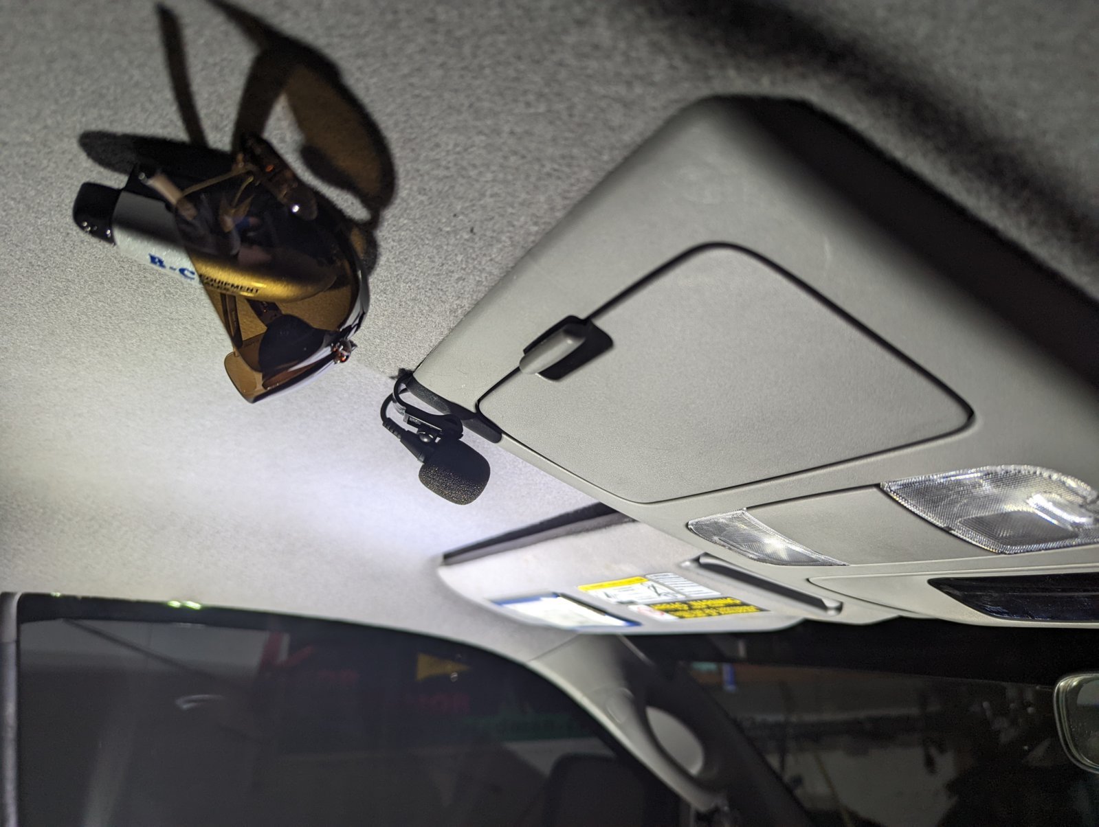

    I never tried the built in mic, but the mic they included works great in my truck. Not one complaint on how I sound or outside noise. I do have a two part sound deadening system throughout the cab and doors. Also, I have the mic mounted just to the right of my head.
    I do recall others trying another mic and being happy with it. I'll check to see if I can find something.

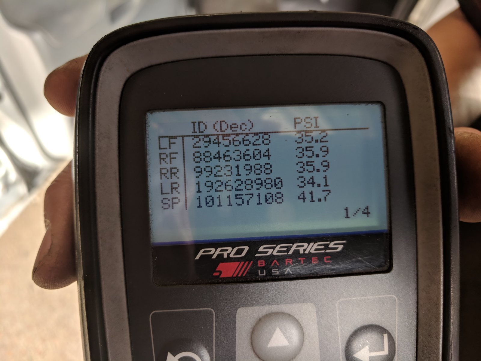

    Is there a way to verify that it will read 5?
    You'll need to find someone with a scanner, like a tire shop and they can also sync each TMPS with the ECU. I also understand each one has an individual ID number, if you have those ID#'s it would be helpful if any sync issues come up.
    Also, I recall seeing somewhere that it will recognize "low pressure" but won't tell me the actual pressure. Is that correct?
    Seems like I've seen actual PSi readings on this thread. I do know my SG2 reads pressure for all 5 but not the location of the tire. Had to figure that out myself. Honestly I don't monitor the tires with the SG2, only trans fluid temp, coolant temp, RPM and MPG.
    Here's a picture from when I bought new tires and replaced the sensors.

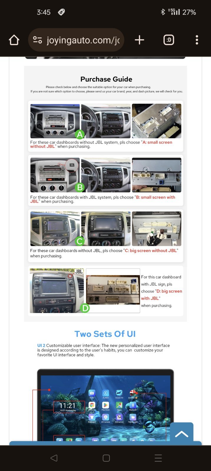

    I'm a little confused about some of the options. In particular, the the JBL, and small/big screen options.
    My truck currently has an aftermartket alpine stereo, and the JBL system. I do plan to eliminate the JBL amp/speakers before too long. But I noticed that the different options, also change the inputs/outputs In the back of the H/U. Which should I choose? For the record, my truck originally had JBL/Small Screen.

    @JeffBoyardee -- Here's my interpretation; since your truck originally had the JBL/small screen I would think you'd choose the big screen Joying HU.

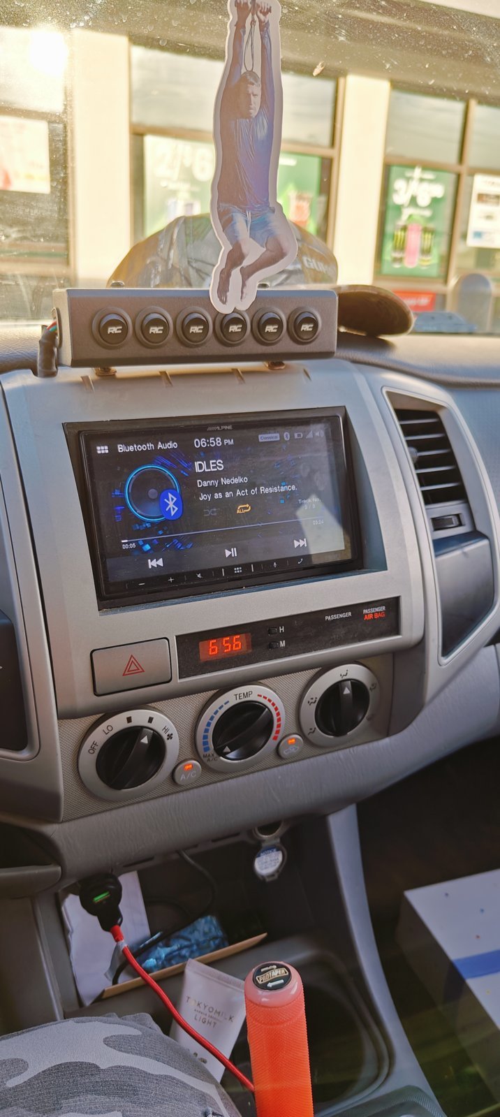

    What does your current setup look like, does it still have the original bezel holding your current Alpine unit? Picture maybe?

    Aftermarket bezel holding my current head unit.

    Still think your choice would be the big screen.
    My original setup was the 6 disc non JBL . Option A in the picture of the "purchase guide."

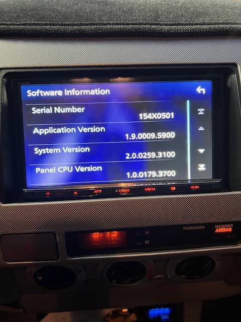

    How to i find out the model # for this. I lost the box and info in a move. This head unit has been glitching and reboots at random. I have been dealing with this about a two years. this is not my daily. What would be a good upgrade for this? or do i need update the software?

    Seems like the serial number should be helpful with finding the model number of your head unit.

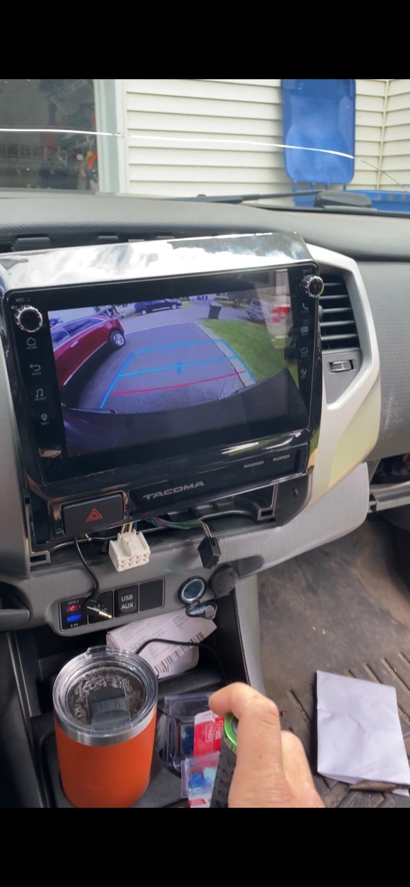

  17. Apr 18, 2024 at 8:27 PM
    #1457
    GHOST SHIP
    GHOST SHIP hates you.
    Mar 9, 2015
    #150537
    22,398
    GHOST

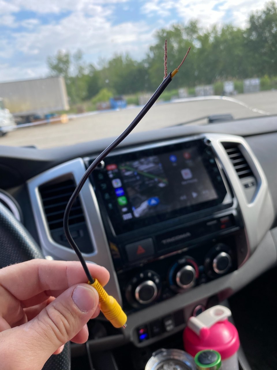

    So I just installed mine in a 2015/non-jbl and can’t figure out what I’m doing wrong to get the factory reverse camera to work. I followed the video and your post about the orange wire (vs purple). When I shift to reverse, I get a black screen and “no signal” text. So the head unit is receiving the signal that I’m in reverse, but no video feed. Any ideas from the collective group? Everything else works great so far
    P4x4 and E-Paz 732NJ[QUOTED] like this.
  18. Apr 19, 2024 at 7:38 AM
    #1458
    secondgear
    secondgear Well-Known Member
    Oct 3, 2023
    #434786
    61
    Texas
    2014 Prerunner V6 DCSB Barcelona Red Metallic
    Try going into Settings -> Display -> Rev Camera -> Reverse Camera System and choose CVBS N
  19. Apr 19, 2024 at 6:58 PM
    #1459
    GHOST SHIP
    Mar 9, 2015
    #150537
    22,398
    GHOST
    You nailed it. Thank you sir!
