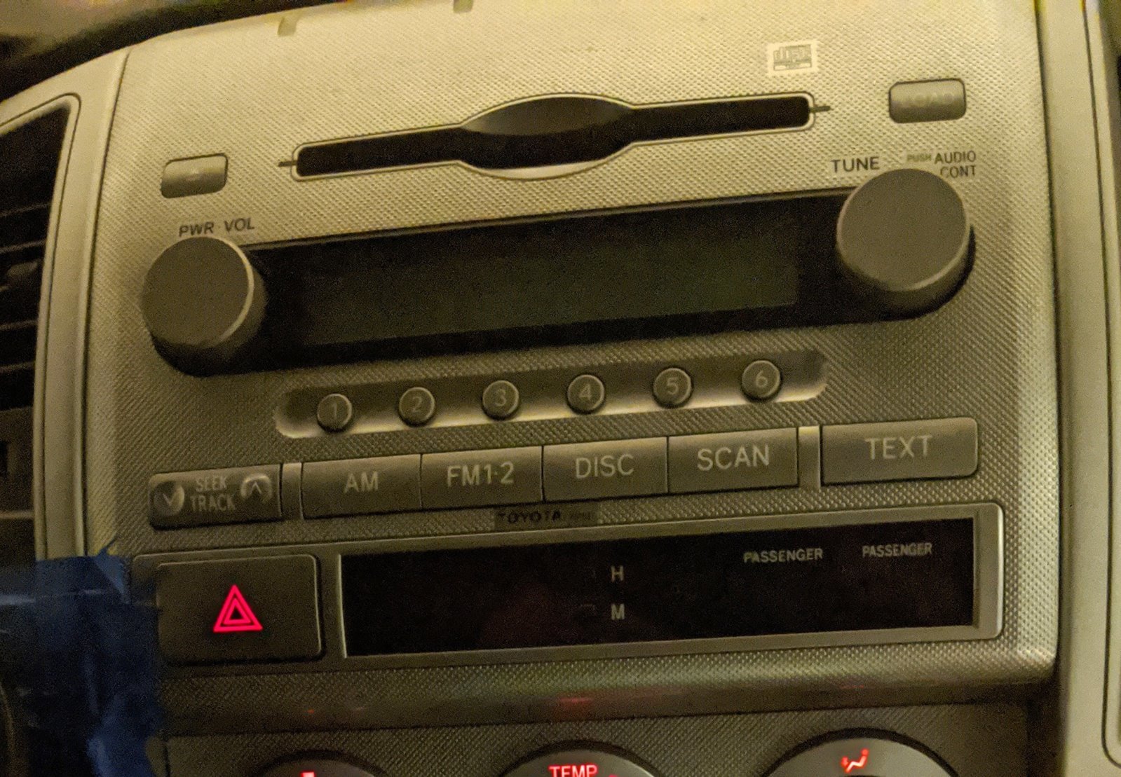

    I can not with any certainly answer your question.
    I do know that there are numerous posts in this thread from those who have installed Joying head units with the big displays. Maybe look back in this thread for those posts.
    @JeffBoyardee included an purchase guide sheet for that radio with the different options, which depends on what your original radio looks like. Maybe direct your question to him.
    Good luck, hope you find an answer to your question.
    Going by that guide sheet and knowing what stock radio was in my truck, my option would be A.
    Here is my original non JBL radio.

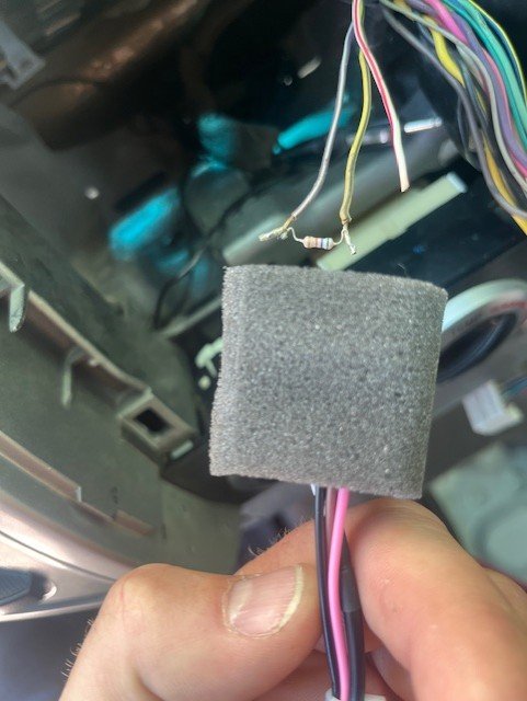

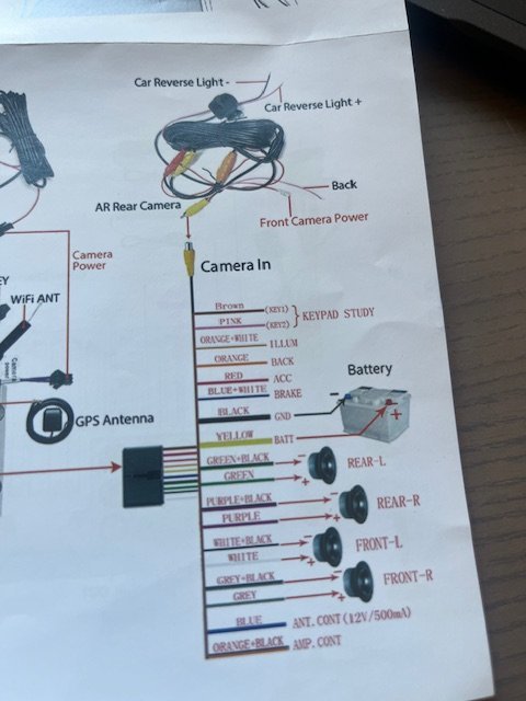

    I have an issue I hope someone can point me in the right direction. I am installing a 9" with button on the left side in a 2007 with steering wheel controls on the left side of the wheel. The previous head unit required an SWC adapter that required splicing in a resistor and connection to the red wire below.
    With the joying pin out manual in hand it indicates key 1 and key 2 (key pad study) hit the pink and brown cable which is split to two connectors. There is a third black wire in the bundle
    Since I have chopped the stock(20 pin connector) can someone tell me which wires to connect to which to regain control of steering wheel controls ?
