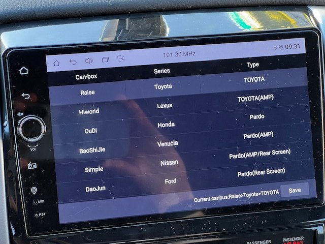

    Finally decided to invest in a head unit, read all this thread from 1->75 (very helpful!). I bought their "newest" 9'' (w/ Android 12) and my taco is a 2015 with the OEM reverse camera video on the head unit (option C on Joying options).
    Installation is very easy (used YouTube video to understand how to remove the previous head unit without breaking anything).
    With the Toyota harness provided it is very straight forward (I ended with 2 stand alone plugs not going anywhere).
    For the backup camera configuration
    1. connect simply the Toyota Joying harness with the revers camera pins => do not cut or do anything
    2. Configure the camera as @secondgear said on page 73:
    For the Steering Wheel Control
    1. Plug CAN-IN with CAN-out (mine by default was CAN-IN to KEY)
    2. Configure the CAN-BUS with the following options (hit save at the end) and reboot the head unit
    Factory settings code = 8888
    I added their Front Camera as well:
    1. Plug the 2 camera's cables to the head unit
    2. Configure the AR camera as following
    Joying is super responsive on the email for help and support.
    Additional updates:
    1. I ordered my unit directly on the Joying site: tax free and warranty (you can select shipping from US (2-3 days observed)
    2. if you want Toyota logo to appear when starting the unit:
    Goes to Files folder in the App section. Open owner_apk file and select LogoSet.apk
