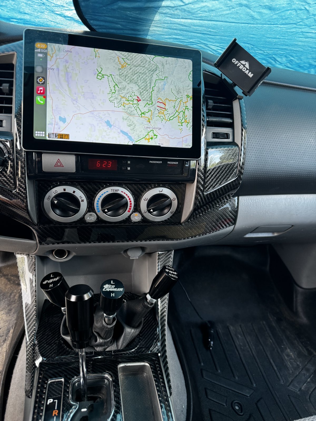

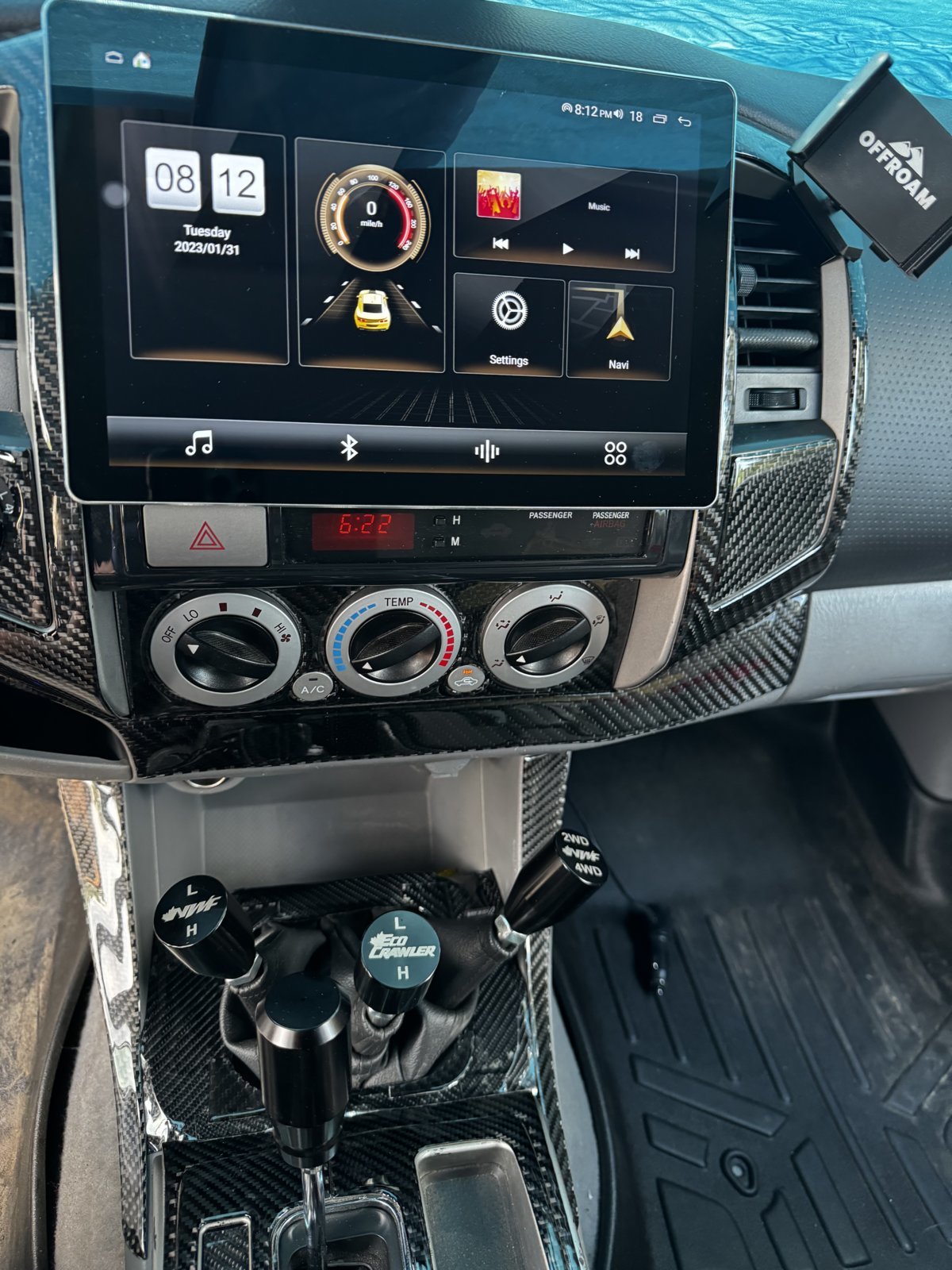

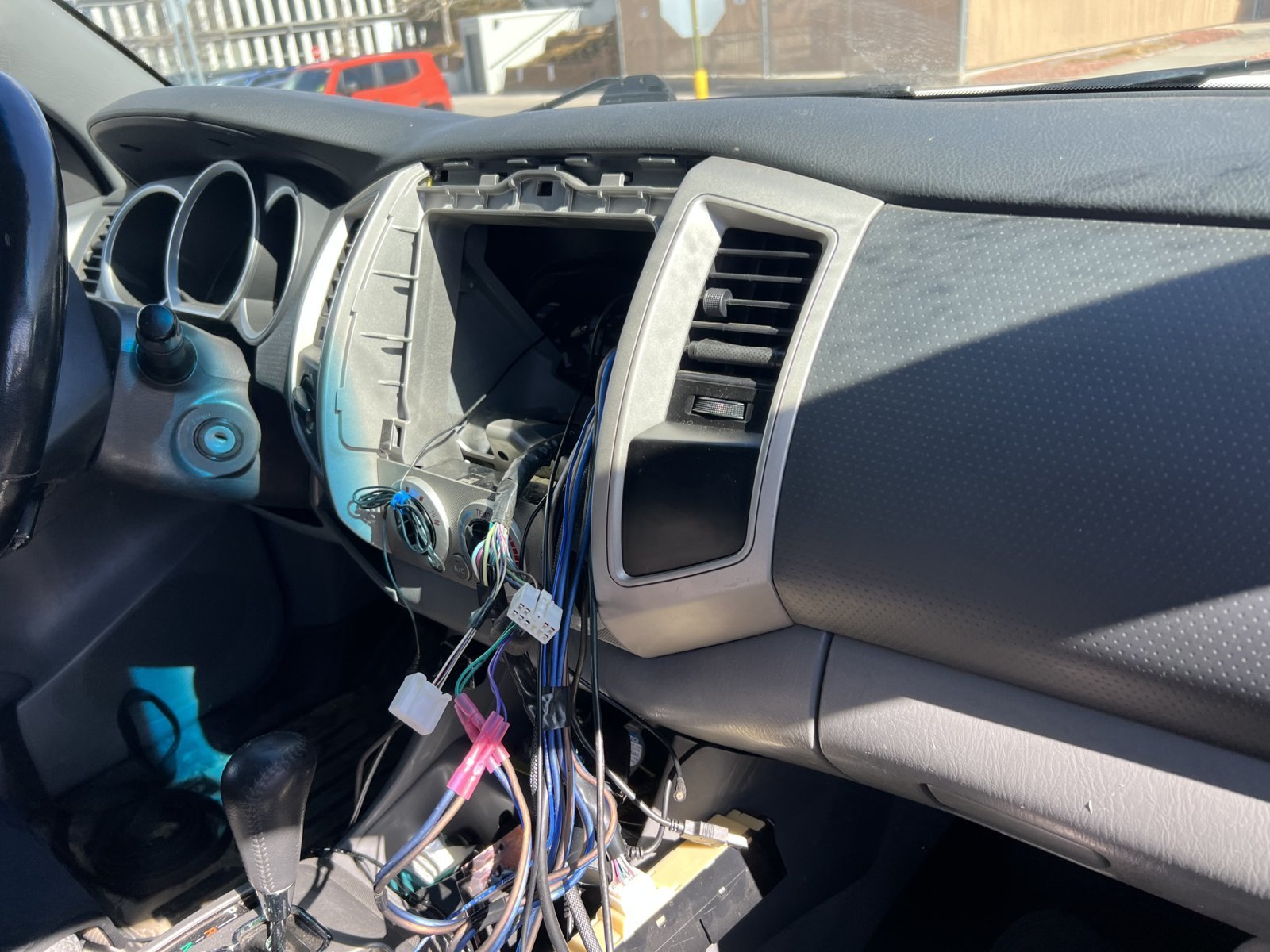

    Had mine for awhile, and it’s a huge upgrade over what I had. Also no longer need my Joying steering wheel controls. Sadly this is my 2nd unit, after my truck got broken into, and the 1st one was stolen (like that was a profitable theft…..).

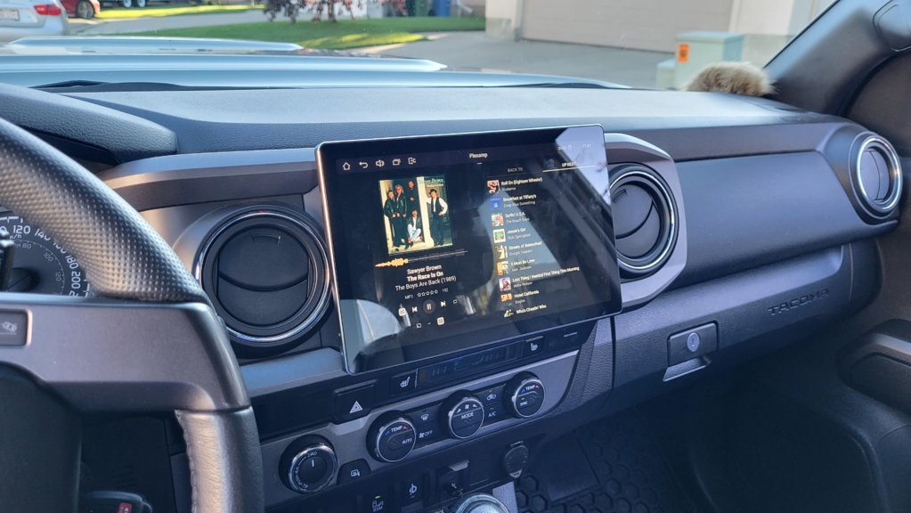

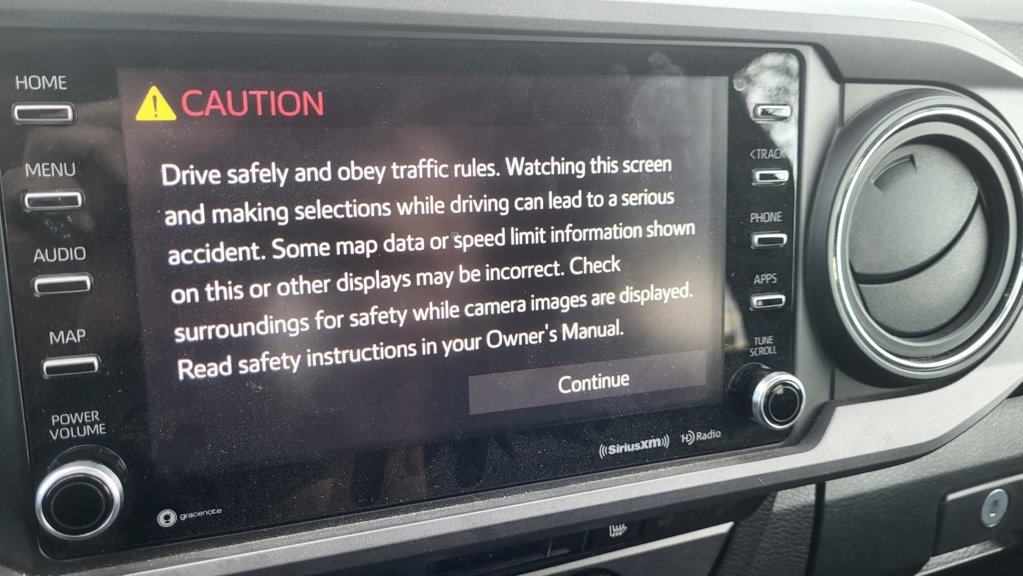

    I finally bit the bullet, and ordered my new 11.5 inch head unit. After some minor modifications to the factory bracket (filed down the alignment nubs, and drilled one new hole in each, after CAREFULLY measuring), I finally got it installed the other day.
    I wasn't sure if I'd like the look, since its much bigger than the factory screen, but it actually fits in nicely with the dashboard.
    I absolutely do not miss that warning screen that I've been cursing for the past year, nor do I miss having to go through a labyrinth of menus to turn off the screen for night driving.
    The sound quality is better than factory (even at the default settings), and while I thought I would miss the physical volume knob, the new gestures feature makes it a non-issue.
    The only problem I'm currently having is that I can't seem to reprogram the steering wheel controls. It says to press and hold the button for 3 seconds, however that does nothing.
    The steering wheel controls DO work exactly as they did with the factory unit, I'd just like to rotate them 90°, so that the volume controls are up and down, instead of left and right.
    I noticed that the vehicle defaults to a 2018 Camry, so I'm not sure if that's the problem. I don't see any Tacoma in the vehicle list.
    If anyone knows a solution to the steering wheel controls, I'd appreciate the insight!
    Edit: One other thought. During installation, there were two connectors that were the same shape, size, and number of pins, however the grooves ensured they only fit into their proper location. The harness from joying didn't have those grooves, so they both fit in both connectors. With a 50/50 chance at getting it right, I just took a guess at where to put them. I'm assuming that I'd be seeing more problems if I got it wrong. Does anybody know for sure which one goes where?
    Before:
    After:
