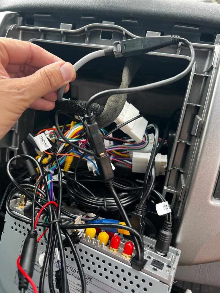

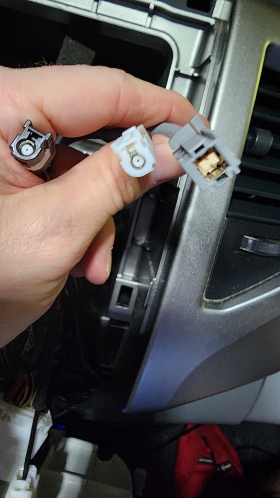

    201
    Does anybody know which cords these go to? I couldn't find a place for them. Which cord is for which essentially. There are 3 total.
    Also the original frame seems to not fit flush due to the dimples on the frame. It won't seat flush against the single din. What has anyone else done about that?

    P4x4
    P4x4 Well-Known Member
    Oct 9, 2022
    #407677
    64
    Pascal
    2015 Dark Gray Tacoma 4x4
    I think I ended with 2 not going anywhere in my installation.
    2nd gen Joying Head Unit Thread
    I need to plug later today the antenna from Joying as the OEM one is not working even if I was able to plugin it to the radio. I will look at my "left=over" and let you know here.

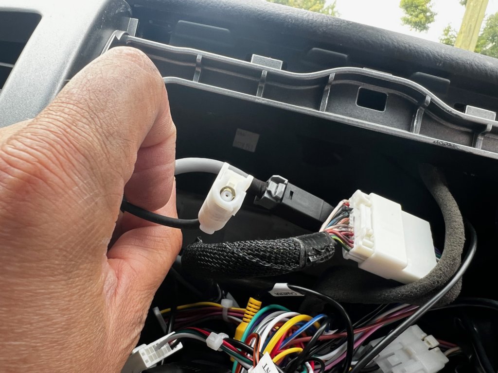

    P4x4
    Oct 9, 2022
    #407677
    64
    Pascal
    1 of my 2 left over (same as you):
    I am also curious if someone knows what those connectors are for? (radio antenna? connector looks very similar ...)
    And here is how I connected the grey RJ plugin cable:

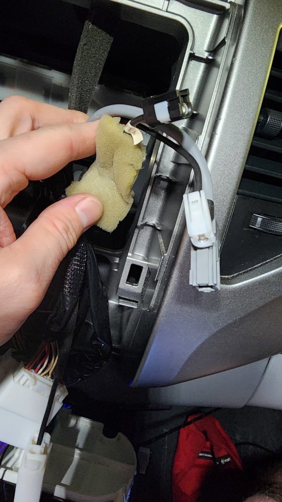

    Smills91
    Smills91 Well-Known Member
    Jun 14, 2015
    #157392
    201
    I'm assuming one is for the siriusxm antenna. Not sure what the other two are for.
    I'm having trouble getting the back up camera to show up as well. I have the yellow connectors connected. Tried each combination I could come up with but no dice.
    EDIT: The more I think about this, the more i believe those last two cables are 1) the Sirius XM antenna like I previously mentioned, but the other is probably the GPS cable. Since there is a new one that comes with the Joying it is probably be what it is.
    Can anyone confirm my suspicions that knows?
