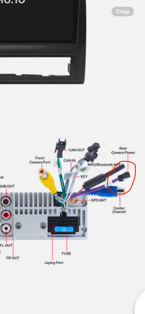

    Hello, after reading about 50 pages I couldn’t find an answer. I have an 05 trdof with JBL so it dosent have a factory rev camera . Was wondering if I could get an aftermarket rev cam for this unit? Probably would need some sort of harness? Thanks.

    yes, you will need a camera and harness to run between the camera and head unit
    also a handle form later model that did have a camera or a Pop-N-Lock handle that takes a camera

    did you end up finding something that worked with the tailgate handle? Any extra harness needed?
    https://a.co/d/64kaybe
    thinking maybe this would work(above link).Seems like plugging that rca could work with the joying unit and then just wiring ground and reverse in the back
    https://www.amazon.com/dp/B0CBX39S8M
    If you look at the camera joying sells(above link), if dosent even have a wire to connect to the purple one on the unit(shown below).
