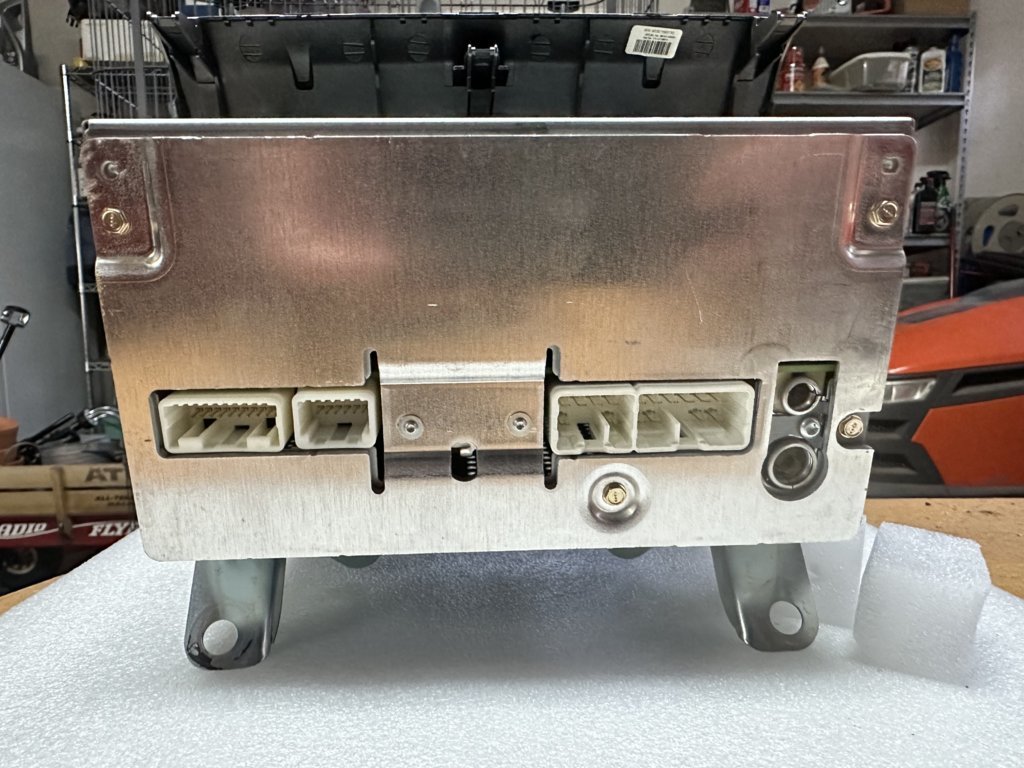

    I hope someone can point out my mistake so I don’t have to read the full 85 pages of this thread… I’m in a 2009 Tacoma SR5 with the non JBL system (Joying A model of the 9” unit) and my steering wheel controls aren’t working. I just received and installed my head unit, but the harness only attached 3 of the 4 cables that were connected to the factory unit.
    The fourth is the second from the left I this pic:
    Joying said this is connector is not needed for the install. I assumed this was the reason the steering wheel controls weren’t working, but not according to Joying.
    Am I doing something wrong, or is Joying mistaken? Thanks for any help in advance!
    UPDATE: After working with Joying I was able to get everything working. The only remaining issue is the noise floor. Anyone else have that problem? Factory speakers still… for the moment.
