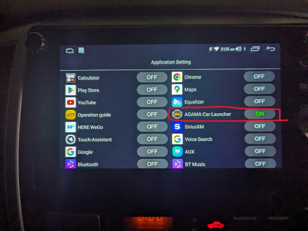

    @TXTaco211 This may help.
    Here is what I did to have my AGAMA Car Launcher start up first. Go to settings - then USER and select Application Settings. On my unit, it wiil show all the apps that are on the head unit. I selected ON for my AGAMA app. This eleminates the bootup and opens up the app I selected.
    If you have downloaded I Heart and Pandora onto the Joying head unit, they should be listed. If so, this should work. If they're not listed most likely this will not solve your issue.

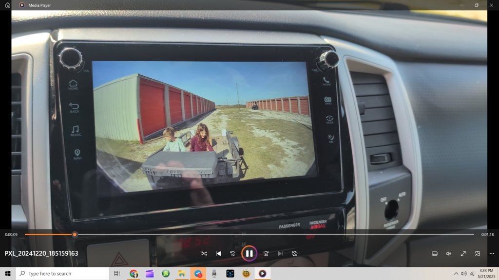

    Do Joying Headunits have the anytime backup camera feature?
  7. May 21, 2025 at 1:35 PM
    #1707
    BlkDakDave
    BlkDakDave Well-Known Member
    Oct 20, 2012
    #89422
    1,120
    David
    CC TX
    07 AC PreRunner TRD/Off Road
    I wired mine to a toggle switch. Flip the switch and the image comes up on the screen. I've had my Joying going on 4 years now, so the newer units may have this feature.

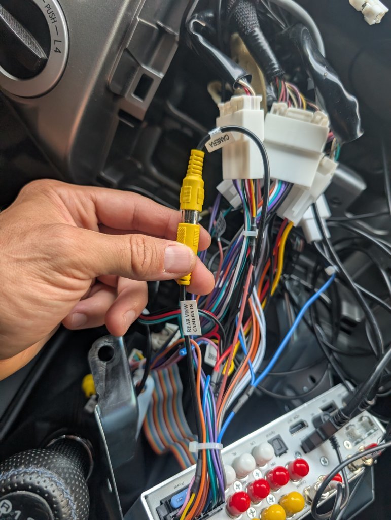

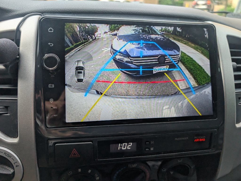

    Hi All,
    Been searching this thread for a solution - but haven't seen anything yet. Have a 2014 Tacoma TRD 6 speed manual. Installed the new 9" Joying and everything works awesome except backup camera.
    When I go into reverse, Joying switches to backup camera, but the screen remains black and says "no signal." The OEM camera view never shows up. Does anyone have a photo of how they connected the harness for the OEM backup camera? Did you need to do any modifications? Anything different needed for a manual transmission? I've been corresponding with Joying, but haven't gotten an answer yet. I did check the software configuration and ensure I have the correct camera feed settings (CVBS N).
    Thanks in advance!
  12. Jun 10, 2025 at 4:30 PM
    #1712
    koppertop9
    koppertop9 New Member
    Jun 10, 2025
    #472564
    4
    2014 Tacoma TRD 6speed manual
    I figured it out. I had missed that I needed to connect the video female from the CANBUS box to the male port from the 24 pin connector. Somehow I thought I had to go to video in on the back of the radio
    Once I made the connection, works perfectly with the OEM backup camera. Really loving the new 9" Joying unit.
