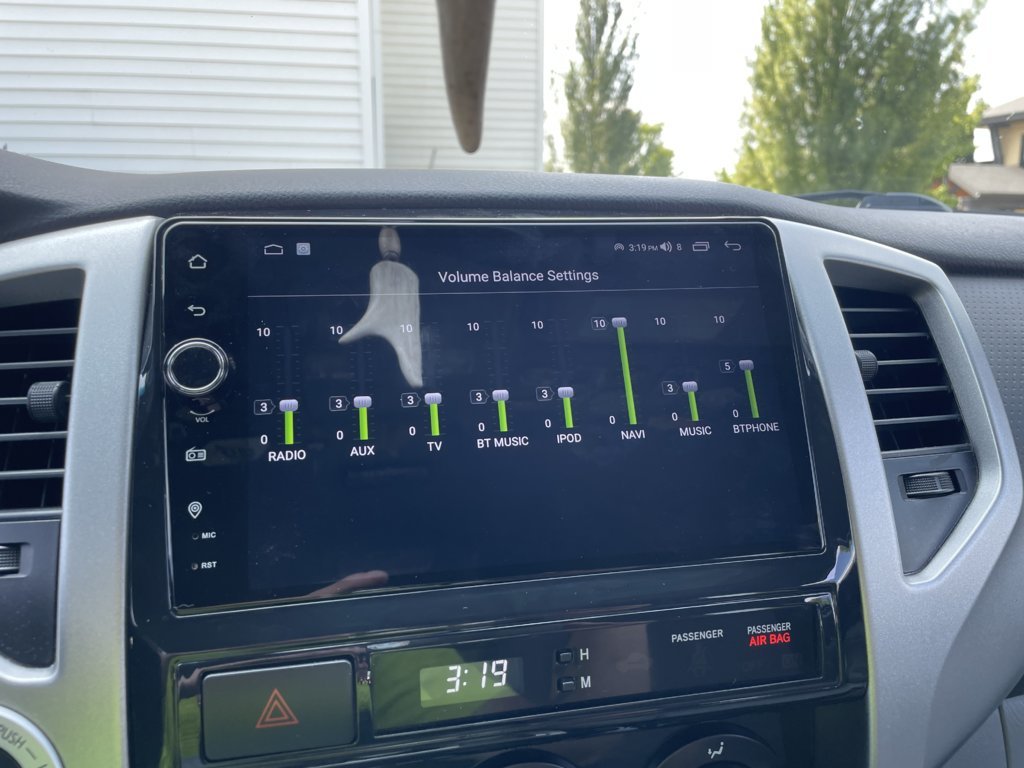

    Can you share a pic of your volume settings? Where I have mine is better than how it came but still less than ideal. The tags under volume balance are pretty nonsensical to me. Thanks.

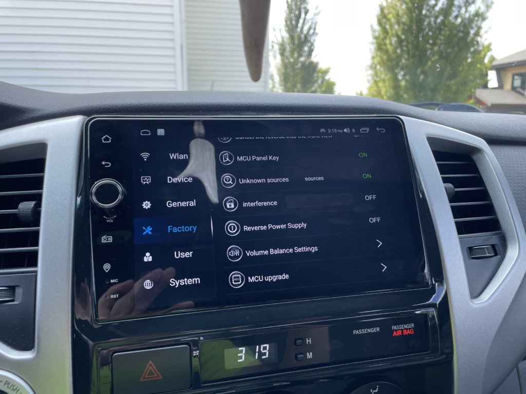

    So this is what I got so far.
    Go to settings.
    F*ck. Give me a second to fix this lol.
    Edit coming.
    Factory > Volume balance settings
    I have the nav slider set to max. This works in CarPlay.

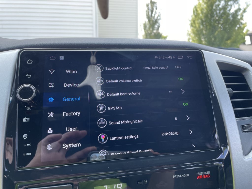

    Settings < general < sound mix scale < 5.
    This is the background sound volume that will be played over by notifications.
    Check your phone settings and make sure sound check isn’t on. If on iPhone it’s in music settings. If on android I don’t have a clue.
    This is what I got going on so far. I’m still going to tear into this more. Next step for me is developer mode or whatever it’s called and tear into coding. I love messing with shit.
