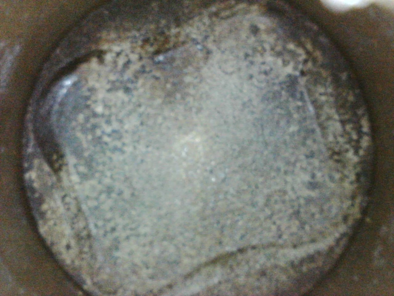

    Amsoil makes a powerfoam spray that does wonders on carbon buildup. May be worth pulling all the spark plugs and spray some foam down each cylinder. Find a vacuum port near the throttle body and spray some foam in there while the engine is running.
    My 15 hasn’t had any issues yet on 87. I run Amsoil Pi every oil change since 30K when I bought the truck, 80K currently.

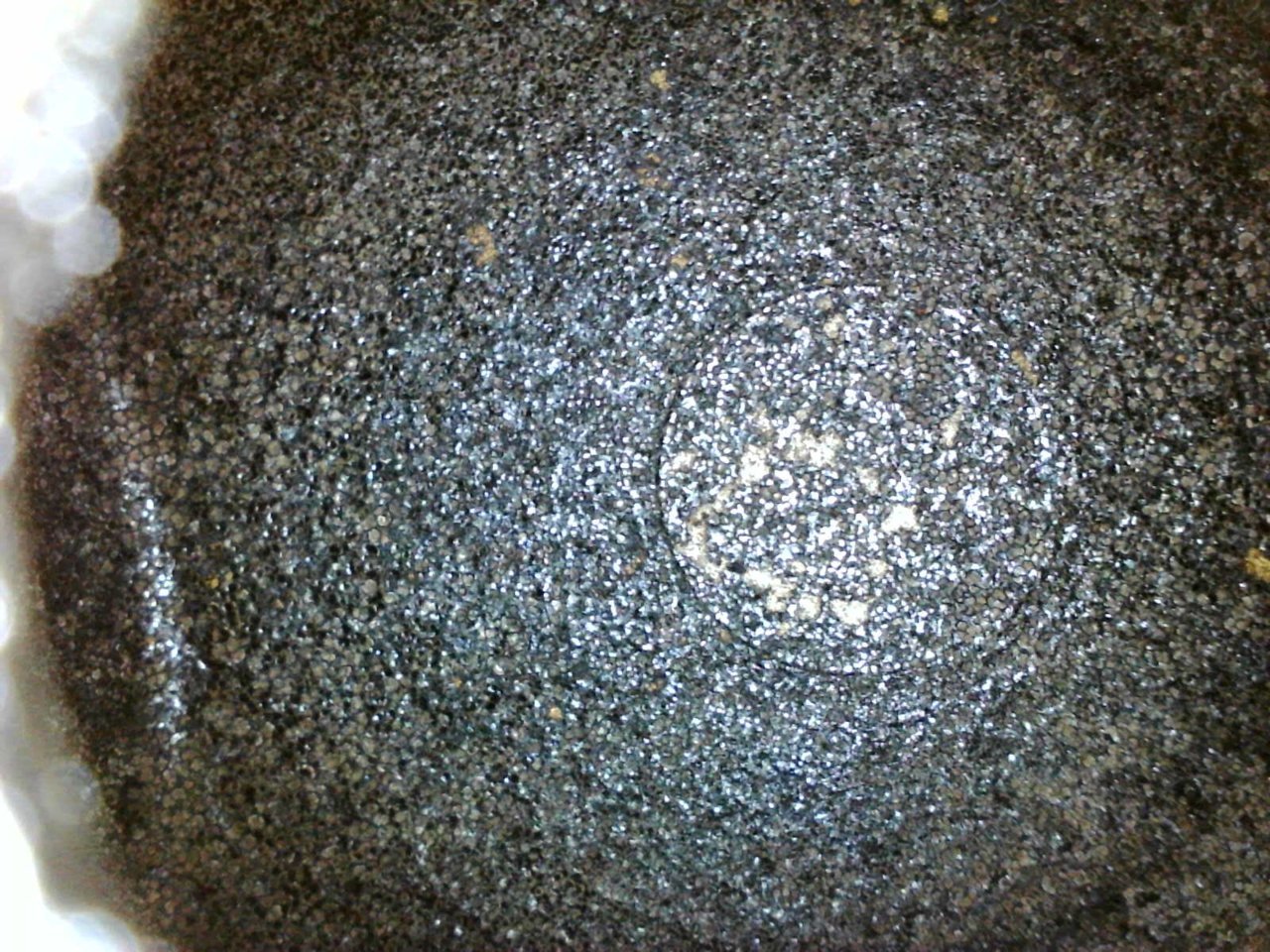

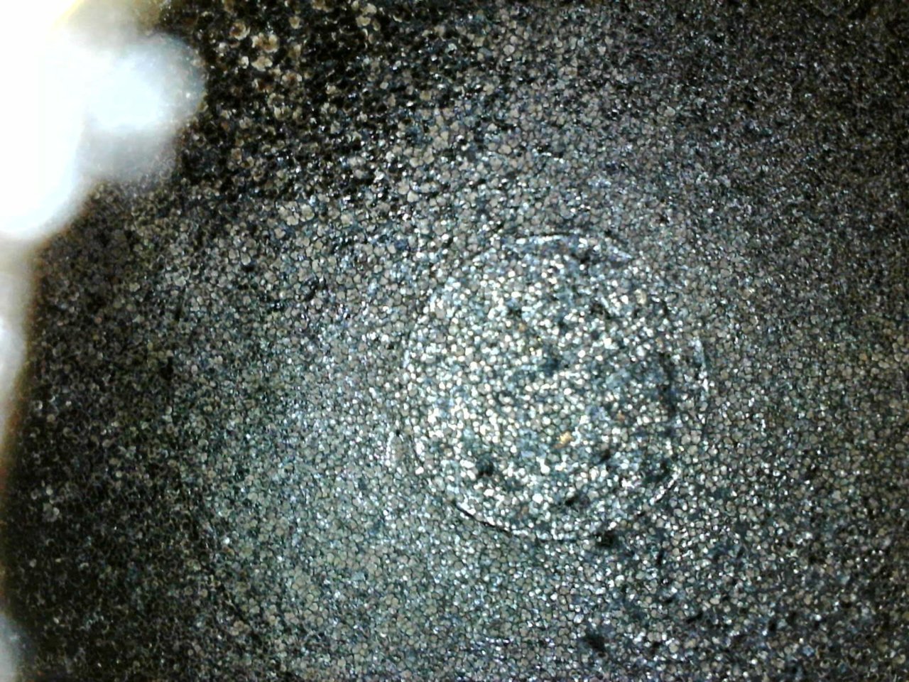

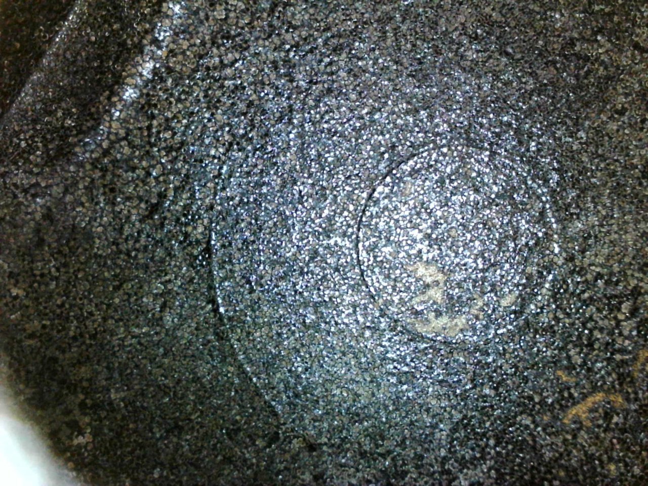

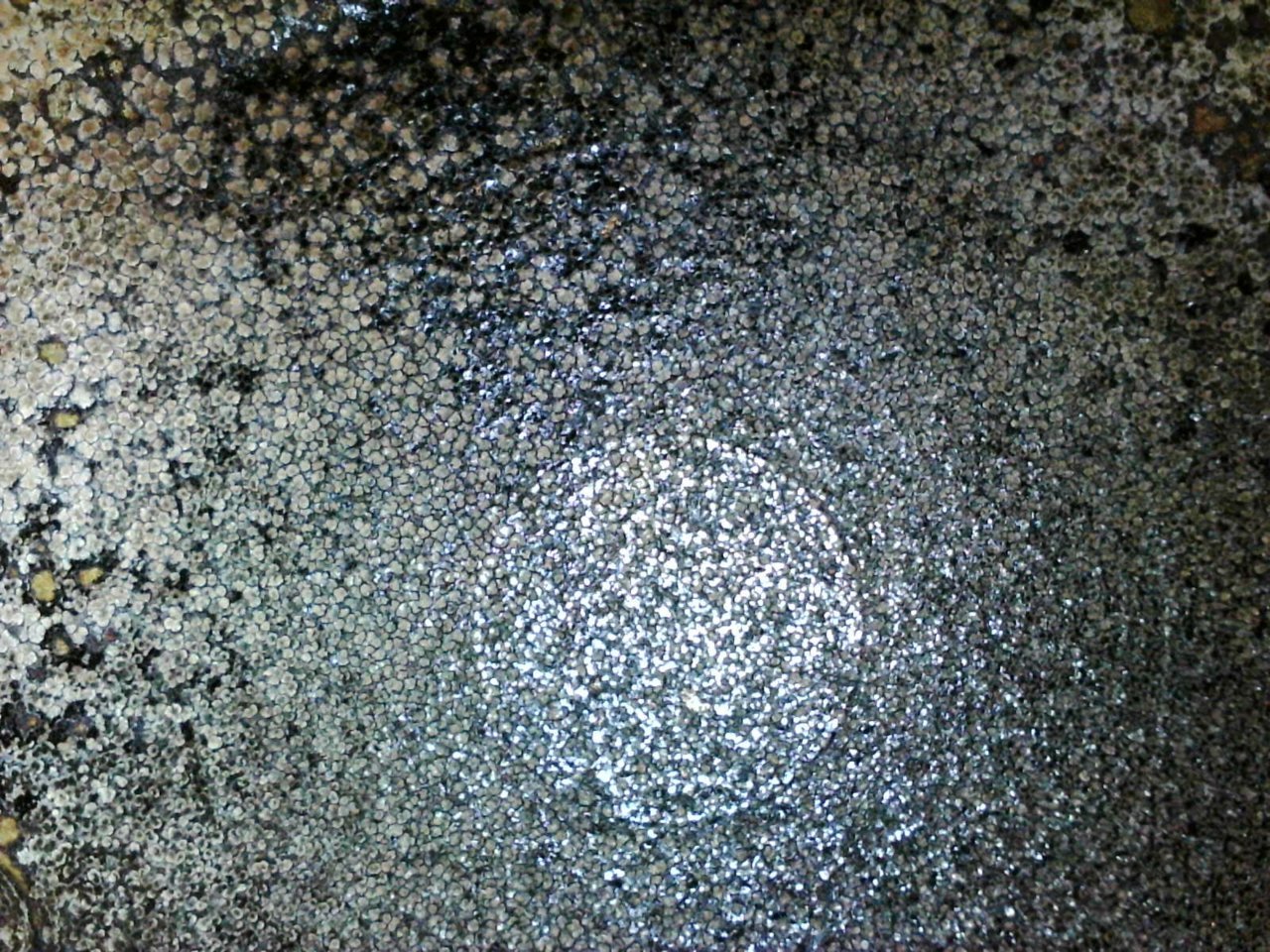

    2A600E15-D284-4B30-AEA8-521AF9DA82E9.jpg B68E0BEA-60A4-4739-B9B9-4DEF04469313.jpg 9D38EE93-91D2-4902-B9DE-EE98A7357A15.jpg A3066AEA-9B24-4646-99FA-76FB338A34F2.jpg 9A67F581-7740-4B4E-82E4-60BD001A6703.jpg 4C7D0F6E-3A92-415A-B236-197A01A69F25.jpg
    These were taken when I did the spark plug change at 60K. Not bad but not great
