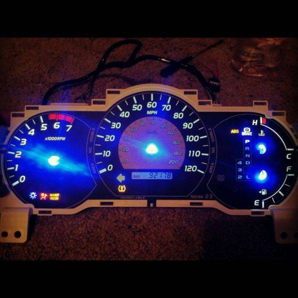

    Excuse my language but I am FUCKED. Last night I attempted this. I've got the rpm needle and background done, as well as the speed background. I've soldiered all the other LEDs and they won't light up! Not to mention I broke two of my needles last night. Could someone please help me out?!
  8. Oct 1, 2012 at 9:48 AM
    #1168
    Blackshirts
    Blackshirts Well-Known Member
    Feb 24, 2010
    #32057
    4,289
    TX
    09 PreRunner-Totaled. 2016 SR5 Blue DC
    Stuff
    You not fucked... Okay sounds like you have a bad solder. On the rpm if one solder on the background is bad then those three will not work. It's a circuit. Same with the needles. Did you use a soldering sucker to remove the old solder?
    Now how did you break the needles? Do you mean they won't line up right anymore.

    Estock
    did you place the leds the right way??
    they have a + (pos) - (neg) polarities that need to be correctly soldering in
    the last cluster i fixed, the member had alot of his leds backwards which caused it not to work
    and i didnt find the link for the needles :( sorry..
