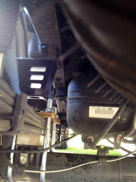

    Remember that an AAL will sag over time depending how often you carry loads or not. Many have done the 3 leaf AAL.. those who do it right go full Dakar (j/k for all you non-Dakar guys...lol)
    Seach the oahu thread.. Kaleo has an AAL and/or block, recently installed extended 5100s, and did big ass bumpstops...

    Yeah its a 1.5" aal an a 1" block. I only got the 4.5" energy bumps to be on da safe side but the actually do help. Ill probly buy wheelers superbumps down da road, after i get da AP expo leaf pack.
