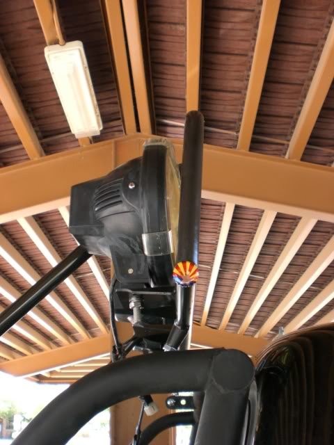

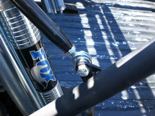

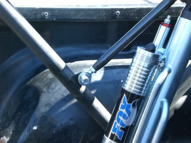

    all of my heims and bungs were $70 for the 6 of them. I'm stoke to see how it turns out let me know if you need any detailed pictures of mine to help you.

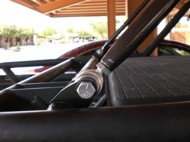

    alex, on the rod ends, does it only use a heim, or is there also a tube adapter that the heim screws into?

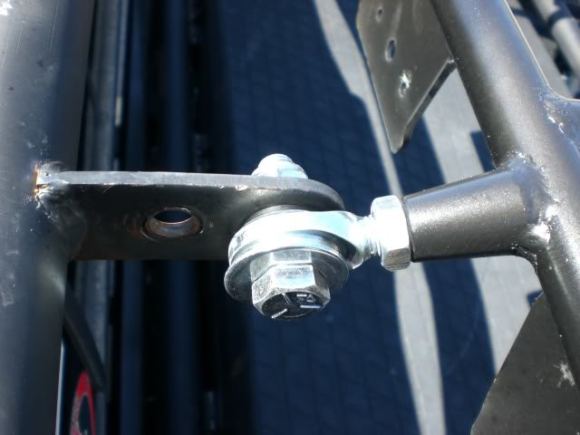

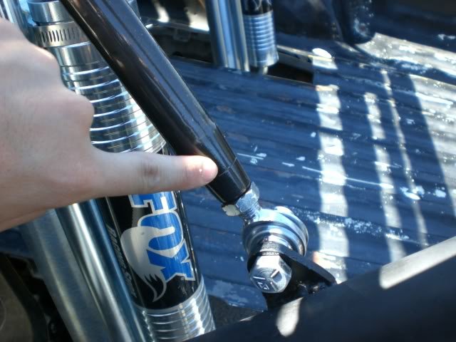

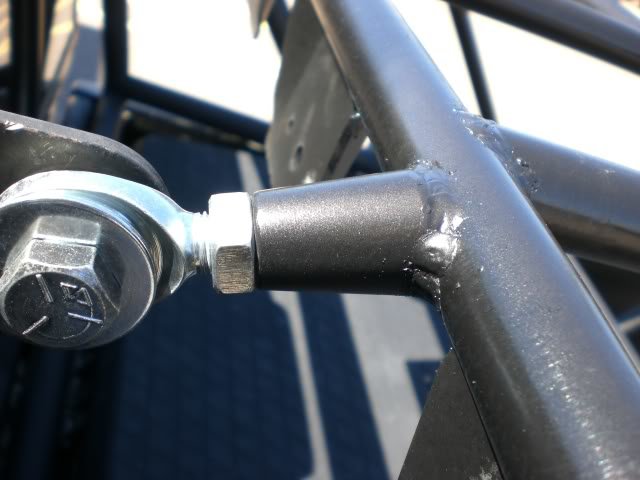

    there is a threaded bung that is welded into the tube. one has to be a right handed thread and the other end has to be a left handed thread so when you twist the support everything moves together.

    can you send me a picture of that part. i'm not able to visualize it

    Yeah I can but you can see the bung because its welded then smoothed out but I'll do my best to show you.

    yah, just where it's mounted on the rack will help a lot

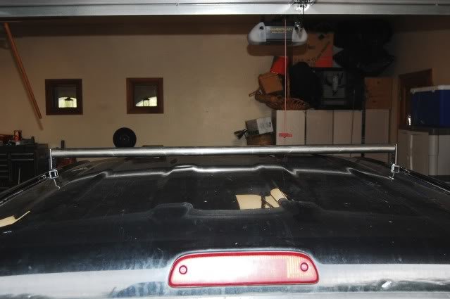

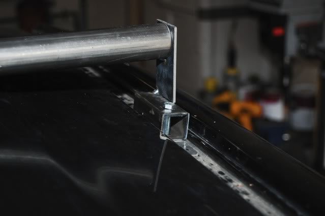

    made some solid progress today.
    actually I only got one thing done, but it was very important. I made a template for the bolt holes in the roof. Then i used that to drill holes in a 1" square tube that will hold the rack to the roof.
    I'm actually debating if i should make the rack fold down now.....i don't think it will be able to fold down far enough to actually do anything. I'm worried that the rack won't be high enough over the roof to actually let the lights fold down flat. There is no point if i can only fold it back 45*
    if i can't fold it down then i'm ganna make it quick release system.

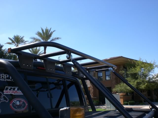

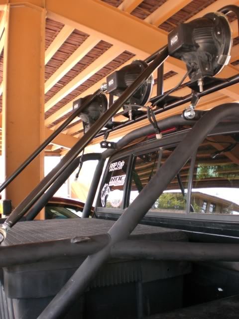

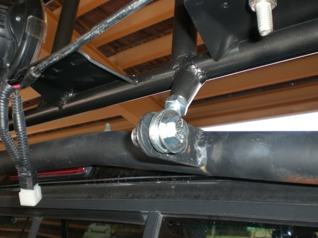

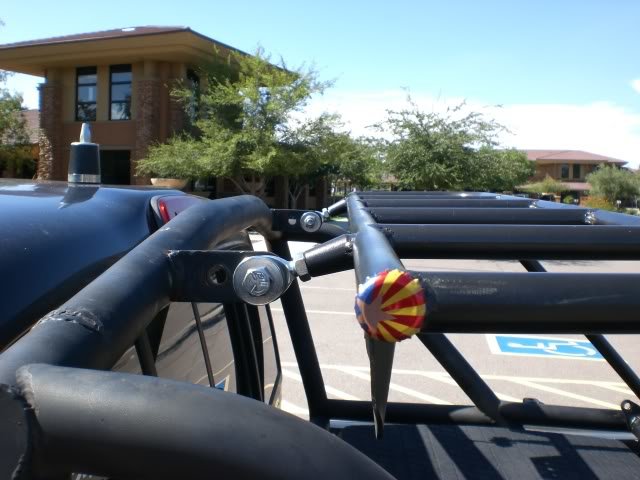

    I'm uploading pictures now Matt of mine. i don't have the tools with me to take one of the supports off to show you the thread inside. But basically its a threaded bung that is welded to the end of a piece of tube. We got all of the Heims from Foddrill Motorsports here in phoenix. ITs there 1/2" light bar heims. and there are about $10 each for the treaded heim, jam nut, and threaded bung. you will need 6 of them total.

    awesome thanks for the photos.

    got something actually put together.
    once i weld everything up i'll also make some gussets and round off the corners. mainly just to make it look better.
    also picked up some inner diameter tube clamps from ballistic, they're sweet. they're like 33$ each for a 1" inner and 1.25" outer diameter tube. but they'll make the quick disconnect system pretty sweet :cool:
