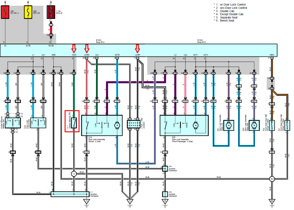

    There is also a lock confirmation switch that signals a successful lock. If commanded to lock and it doesn't make the switch the door will unlock.
    Here is the switch inside the lock actuator, circled in red.

    See post # 7 with a picture of the feedback switch.
    It could also be a failing Body Control ECU ( part of the internal fuse panel. ).
    Body ECU on the backside of fuse panel to the left of the steering wheel.
