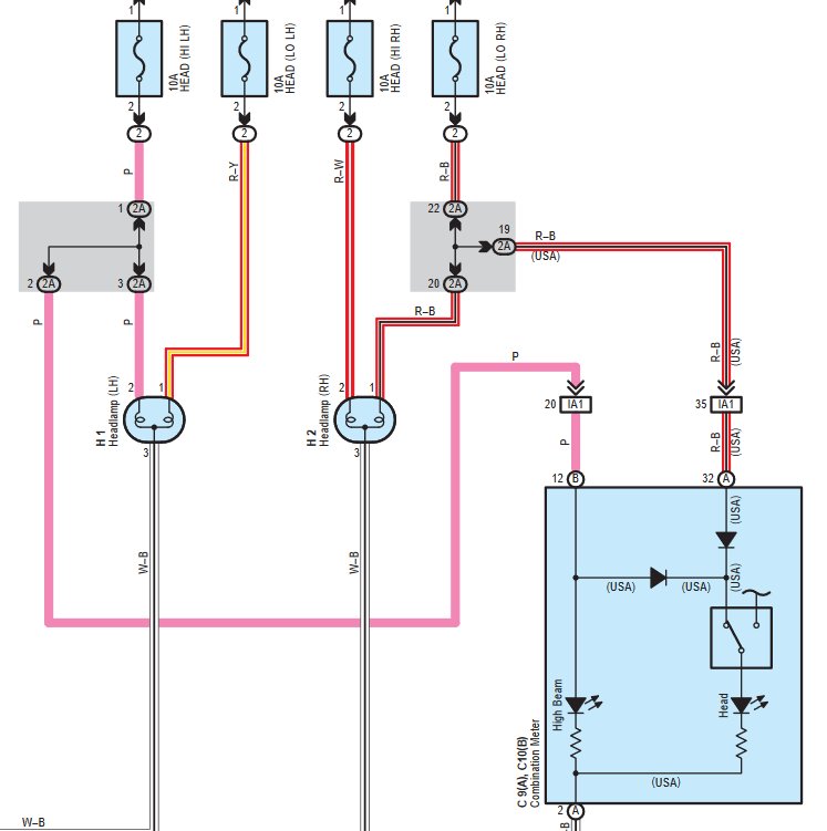

    No, the indicators do not go through any filaments. The headlight indicators come from the High and Low beam circuits, but tap off before the headlights themselves. See circuit below.

    I’m going with bulbs or wiring.
    If the indicator works on the dash in BOTH Hi and Lo.
    The fuses are powered by the dimmer relay.
    And the indicators are powered by the fuses.

    Thanks. Where do you find these schematics? The one that came across on a different thread did not show this.

    They are from the Toyota Factory Service Manual.

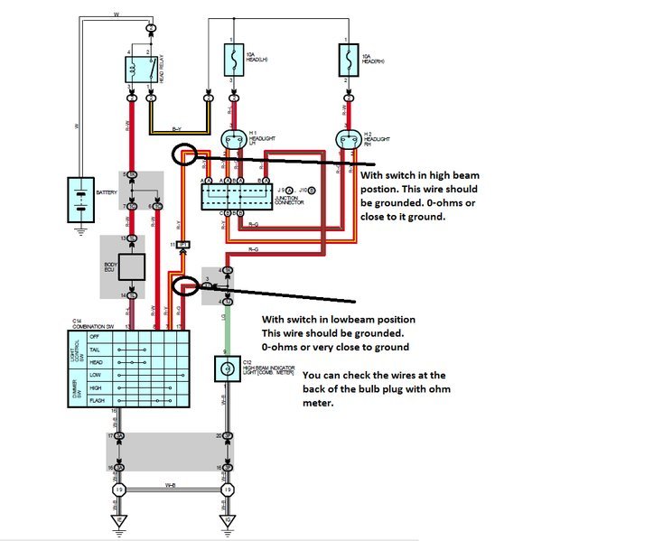

    That other image was Edited, adjusted, reconfigured for clarity to demonstrate something for someone else.
