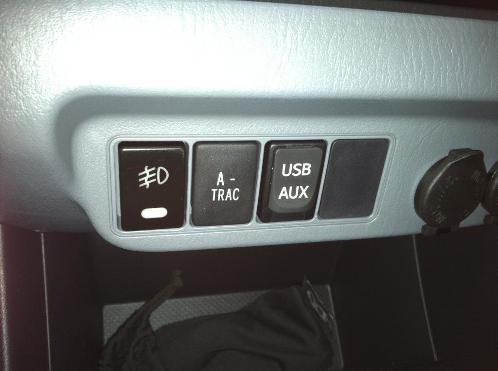

    Hey Guys,
    I changed my lower console on my prerunner a few months ago. Mine only had the two cig lighter plugs and changed it to the 2.5 version with the small switch blanks.
    My question is since my lower console didn't come with the USB/radio plug switch or A-Trac switch (not sure what this does either). Would those wires be tucked back there?
    I'll be adding a rear locker to my prerunner soon and was hoping to run the illumination switch harness by RedsideElectric from Tacomabeast to piggyback off one of those switches instead of splicing up my wiring.
    (Pulled the pic from internet for reference on the switches)

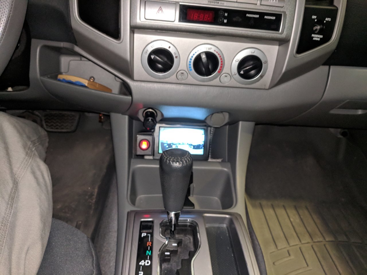

    I have an '07 Prerunner with (or should say HAD) with the stock 6 disc radio. There was no USB plug or even an aux plug with that unit. I did add an aux plug later, but have since changed out the stock head unit for a new aftermarket one. Picture for reference.

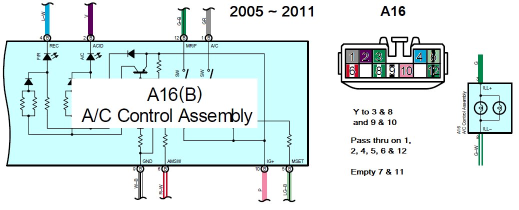

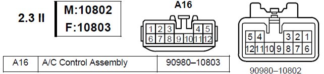

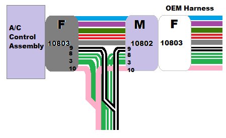

    OP, you can purchase the mating connectors and assemble a Y harness (so you don't go cutting/splicing any OEM wires)
    3 & 8 on A16 is switch illumination
    9 & 10 is Fused Ignition & Ground

    nice, do you happen to know the 2.5 gen connectors? I want to redo mine with a Y/adapter.
