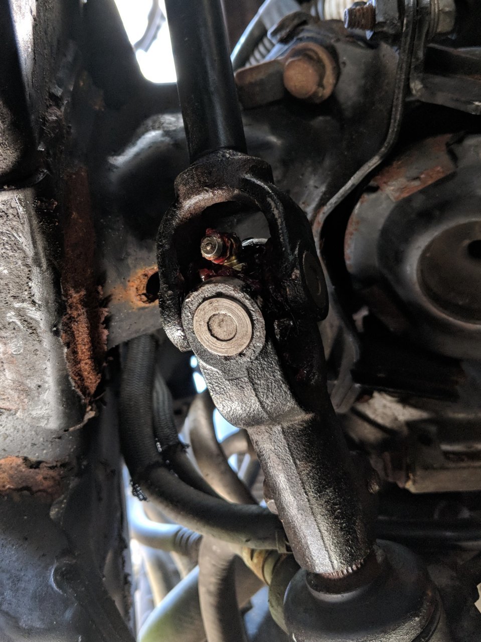

    No through holes for adding a grease zerk to the factory U-Joint.
    Loosening the shaft again to correct my misalignment on the splined shaft on rack turned out to be easy since I had it off just yesterday.
    Hears a photo of it installed

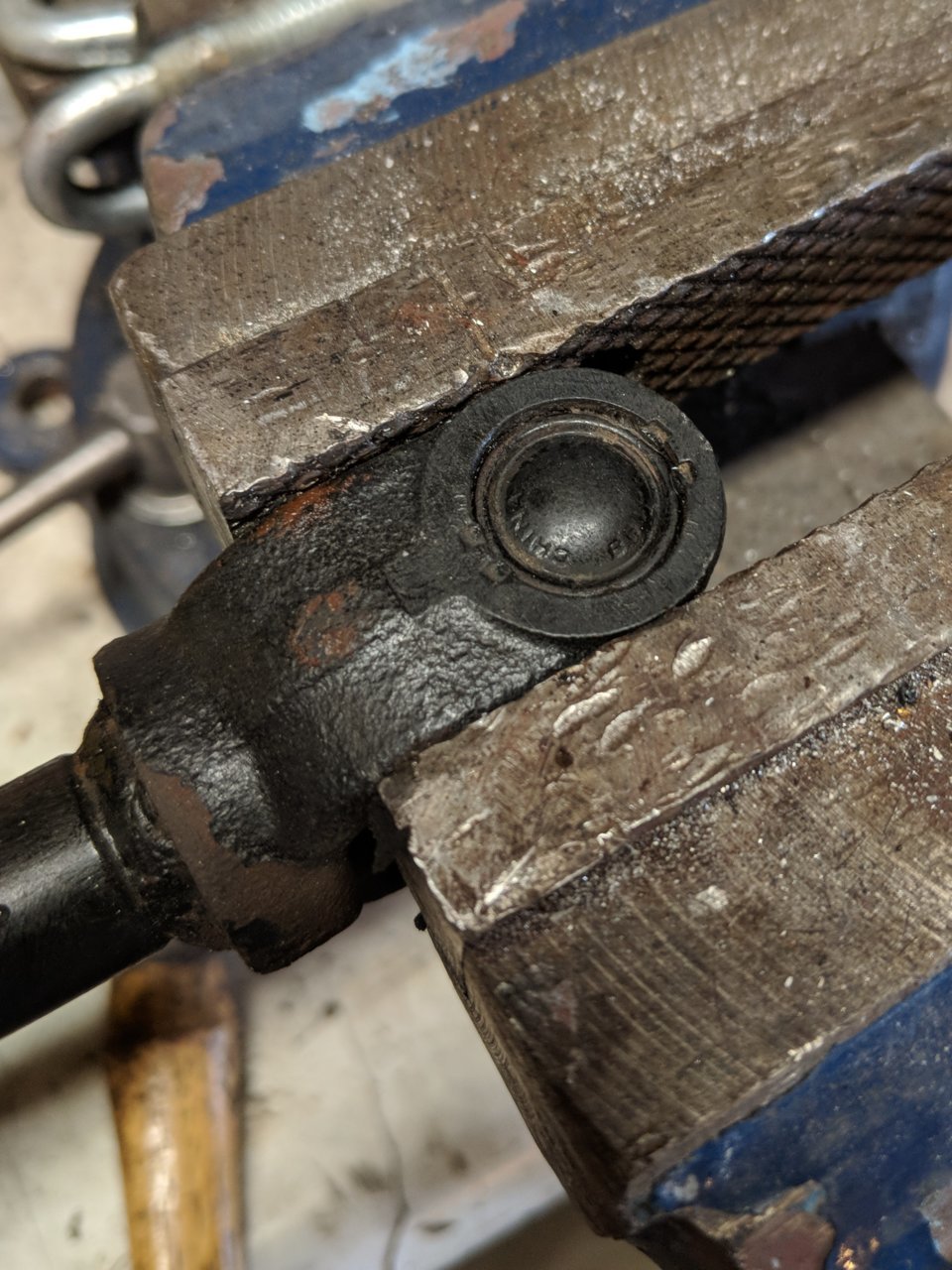

    POS OEM Chinese part :annoyed:

    IMG_20180412_170846.jpg The U-Joint on mine was stamped CHINA
